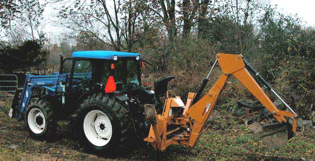

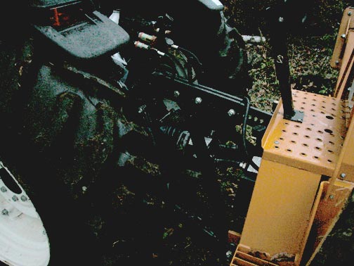

The 1050 is an older design. It works just fine inmy opinion. I've had 4 hoes and it is by far the best. Bradco also makes a good hoe for the TN.
Here is a picture of the 1050. I paid $9500 in 2002 with 2 buckets and a pto pump. Second picture shows mounting details.
Andy

I'm not quesing that the BH90 is a good hoe. I have both a TN and a 2120 (shares frame is is exactly same size as TC55). I ran a subframe backhoe on teh 2120 for about 16 years. The 2120 is no where near the size of the TN and the TN's 3 pt hitch mount combined with the very thick rigid 3 pt hitch of the 1050 makes an excellent mount without sacrificing the ground clearance that the permanently mounted subframe mounts take up on the TN's. BTW I would not run a non subframe on a TC55 or anything smaller. LarryRB has used hoes for eyars and has seen my 1050 many times. Perhaps he'll offer his opinion.
