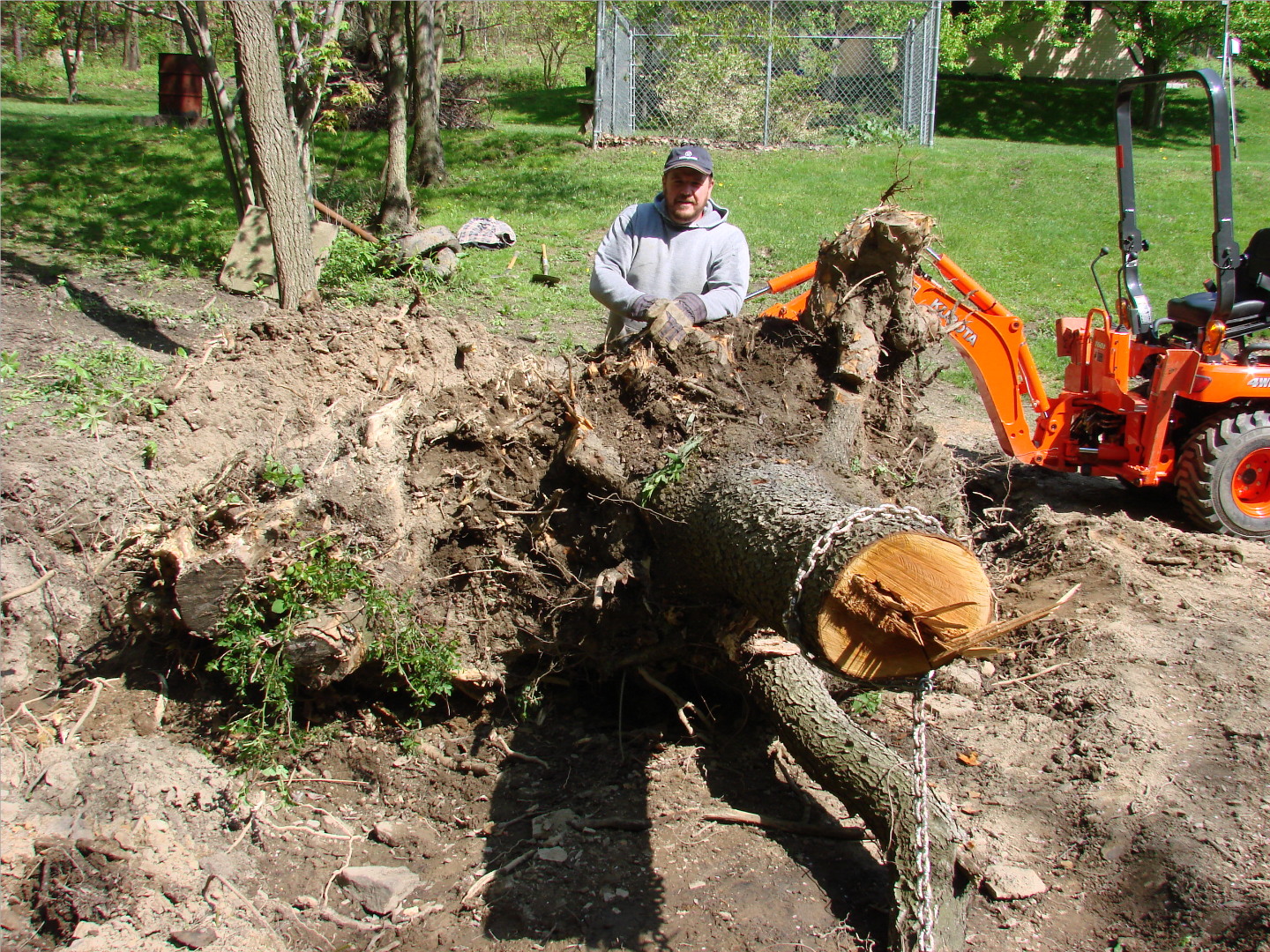

A Cherry Stump and a Tree of Heaven Stump joined together that a small BX24 took out this year........
Trust me, you were not just grabbing this with the hoe and yanking! After I was done the hole was at least 4 feet deep in some areas around the base.
Had a darn good time too!
