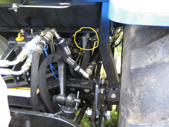

We originally had just a 16LA and the Woods BH90-X on our TC40DA and then added a rear remote for a grapple addition to the 16LA. Our BH90-X was originally installed without the QD hose kit. When disconnecting the BH we had one short hyd line from the BH to remove at the cover plate where your remote valve will be added and the longer hose disconnected farther forward under the right side of the tractor. Once the longer BH hose was disconnected, the tractor side of that connection had to be reconnected to the tractor to complete the "closed loop" hyd flow.
When we added a remote valve we also needed to install a hose kit for the BH. That hose kit included a cover plate that had two hyd ports on the cover plate that allowed the BH to QD completely at the rear of the tractor, and allowed the previous "forward connection" to be permanently connected to the tractor.
This is probably confusing, initially (it was to me), and I needed to trace the lines for myself to understand it. The tractor's hyd flow completes it travel through the BH. The BH hose kit allowed me to simply remove the BH and plug the two QDs together to allow the tractor's hyd flow to be continuous.

Vic,
Check out the photos on this thread:
http://www.tractorbynet.com/forums/attachments/97414-woods-bh90-x-hyd-thumb.html
highlighted is the correct cover plate outside the rear remote. This cover plate allows the BH pressure and return lines to connect directly to the tractor and not interfere with either the rear remote or FEL.
