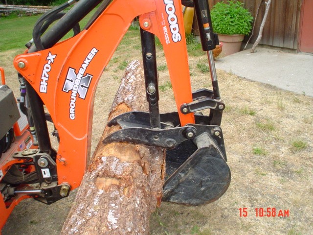

I just posted these pics a day ago on another post. I really like the thumb on the Woods backhoe model BH70-X, the thumb has seven positions. The local dealer (did not buy from him) was going to weld on a two position thumb on a Kioti backhoe. Got my unit out of the country, in Oregon, (I live in Canada) from Tony at Superior Tractor. The unit is just over a year old and have 129 hours on it.
