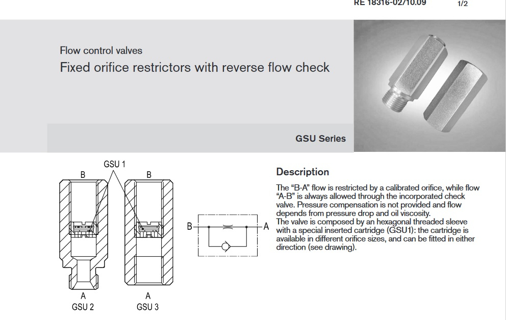

The next sophistication up is a fixed orifice in one direction and non restricted flow in the opposite direction.
