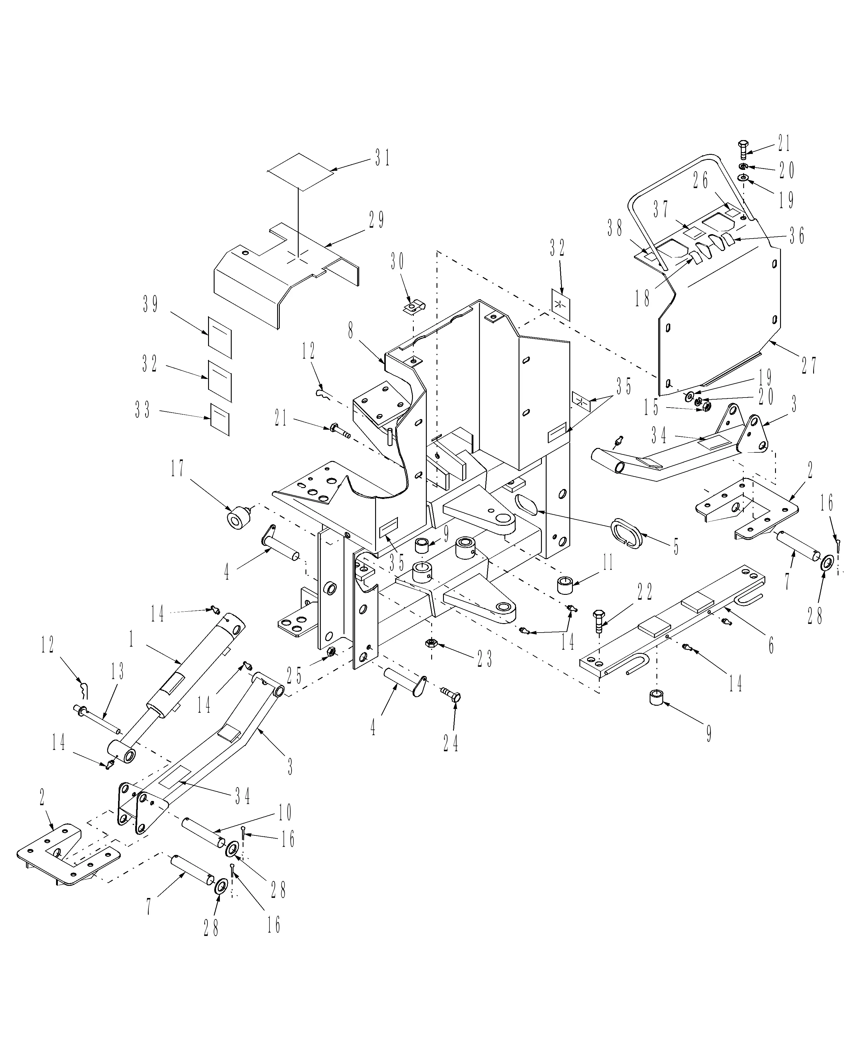

can anybody speak as to how to hook up the hydraulics for a tc-29d to the backhoe unit not having a rear auxilliary connection whithout going the pto seperate pump system which costs 2K i believe. Is there a diverer or splitter in the hose kits? sorry for the duplicate post, not sure how to delete it!
   / Woods BH75 backhoe/TC-29D questions-subframe #5
Basically you tie into the power beyond line from the loader valve. NH doesn’t offer a kit, but here is the breakdown. Of course the fittings can be aquired locally or Surplus Center.
