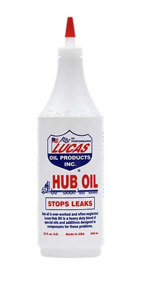

I would cut it enough to pump out with a drill pump then flush with diesel to finish.
Fill it with corn grease or Lucas
