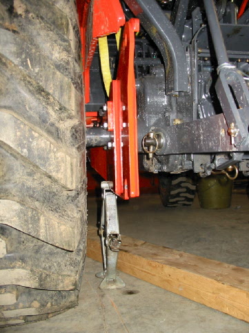

It's not difficult to install if you have a nice cement floor to work on and don't get in a hurry. Just read and re-read the instuctions( they're not the best but you can find them on the Woods website) so you know what you're going to do before you do it. The hose kit gives you enough hoses and connectors to tie into the existing hydraulics if you have a loader, but again you have to look at what they gave you and think about it a bit. The instructions tell you to remove the wheels to mount the subframe, but I was able to drop a sling down between the tire and seat and lift it into place with an engine hoist and then tweak the angle with a scissor jack to get the bolts in. No manual lifting as I was just home from a hernia operation when I did it.I was a little concerned about how to unload it when it was delivered, but he brought it on a car trailer and just backed it up to my garage and then I used the tractor to drag the skid it was mounted on down the ramps and on to some Princess Auto wheel dollies (3 of them). This way it can be wheeled out of the way to get the tractor back out of the garage. Here's a couple of pics of mounting the subframe. If you go this route just post any questions you have and I'll send you some more pics.

Thanks a bunch Fjord. My rear wheels are pretty darn heavy so taking them off is probably a pain :)
