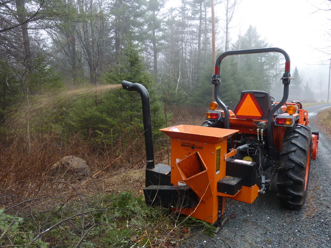

I have an older 5" BearCat 554 with a blower that I paid $1200 for used about 5 years ago. It has single edged blades. It was in good shape and has served me well. I bought a second blade set for $110. It is about $40 for me to get them sharpened at a machine shop.
Like Roy said the shaft set screws are frozen. I did not try very hard to free them because I can still change the belts and grease the bearings by sliding the pto drive shaft apart and then removing the bell shaped plastic guard ( forget proper name ) on the chipper end of the shaft. The metal belt cover can then be removed by removing the bolts and sliding it over the drive line. You may not be able to do this with the newer models - I don't know.
