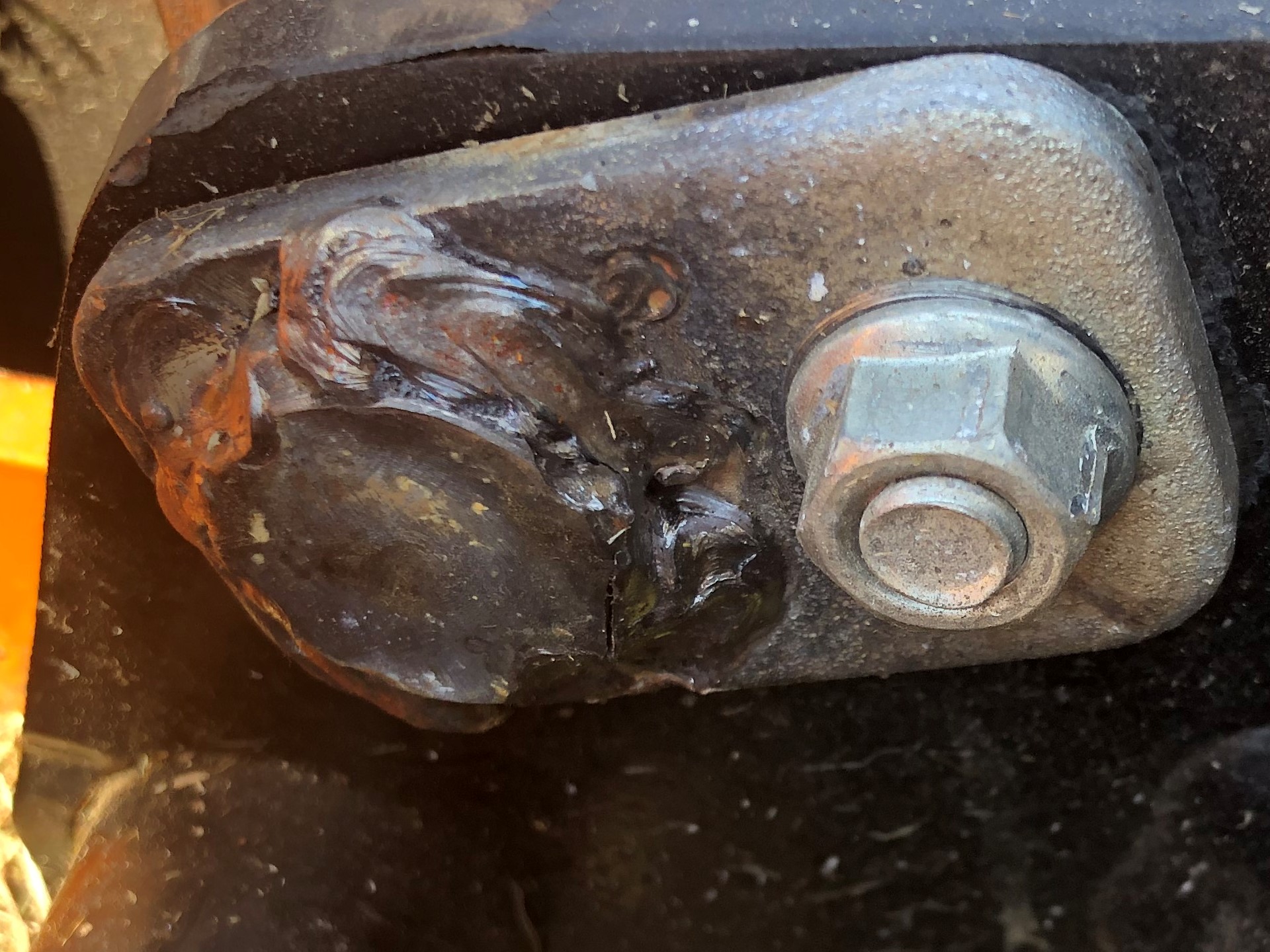

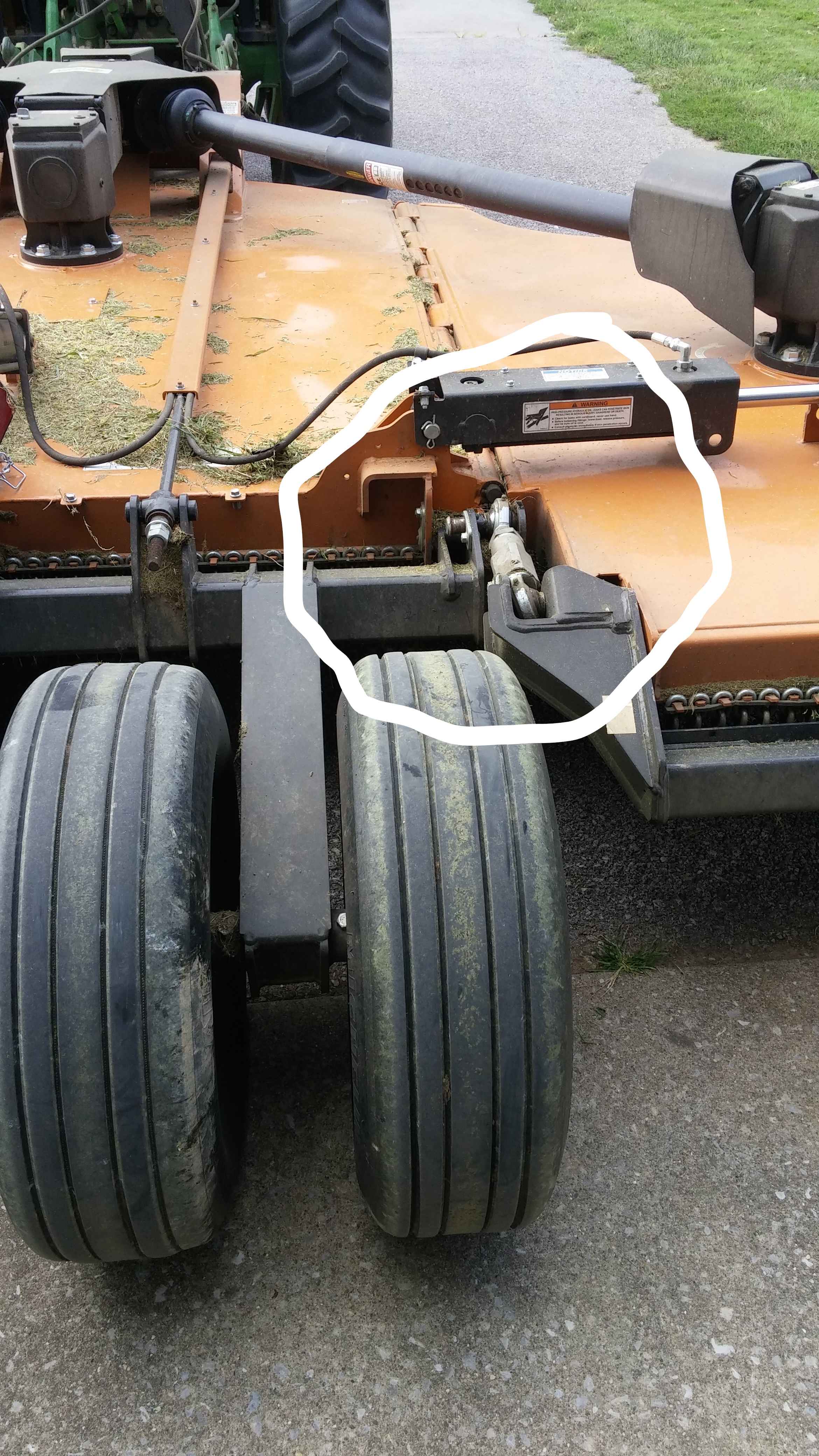

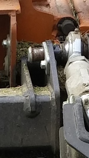

"Woods pin backed COMP.jpg" shows a broader view - see the circle. It also shows the pin actually backed out on the center yoke. Tough to see here, but what failed is the weld that holds the keeper on the pin. The pin backed out, tweaking the bushing. See "Woods pined backed ZOOM.jpg". "Woods link copy.jpg" is a close up of the link held by the pin look at the left of the link and you will see the yoke is tweaked, and maybe you can just see that the bushing is tweaked. The pin was welded back to the keeper before we realized the yoke was bent. "Woods Pin Copy.jpg" is our weld job to repair. I included it because it shows the keeper - the flat plate with the bolt though it.
This failure has only happened on one unit. The other failure is harder to photograph but works in a similar way, and happens on the joint between the wing and its yoke. On all 3 the bolt holding the keeper broke and allowed the pin to back out. The pin can not back all the way out so the pin and bushing get cocked - breaking the welds holding the bushing to the yoke then breaking the bushing.
So what I think is happening is that there is lots of torque being put on the pin by the link - like it grabs the pin because it is rusted inside. This torque breaks the keeper bolt or the weld on the pin/keeper joint. With nothing to keep the pin in place, it backs, then gets out of line and tweaks the bushing and yoke. We have kept the things greased - but remember, 2 of them probably have less than 10 hours on them (the dealer greased them and we greased them). The other one (that has now broken 2 yokes) maybe has 25 hours on it.

Larger bolt possible for the keeper? ?
The one pin looks like they only tack welded it to the keeper.
Is there room for a bolt & nut rather than the pin? Then weld a plate on the yoke to prevent the bolt from turning, maybe mill one flat of the bolt to the shank of the bolt for more area to engage the plate welded to the yoke?
