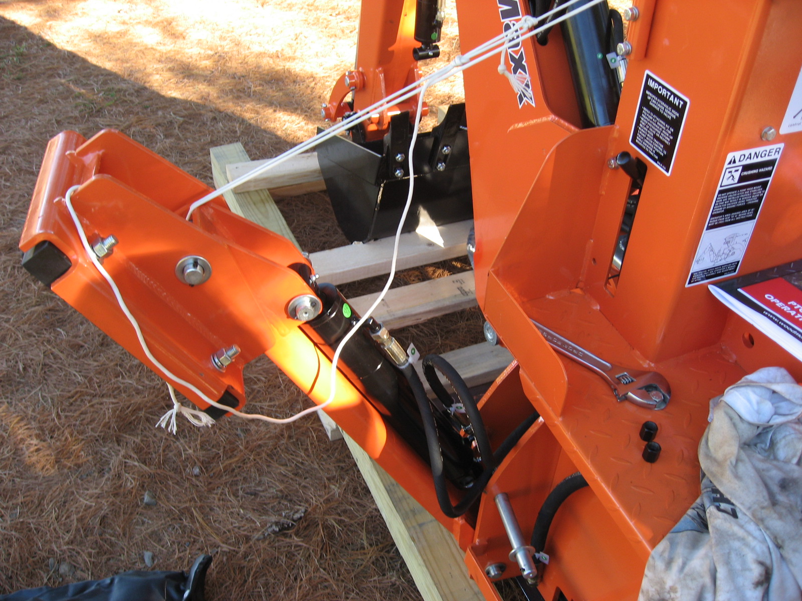

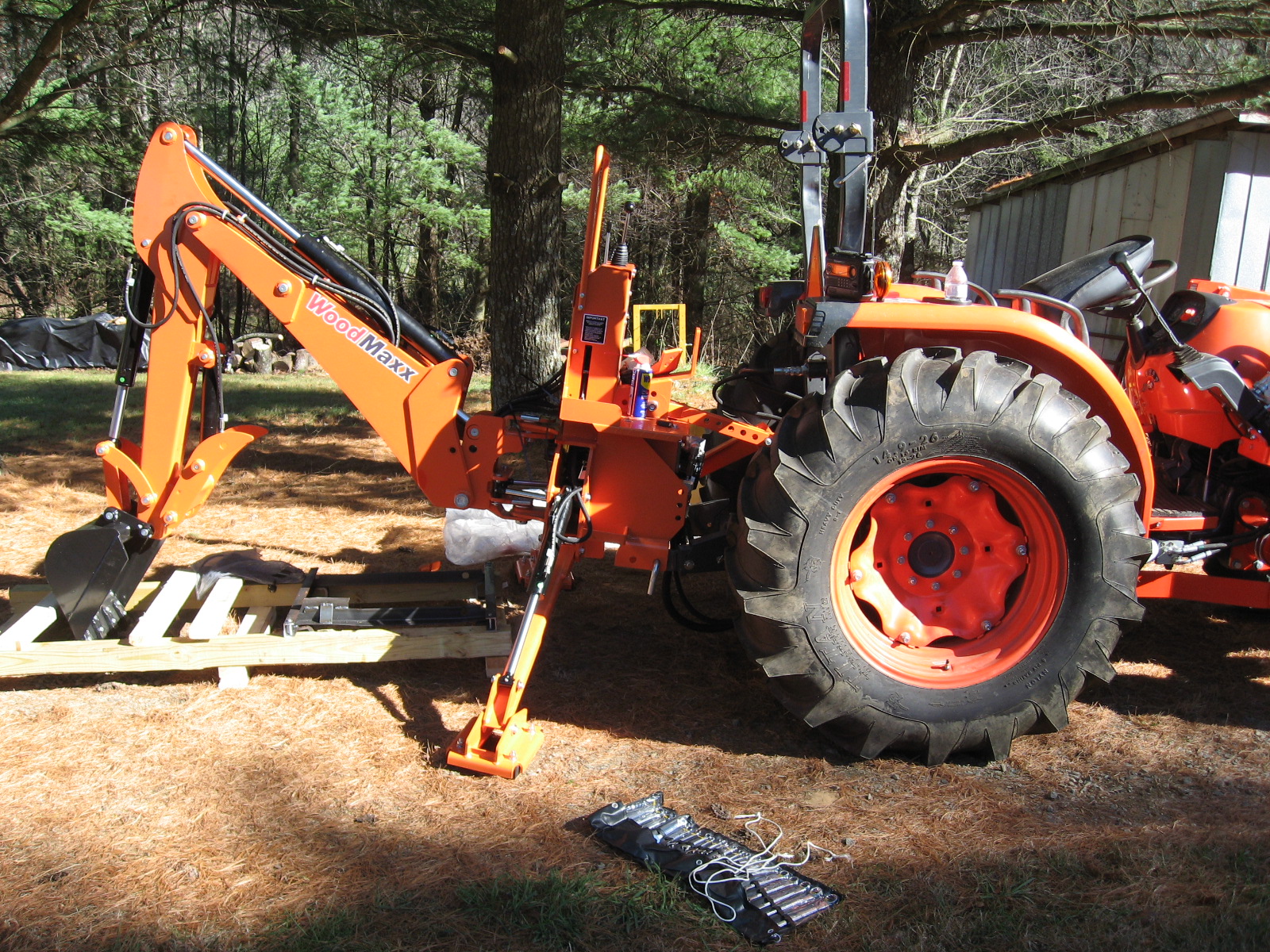

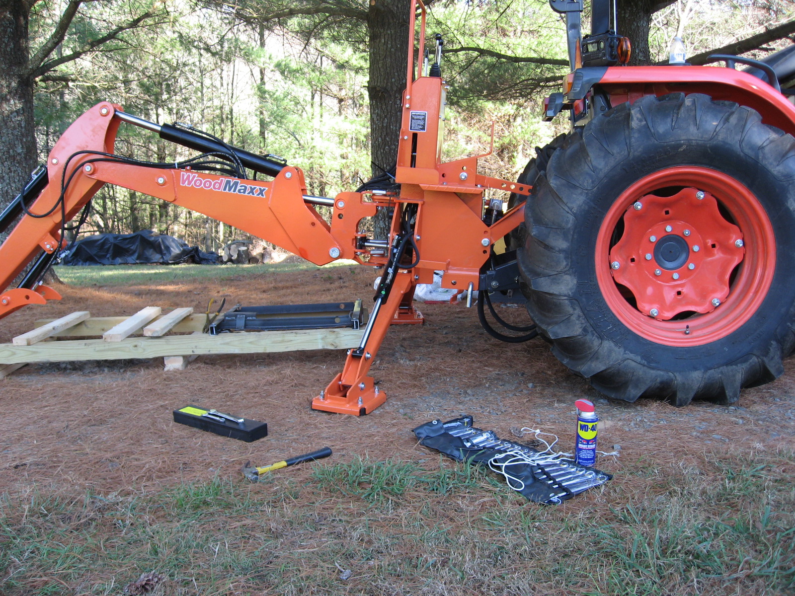

I recently purchased this backhoe and received it about 3 weeks ago. The price included free liftgate delivery to my home address and it was delivered quickly and in good shape. I ordered it with the optional hydraulic thumb. It was well packed on a pallet and wrapped in cellophane. All parts where there, but the assembly manual didn't include an inventory. I only knew all the nuts and bolts were there after assembly was complete.

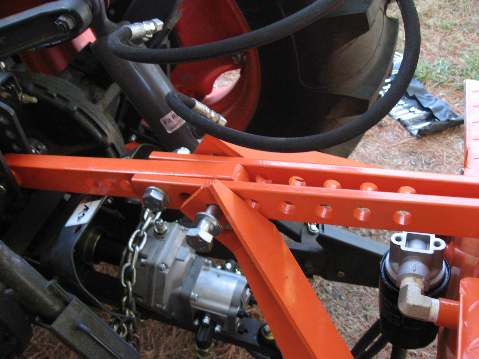

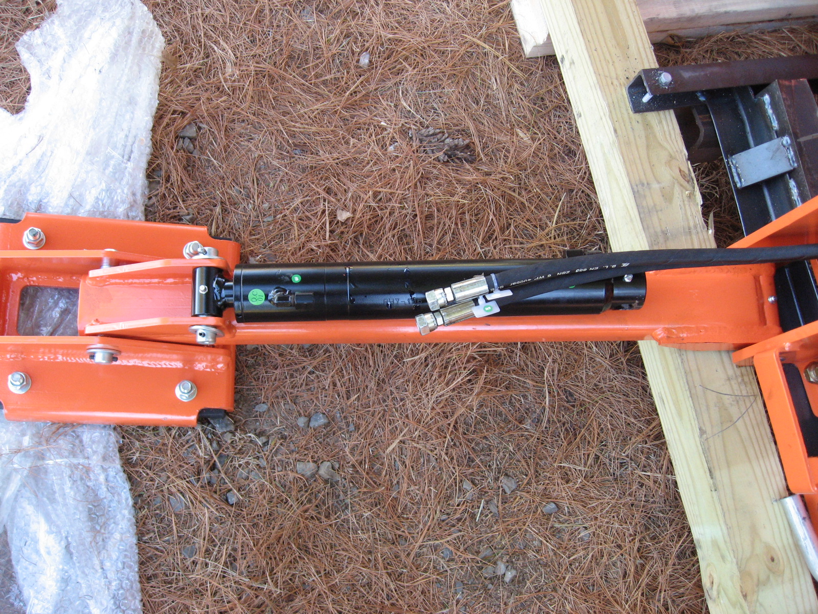

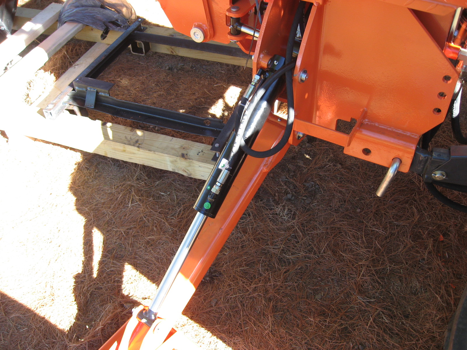

The first step is to attach both stabilizers. The bottom connections were straight forward, but hooking up the ends of the hydraulic cylinders was impossible without extending them slightly. I tried pulling on them with no hoses attached just to see if I could extend them even a 1/2, but they didn't budge. You have to hook up the hoses, fill the hydraulic tank and connect the PTO driven pump to get this accomplished.
I had to tie up the left side. These hydro hoses were the right length, but for some reason, the right side was about twice as long. They would be too long and get in the way. I just ended up stuffing the slack back up into the console.

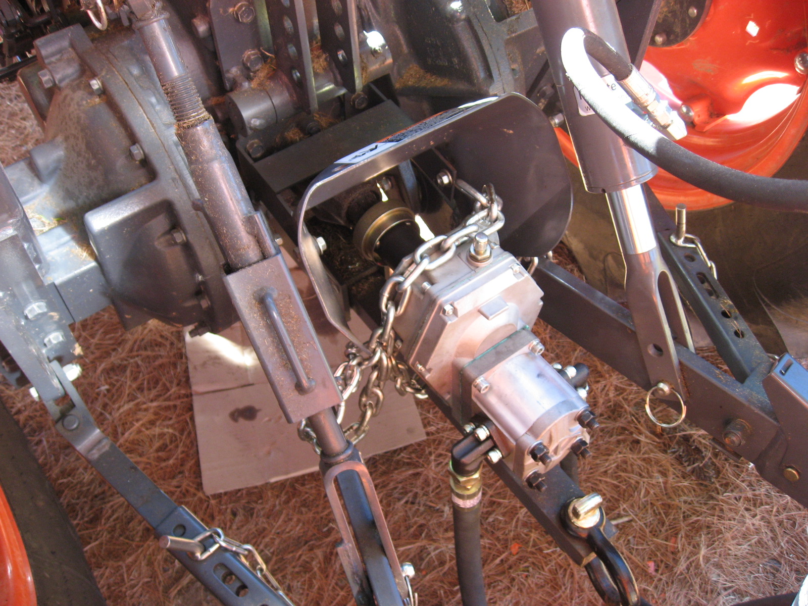

You must add 12 oz. of gear oil to the pump before attaching. With the PTO pump attached, I could finally raise the hoe to attach it to the tractor. It took a good 10 minutes with the tractor running at idle and refilling the hydro tank to get things working fully.

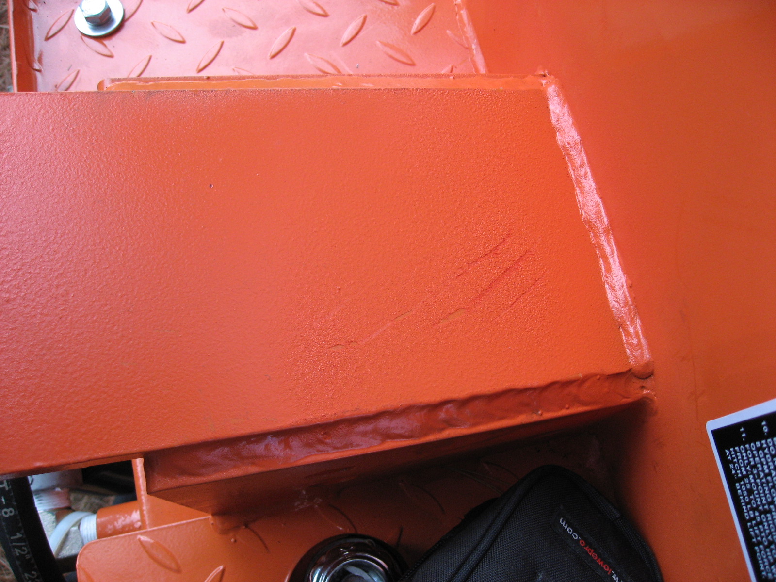

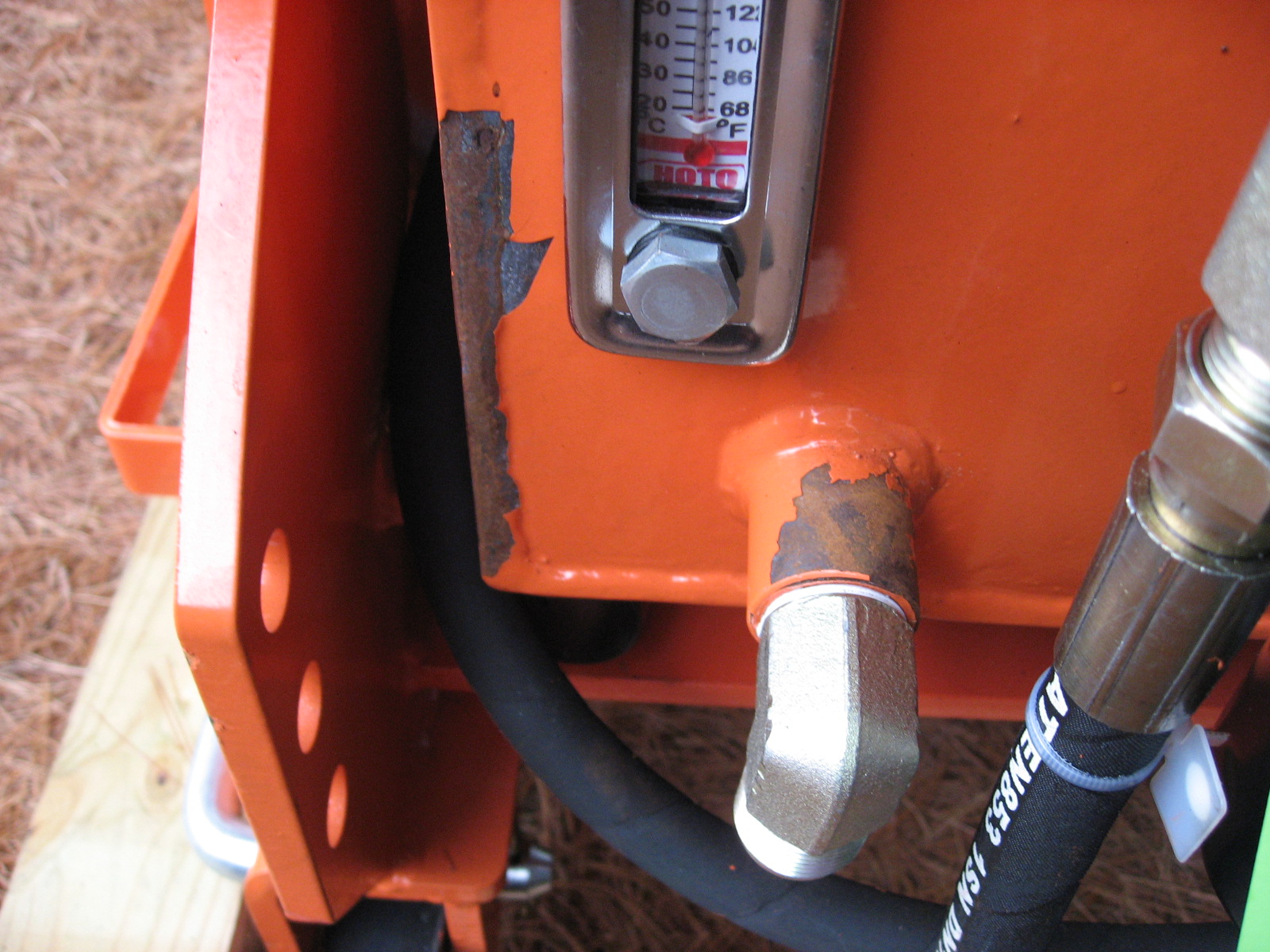

As I was assembling hoses, I noticed the paint on the hydro tank was not adhering properly. In certain areas it was flaking off in big pieces. This is the only part that I found this on. Improper metal prep before painting I suppose. I cleaned up those parts with a little sand paper, tape and a rattle can. Unfortunate, but I can't exactly send it back. I will contact the company to let them know about it though.
I was able to get the lower 3 PT arms connected without issue, then I worked on the solid top link I think the solid piece is a little short for my tractor, but I was able to make it work. I'd prefer one that is about 5" or 6" longer. I'll have to ask Woodmaxx if they have what I need.

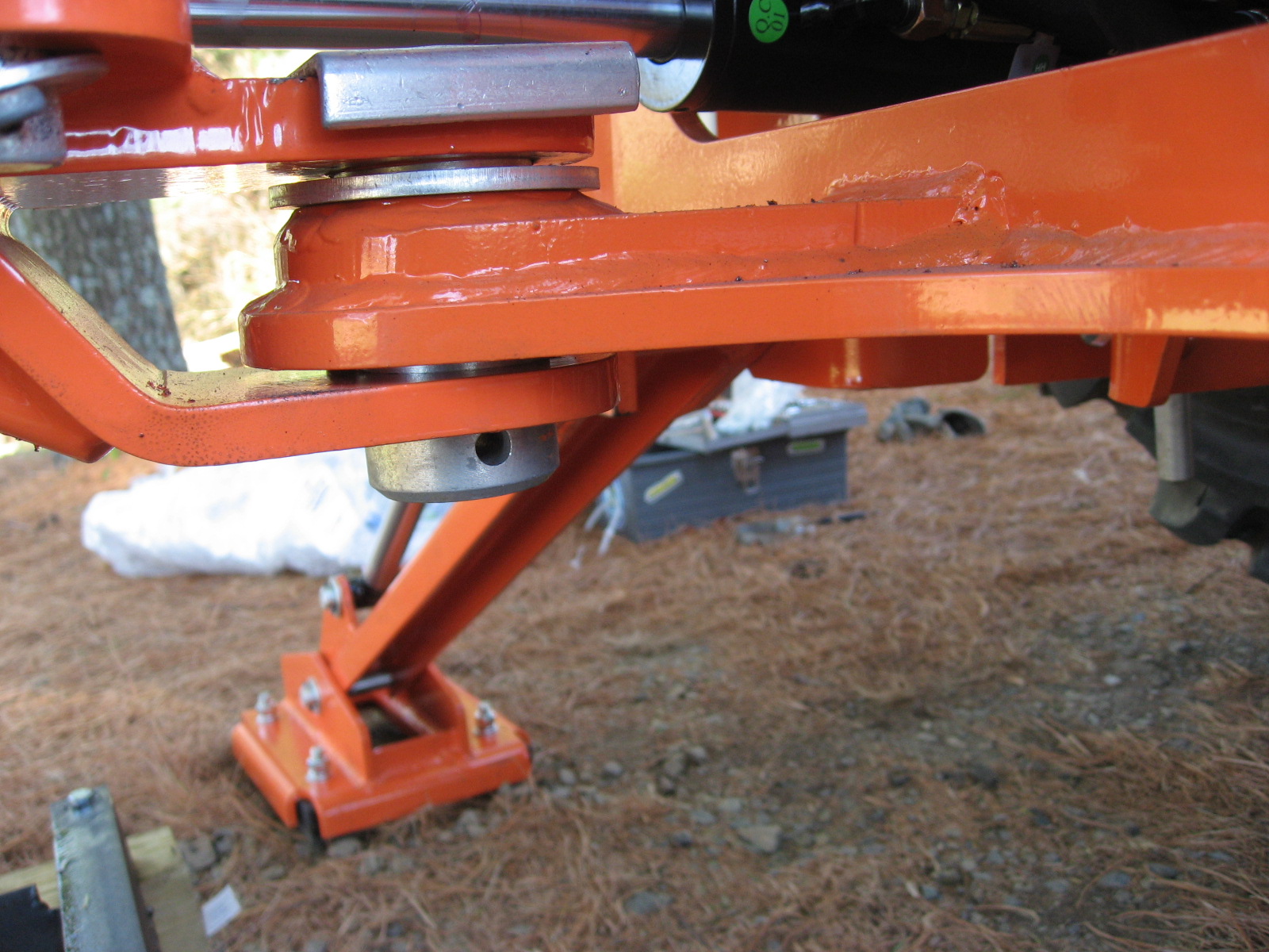

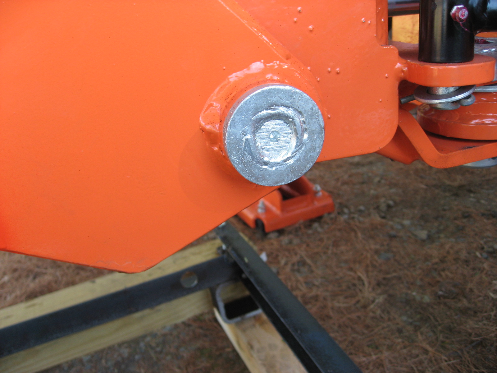

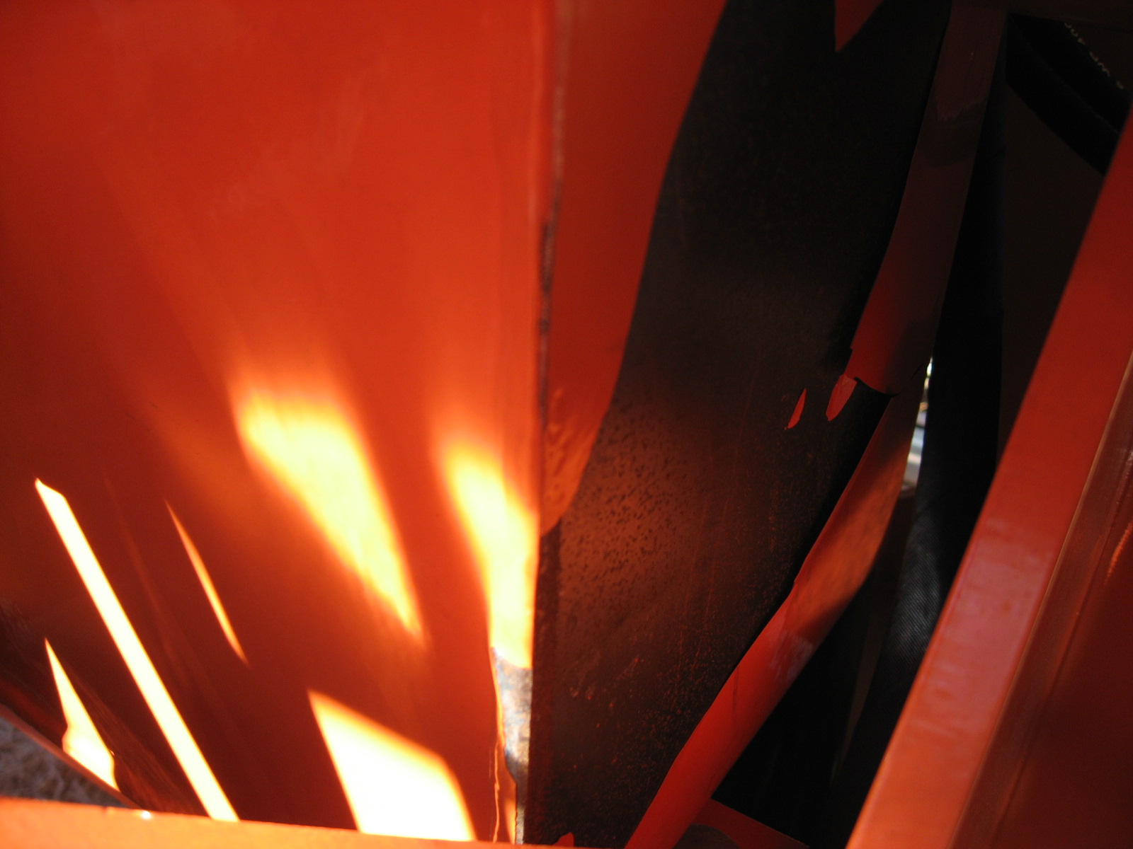

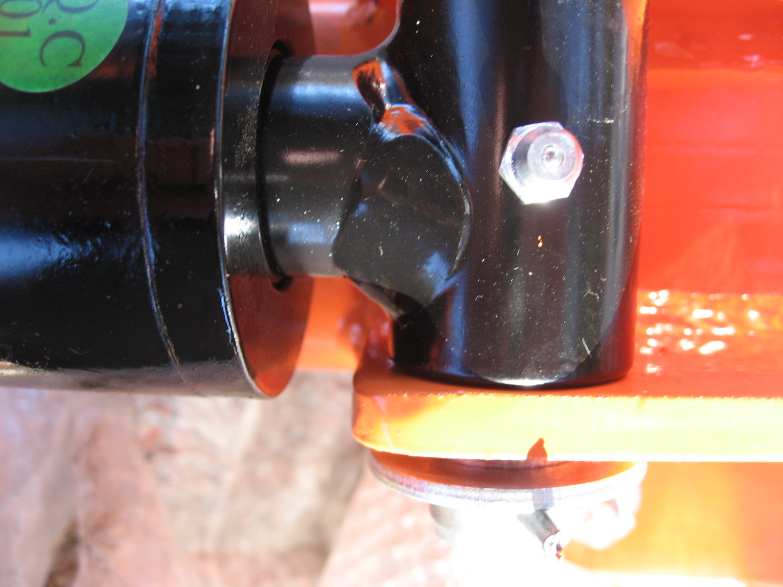

Now it was time to grease all the zerks which was pretty easy and worked as advertised. While doing this I notice two things. I couldn't find any way to grease the main pivot pin. It looks like it's suppose to have a zerk on the end, but wasn't completed. I'll ask Woodmaxx about that too.
After thinking about this one, I probably have to lower the dipper to look inside for the zerk.

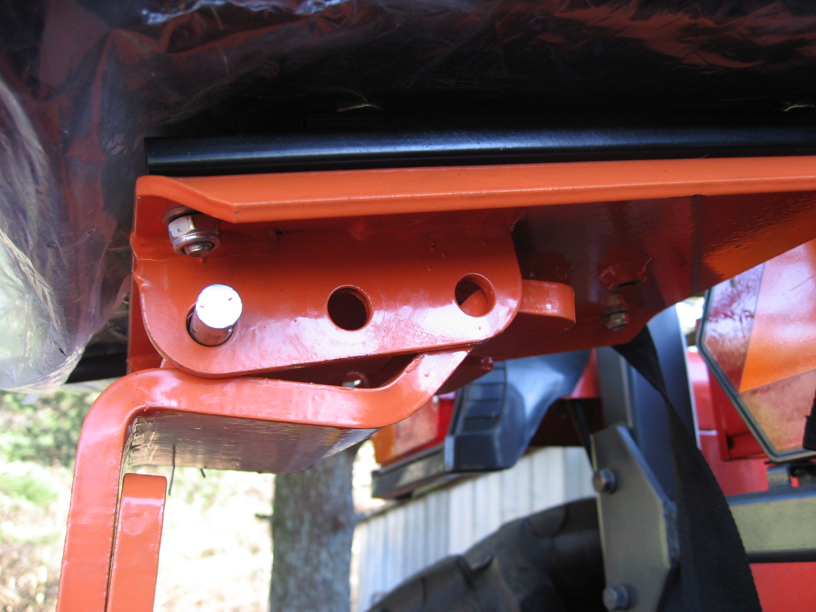

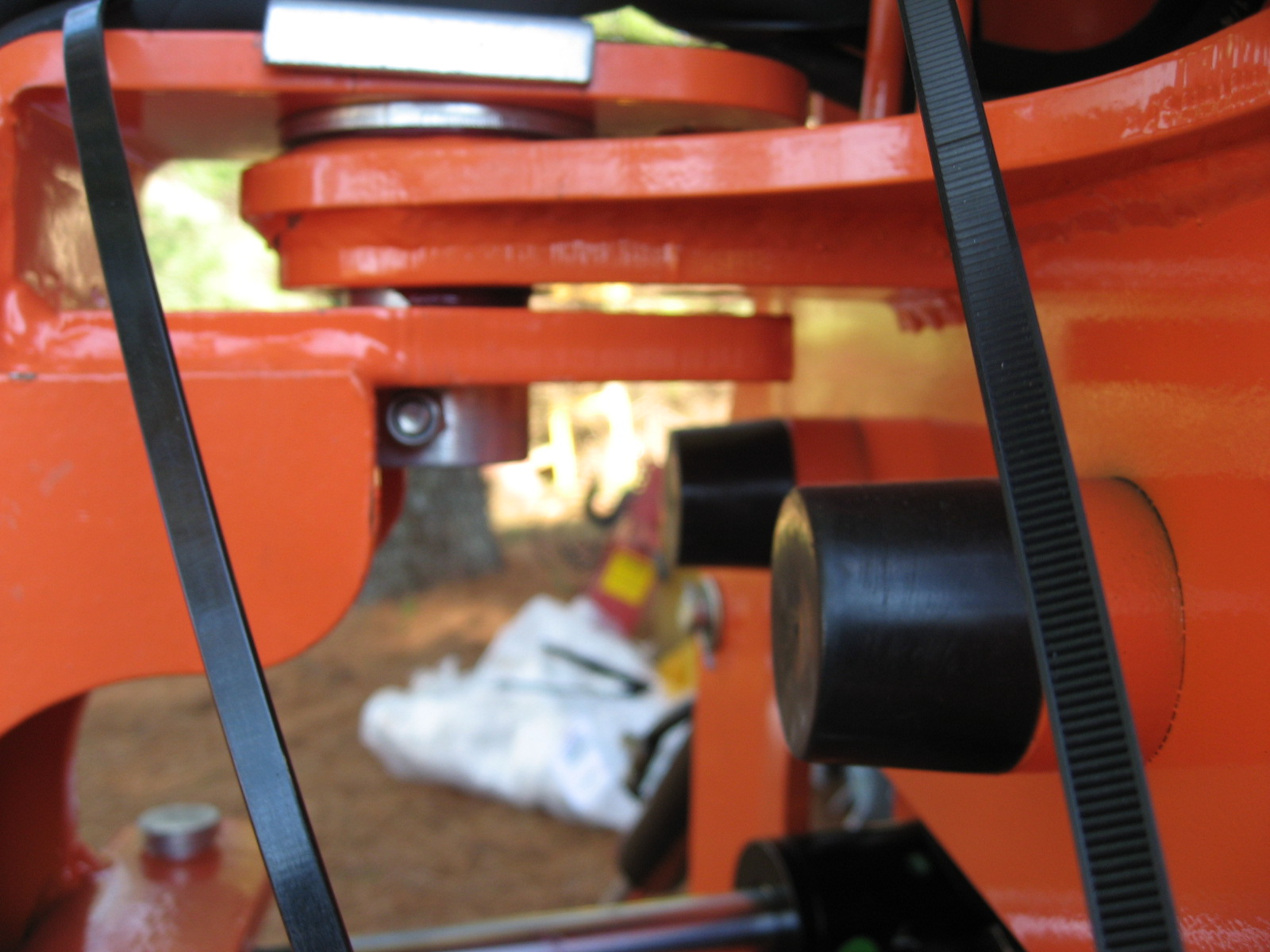

The other thing I spotted was the lower main rotating point "pin" didn't have a nut and bolt holding it in place. Easily fixed with nut and bolt on hand, but I envision that could have been a major problem it that one slipped out!!!
The upper one had the nut and bolt.

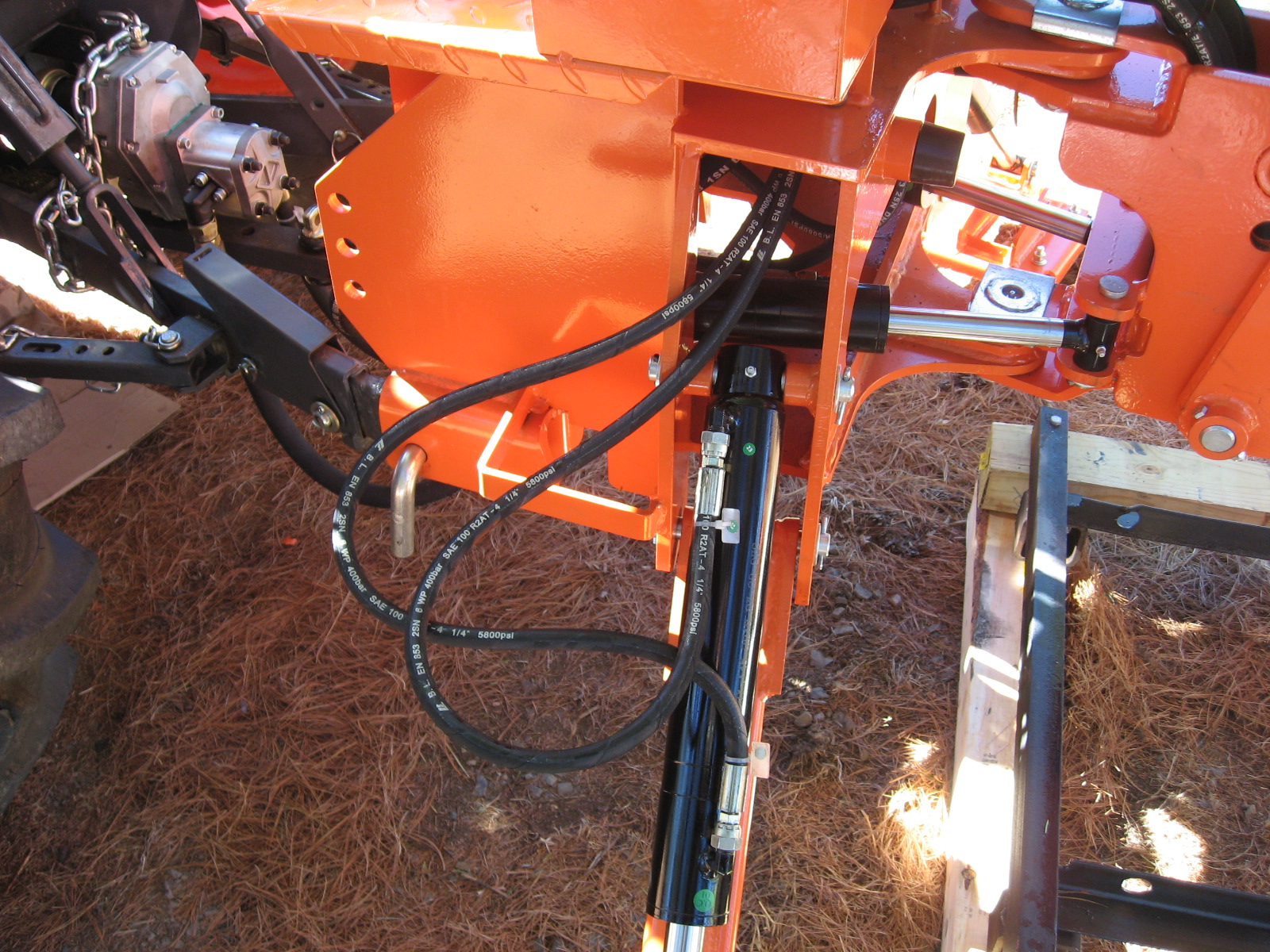

I was finally ready to test it out . Everything worked as advertised except I couldn't figure out how to get the hydro thumb to move. Nothing in the manual about it. I did have the extra lever, but when I moved it, nothing happened. I figured it out by accident.
Hydo thumb diverter.JPGthe lever is just a diverter so that the right stabilizer lever activates the thumb. I was able to get some seat time with it to dig out an old pine stump that had been in my way for years. The hoe did a fine job and was very strong. One thing I saw was that downward pressure with the hoe raised the 3pt a bit. It's suppose to have no play in it. I think what I'm going to try is a turn buckle hooked from the hoe side of the top link bar to my draw bar clevis to remove all play and take some of the strain out of the tractor side of the top link. We'll see.

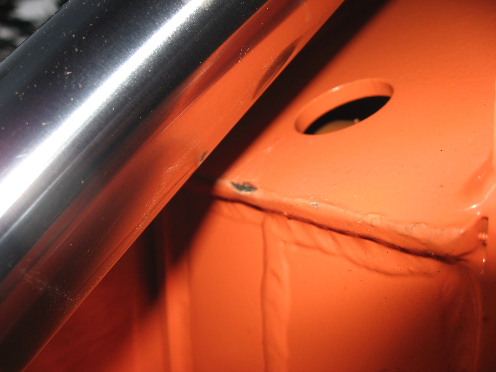

After a post-inspection of the hoe, I notice the top hydro piston was contacting metal when it's fully curled. I grinded out a pocket for it so it wouldn't touch. No noticeable marks on the piston. Caught early I suppose.
