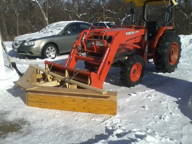

I have about a 600 ft gravel drive and a more than usual 10" snow. Usually don't get this much at one time and have done the needed very little snow removal with the FEL but it takes a lot of time and I end up with some gravel in the grass, etc.. With below zero temps I wanted to limit time outside. Saw a few wooden plows on the net and had some lumber so gave it a go. Don't have capability to do welding and I would only use this a time or two per year. In a couple hours I had a blade about 8.5 ft wide. Used a couple scraps of microlam for the bottom but 2 x 10 would have worked ok too. 2 x 6 on top of that with a 3/4 ply top lip. Some 2 x 4 framing to fit the bucket and a chain to hold it in.
It worked very well. I was able to drive right down the road in one pass. I kept it a bit above the gravel but it hit in a few spots with no problem. Also skidded across the grass in some spots. Made a pass down each side to widen things out. It was light powdery snow which helped. And some skids so I could get a bit lower would be nice. All in all I was pleased with how well it worked, especially considering how easy and cheap it was to put together. It doesn't compare to other projects here but it did the job I needed.

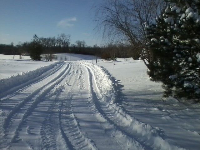

Didn't get any pictures of it in action but here is the plowed road.

Looks like it did the job and that is 99% of the battle.

Serve the purpose well.

Pretty cool!! And you were able to make your path wider just by using one side of the blade. Good thinking. It's interesting how we all get stuck into a "metal fab" state of mind when doing stuff with our equipment but you stepped out of the box and used wood! Obviously you wouldn't be clearing mall parking lots with it, but for your driveway it obviously worked well.
I wouldn't mind seeing a couple of pics of it "unmounted" from your FEL if you get a chance. I'm curious to see how the framing was done. I might do something like that for my driveway. The only other thing that I would do is put some "skis" under it so it doesn't scalp my gravel driveway. That way I could leave an inch or two of snow on top of the gravel.

Not necessarily, as long as you keep widening the drive and don't just take one pass, you can use that effectively through the winter.
