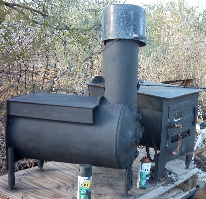

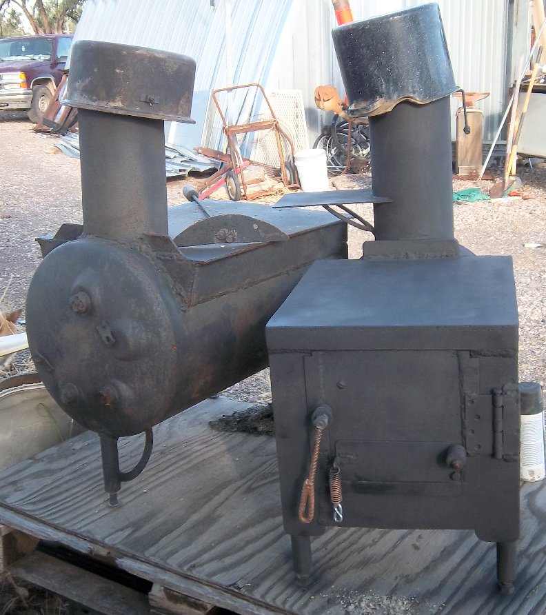

Here are a couple of wood stoves that I built. Cost is very little. Old hot water tank & some scrap iron.
Myself and 2 others have been heating our houses for 4 years with similar. Leave off the flat top if you like. But It is nice to do a little cooking & heating on.
Look through my old posts on building them.
