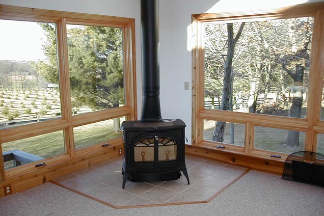

Just installed a Vermont Castings Defiant wood stove, on ceramic tile floor over cementboard over wood (3/8" underlayment and 5/8" sheathing). Cathedral ceiling, with two fans at the peak. Heats VERY well, in a room with 720 sq ft and about 90 % glass on the N, E, and West sides.
Eight inch chimney going straight up. The pic attached will help.
Have hot water heat in the rest of the house (up and down) that is either gas and/or wood fired boiler. Wood is good.

This looks very similar to house except the window on the right does not extend so far into the corner we have drywall about 3three feet to the right and about six feet to the left from the corner then a sliding glass door on the left and a large picture window on the right. I see the floor is tile how far out does it extend in front of the stove? and is the drywall behind the stove drywall or cement board? how much space from the stove to the corner?
thanks for all your help and everyone elses.

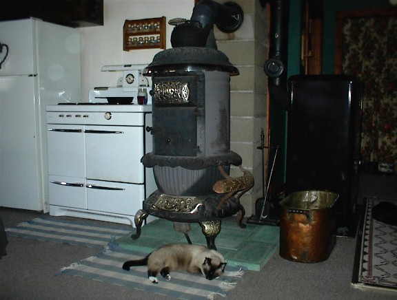

Hello GT, We've been heating with a 1906 Round Oak cylinder stove for the last 11 years. Clearance in back is 16". Woodwork and sheetrock on left/back with no problems. Stove sits on patio blocks( about .99 cents apiece) Average btween 3-5 cords a year. Burn time (depends on wood) 6-8 hrs. Jungers oil burner (on right) we use if we have to leave for a couple days. Ins. agent more concerned with "Wolfgang and Jo-han" than our wood/oil set-up. Just found foot warmer(still rusty) need another for other side. Also looking for bonnet and finial............Wood heat warms the soul..................mark

The tile is 18" in front of the stove (code), and the wall behind is drywall (not cement board) permissable by the code. The distance from the back of the stove to the corner is 46" (not a code requirement), with the distance from the corners of the stove to the wall being 28" (code requirement) for un-protected wall. One can get closer to the wall if there is a false wall in front of the regular wall (giving an air space to take the heat).
These distances can be found in the manual for the Vermont Castings stoves (may even be on their web site)
