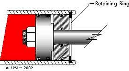

How to get into cyl end on welded speeco cylinder need to replace seals
   / Wood splitter cylinder #2
Check ram end for recessed "C" ring holding plunger and gland in place.... Its possibly similar to image below...
