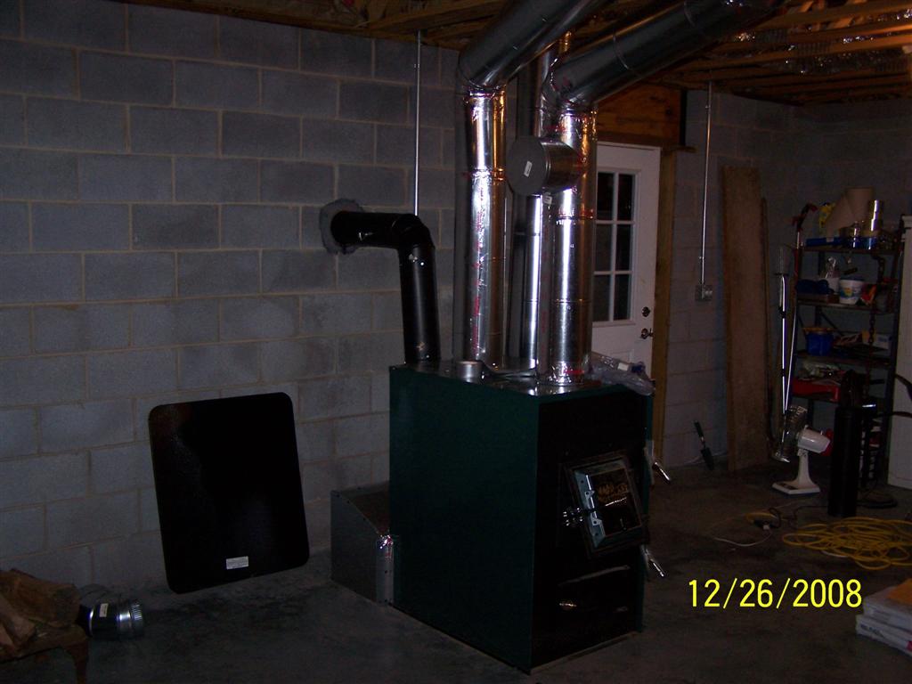

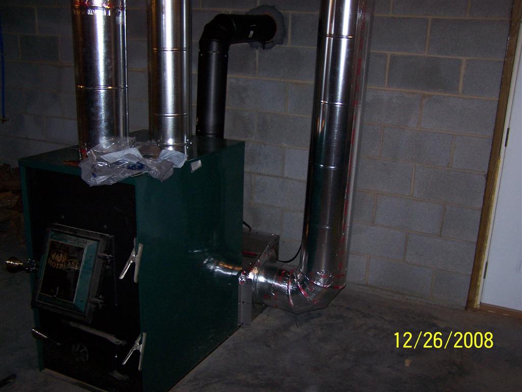

I bought this unit from TSC about 5-6 years ago. However they had them at TSC this year and they are a lot smaller now. It is made by US Stove.
It is ran into my duct work and I have a return set up into the blower at the back. I have a heat pump with propane furnace as back up. I installed dampers for the return and where the blower enters the duct work. This way if the wood furnace is not being used I can close it off when using the heat pump or AC in summer.
It works great and easily heats the 2000 sq ft living area. I also have 2000 sq ft unfinished basement and it will heat it and the living area if needed. I put a "T" in the top of the stove in case it get a little warm upstairs I take the cover off and let it blow in the basement.
I can usually go 3 years without filling the propane tank. This is the third year with no fill up and currently the propane tank is at 30% on a 600 gallon tank.
