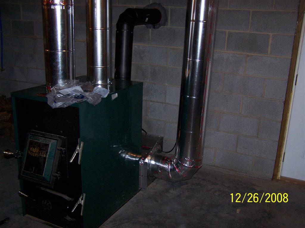

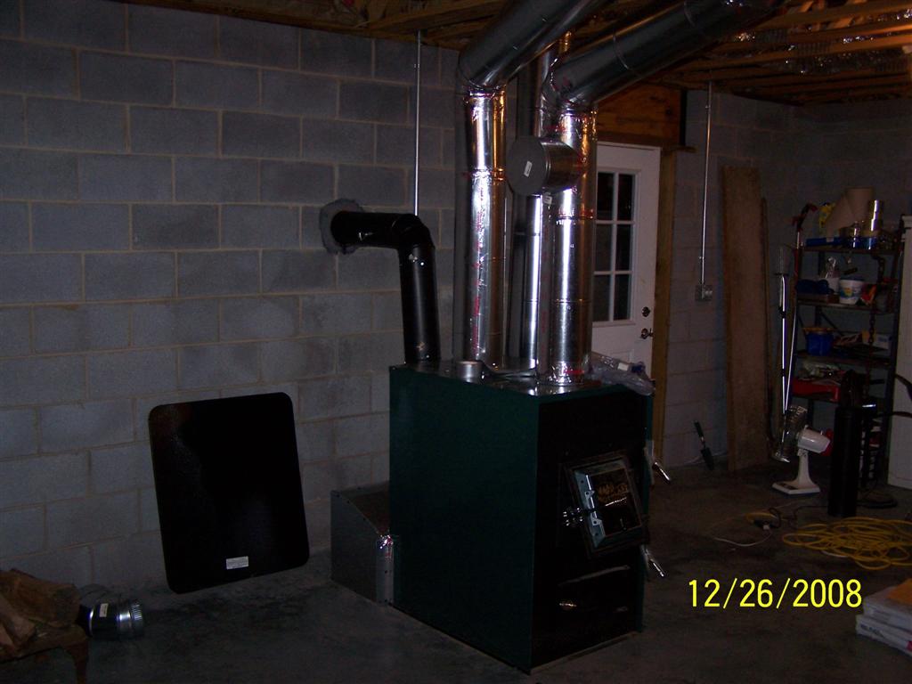

Thomas,
This is my wood furnace made by US Stove. I have 9' ceilings and a cathedral ceiling in the great room. House is 1950 sqft upstairs and same in the basement. I have it duct into my system and return with dampers to open and close when not in use. Heats great, and the "T" section on the top is for when it gets too hot upstairs I can remove the cap to blow downstairs.
If you want more info just let me know. My internet access is limited right now but I will do my best to answer any questions if interested.
David

Thomas,
I have that same furnace in my shop. The previous one (small model, same company) burned out the back and side walls after about 12 years, so I replaced it with the one you have.
BUT.....Before I ever built the first fire in it, I added a piece of 1/4" thick, 1.5x1.5" angle right above the existing fire brick (which lay in there at about a 45 degree angle), then another piece a fire brick high (both sides) so I could line each side with more brick.... raising the brick coverage in the firebox. (takes about 8-10 brick on each side if I recall). I think that is a vast improvement to that furnace, and it should last the rest of my life now.
