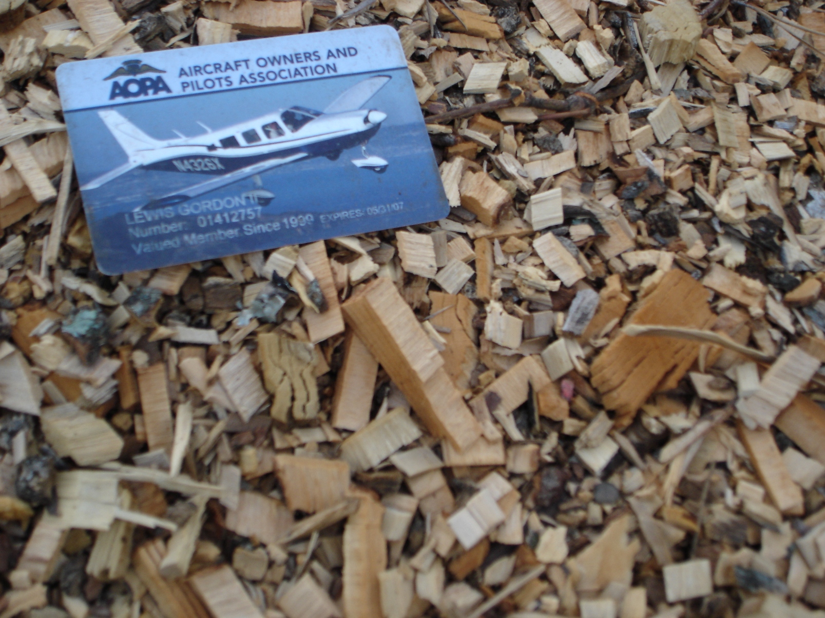

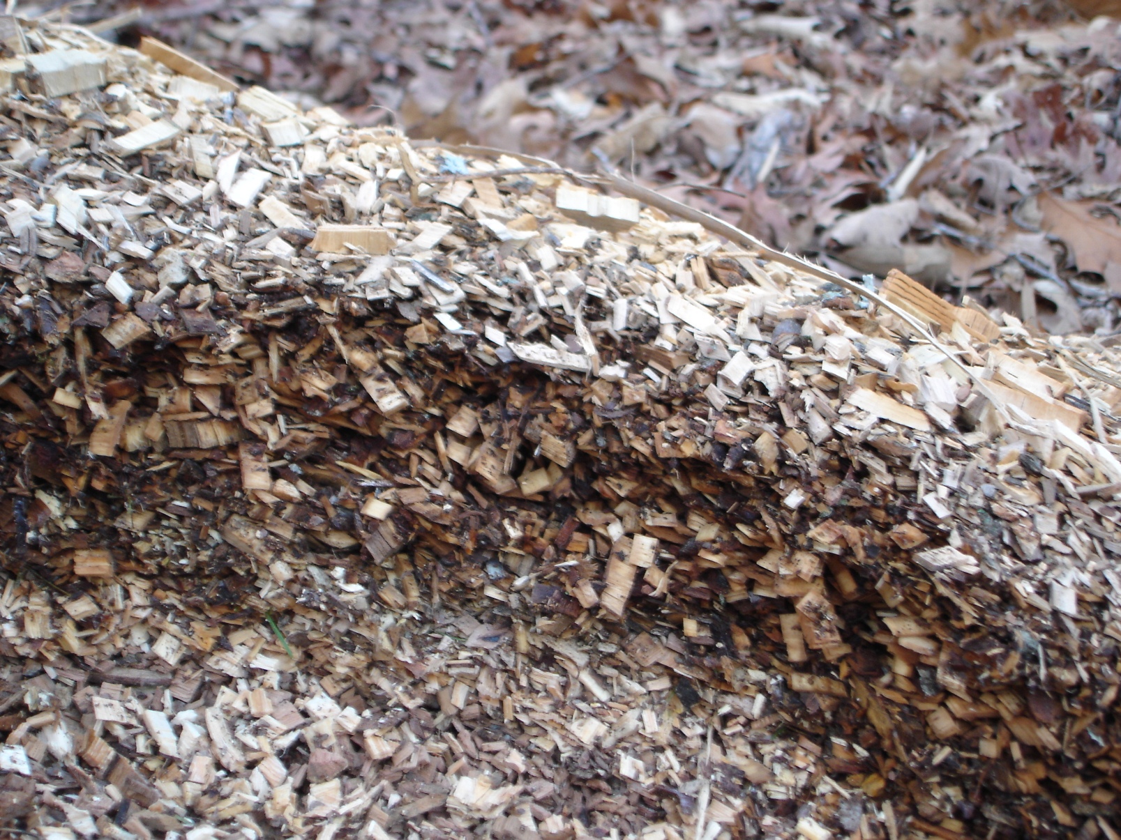

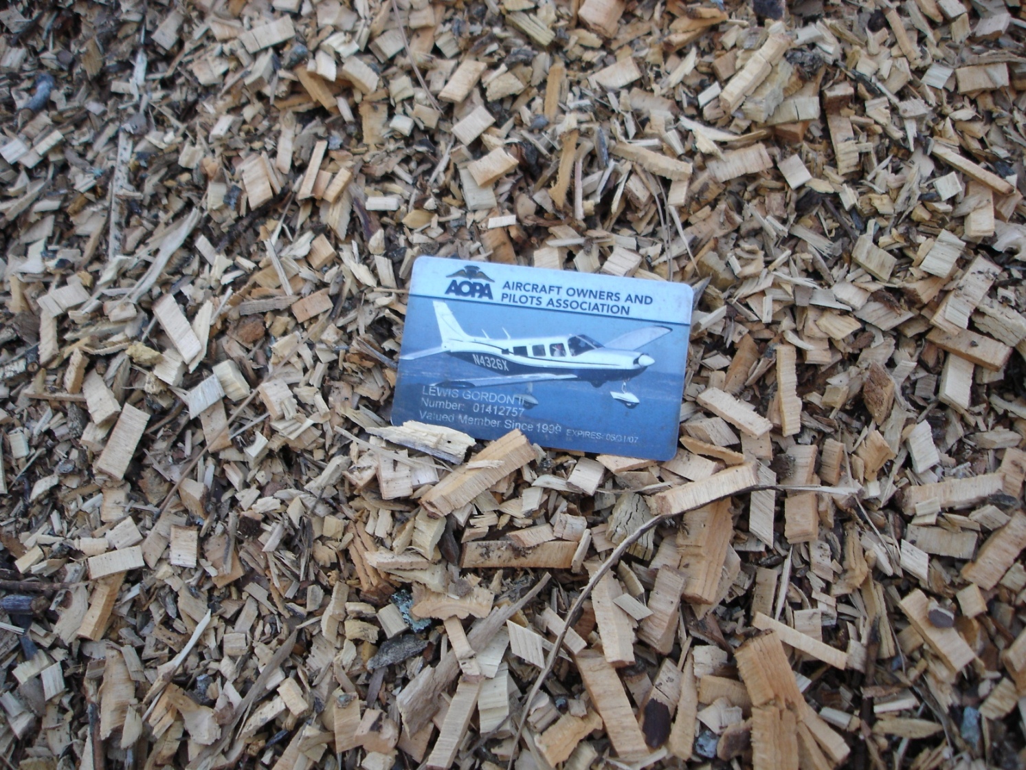

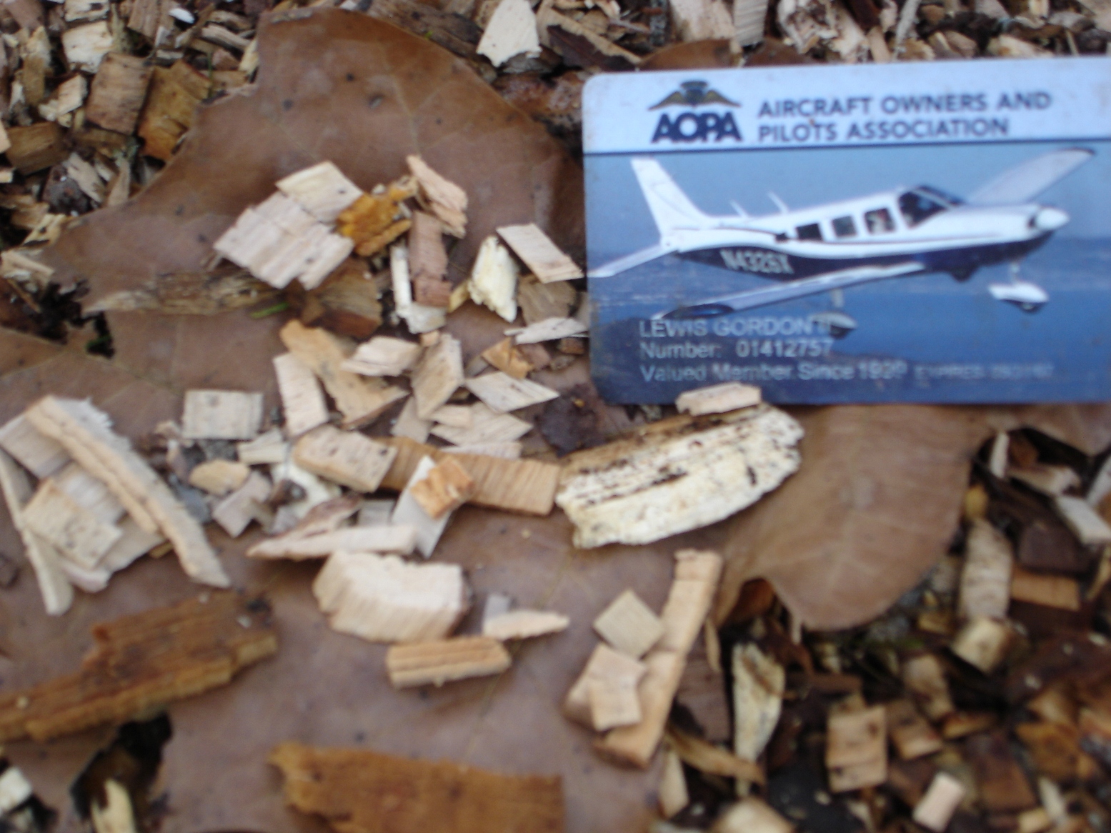

Here are some pix of the chips made by a Jinma chipper. The card in the pix is the same size as a credit card for size reference. Pix #4 shows where I brushed aside part of the pile so you can see the dark layer underneath. That is the damp layer. Light rain last week only went down about 3-4 inches and the chips held all the water. there are dry chips 5" down in the pile. If you make your mulch too thick, you need to really hit it hard with water to keep the plant roots alive underneath. This pix is a dramatic example of rain never reaching the plants if you had more than 2" of mulch depth.

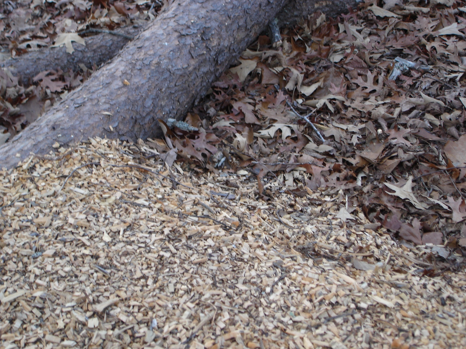

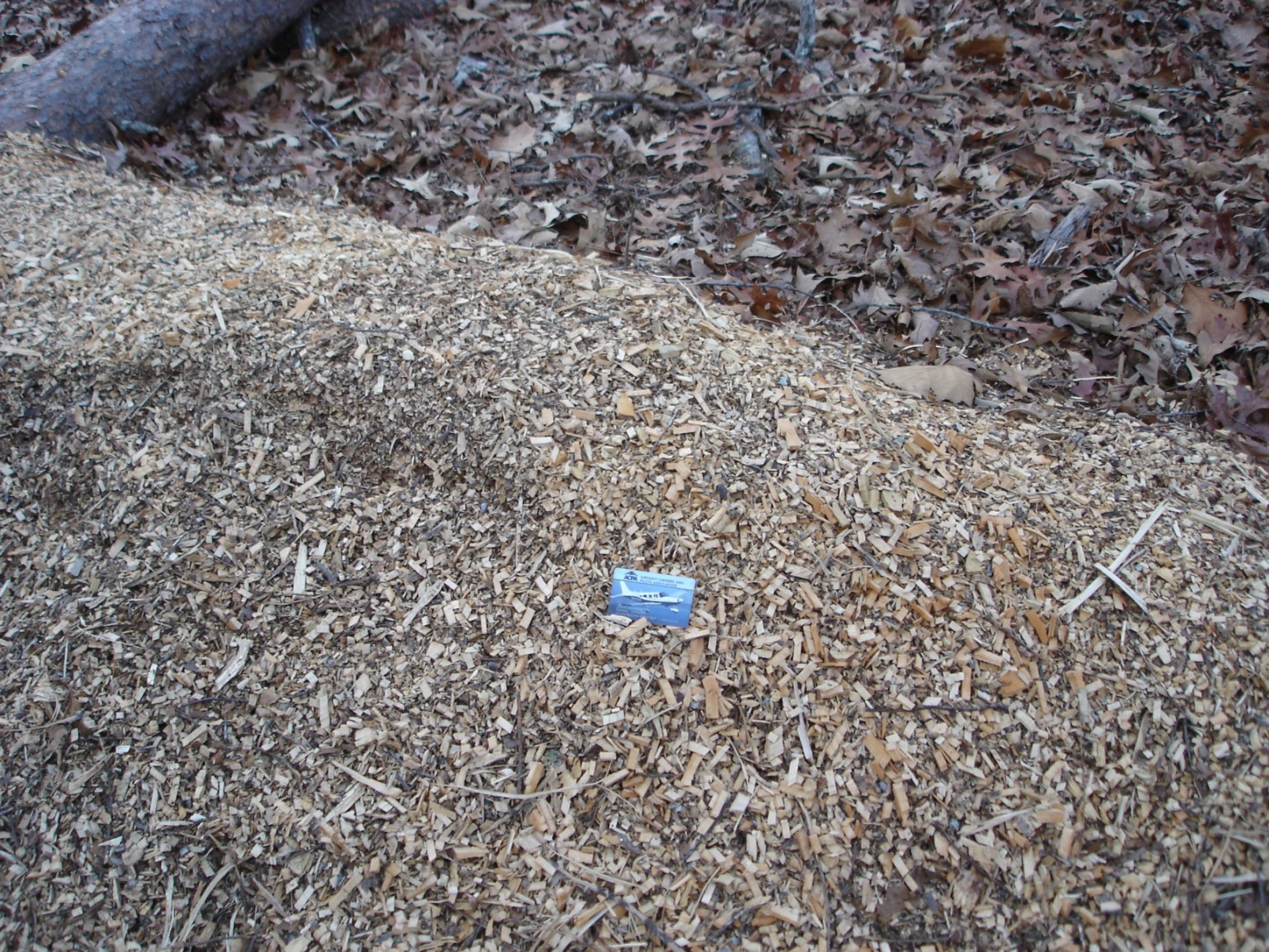

The last one shows the very light color compared to pine bark and dead leaves today. The coloring of wood chips is very nice compared to cypress mulch or pine bark from a garden center.

Those are some good looking chips. Have any trouble with the chipper since you bought it? How many hours you thinkk you have on it?? Whats the biggest diameter you put through it?

Lewis, Thanks for all that. It makes nice chips. I'm thinking a small shedder my be needed for some things though. MP
