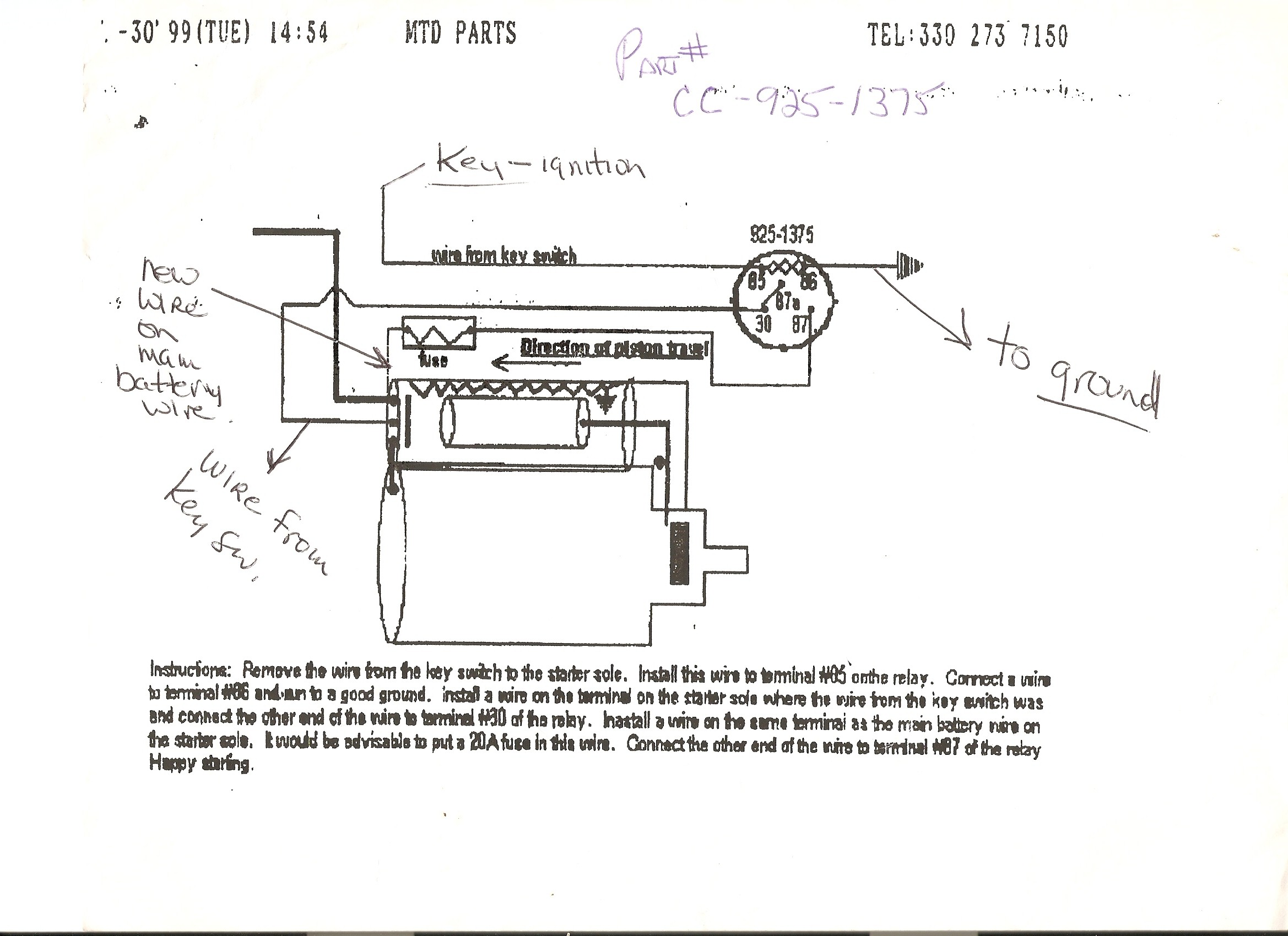

I have a 1996 Cub Cadet 7275. I have had no problems with it starting. Went to start it today to put my 3pt snowblower on it and it just clicked. Battery seems to be fine. Headlights torn on, etc. I played with the rear and mid pto levers to make sure the safety switches were engaged. They seemed to be fine. While turning the key to start I moved each lever and there was an audible click when I put them in the off position. I did the same with the shifter, putting it in neutral to start. I havent used the tractor in about 3 weeks, and it worked perfectly fine then. Any suggestions are greatly appreciated.
   / Won't start, need help #2
You probably need this relay
