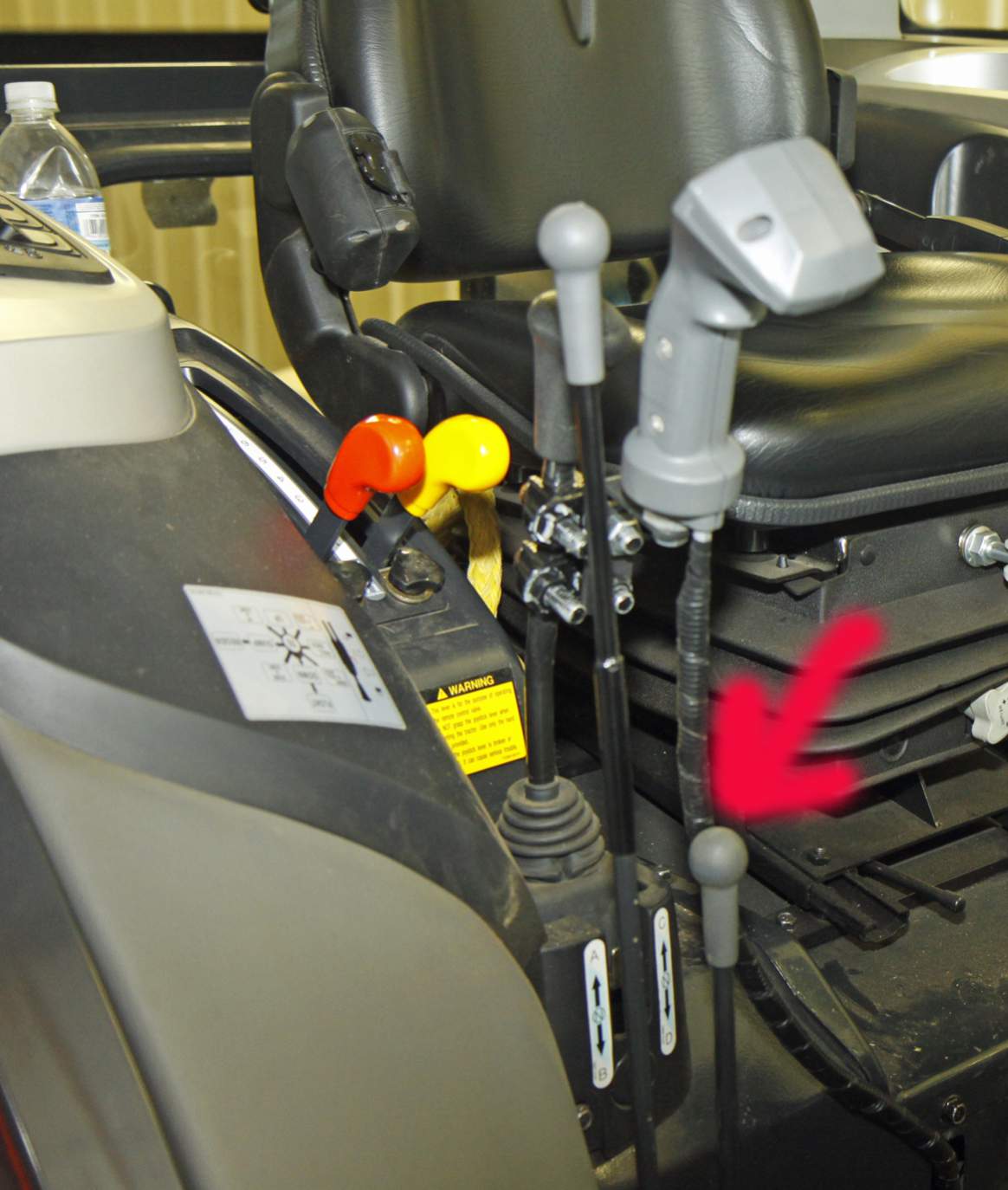

if you have rear remotes you have a lever to control them. this lever moves foreward and back. on my tractor there are 2 levers. one will lovk in foreward or reverse position. this is a locking detent. if nothing is installed on the hydraulic system...that is deadheading.
heres a pick of mine...the location may be different on yours.

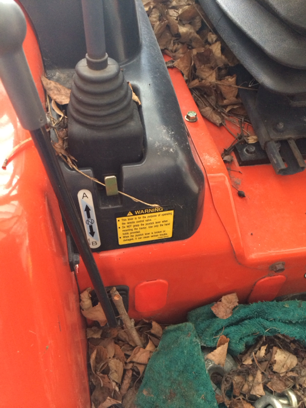

Looks like I don't have that lever for the rear remote. There's a cut out where that lever would go.
Unless I am mistaken that tall lever to the left of the picture with the big knob at the top left of the picture is the control for the remote hydraulic coupler on the rear of the tractor. if that lever is pushed either forward or backwards from center it will deadhead, and you will not have 3 point control. Move that lever forwards and backwards to see if it is centered.
PS that orange cover next the the rubber boot at the bottom of the picture is the cutout for a second rear coupler lever, if installed.

Yep, that was it. That lever wasn't centered. Thanks a million!!

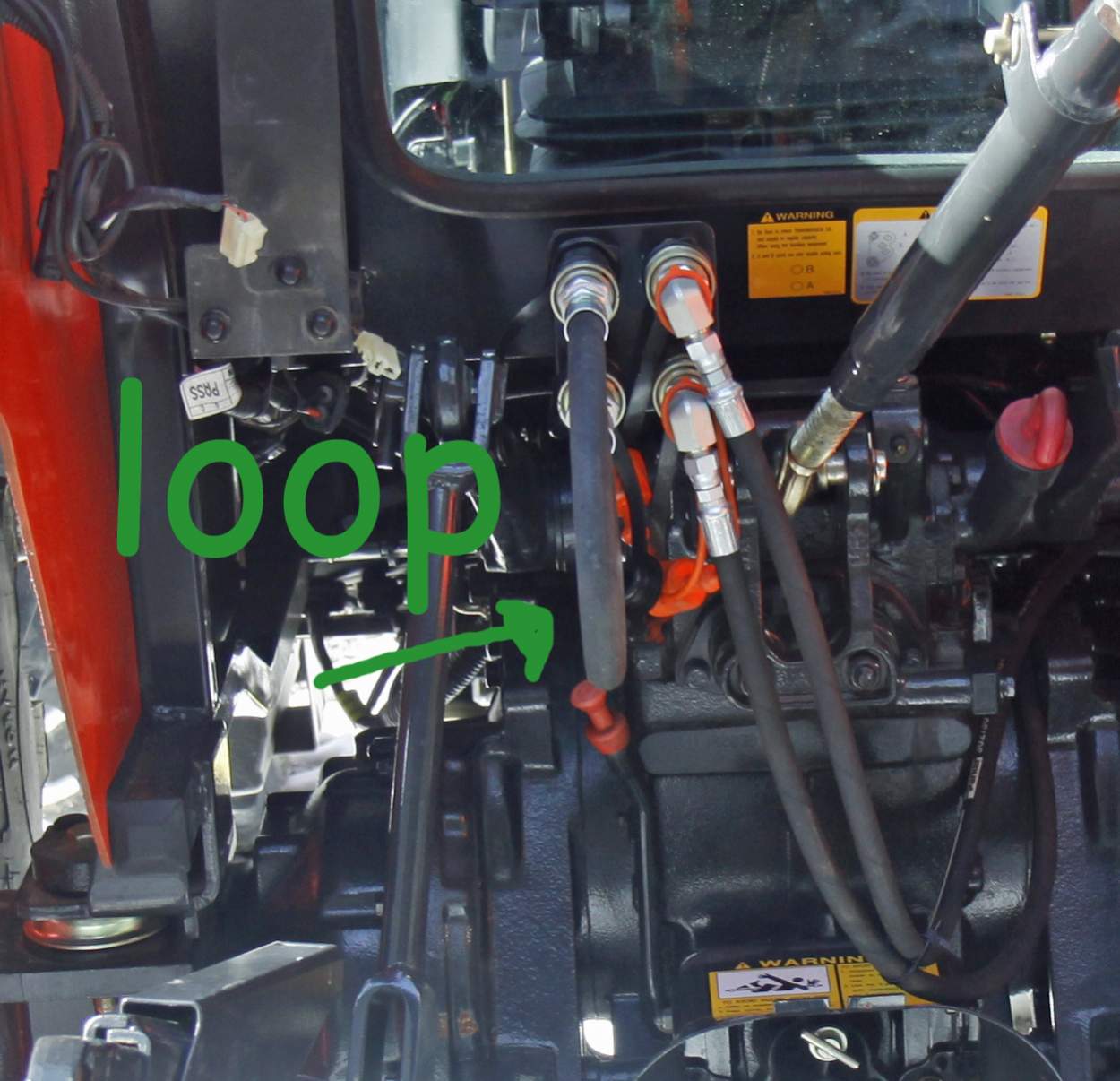

ok, i thought that was all that was wrong. The best way to prevent this again is to make a small loop of hose and connect to the unused rear ports....like this
loop.jpgand just so you know. letting it deadhead (locking it without having anything connected) can damage the hydraulic pump
