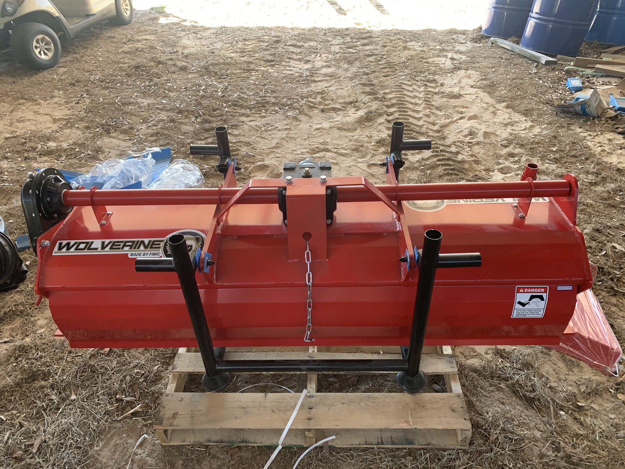

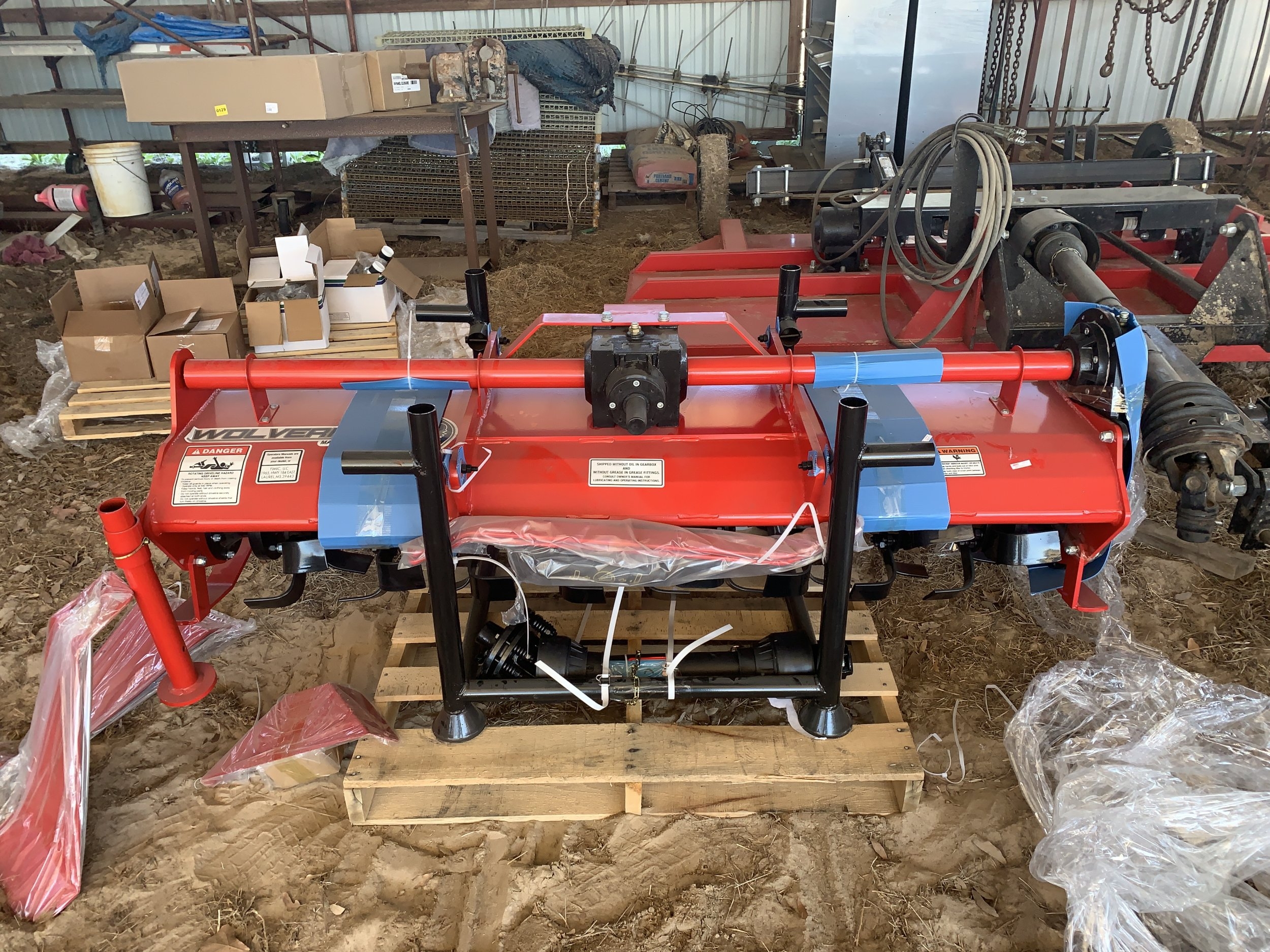

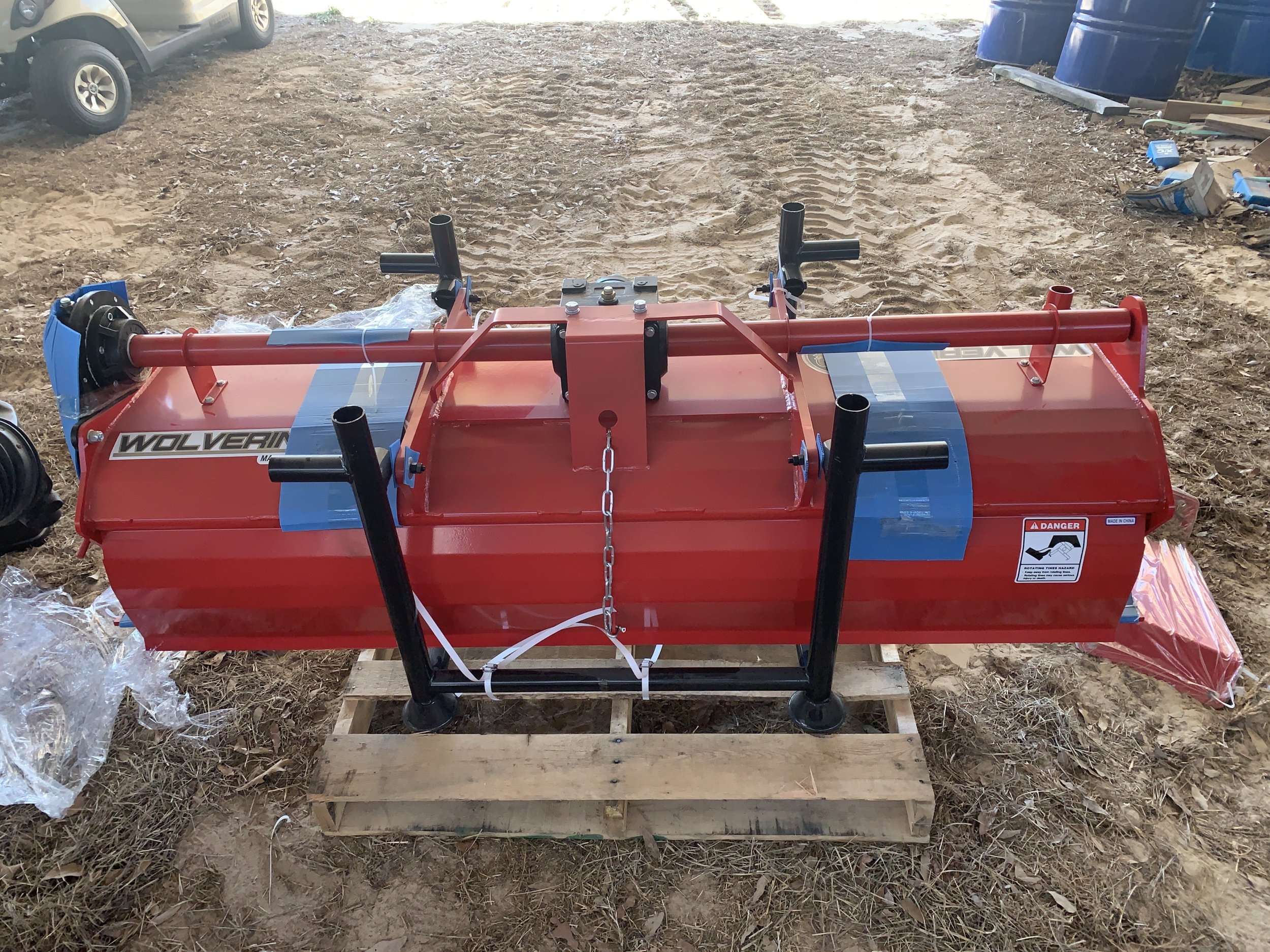

Well I ended up buying the Wolverine. Buying the FMCRT-G04 6ft Rotary Tiller is fast and simple. Shipping is free and very fast, I received my first tiller 2 days after ordering it but couldn't accept it because it was all covered in hydraulic oil. Nobody knows where it came from because the unit is shipped without oil.
Since I needed the tiller and didn't want to wait until the shipping company sent it back and all that investigative process, and knowing that eventually the first credit card charge would be refunded, I went online and ordered and paid for a second tiller. This one also arrived 2 days later but in almost perfect shape.
I say almost perfect shape because seems like they were in a hurry at their factory in China to ship them to their warehouse in USA and the decals were installed leaving many sides not sticking to the tiller completely. Since the decals were lifted they were full of dust and wouldn't stick. Knowing that those decals being lifted and that dirt would get into them and it would be a mess that would never look good, I emailed the company and sent them pictures. I requested if they could send me new decals that I would remove these and install the new ones. I believe that it's good advertising if not why install decals?
I asked in 2 emails about the decals and no reply so I just removed all the stickers. Sadly this lack of quality control and no replies will be part of any conversation now when someone asks me what brand my tiller is.
The manual has steps and pictures that when asked the company employee told me the manual is not updated so those are not parts they supply anymore. It was missing the plastic PTO shaft cover, even though the manual warns to not operate the tiller without that cover.
When researching their website showing the specs regarding the amount of tines per flange didn't add up so I called and they told me 5 per flange but in reality it has 6.
I just checked their website and it doesn't show the 6' tiller available anymore and the price of the 5' tiller is now the same as I paid for my 6' tiller. Maybe it’s just a stocking issue but hopefully they bring back the 6’ because it’s a very nice tiller.
