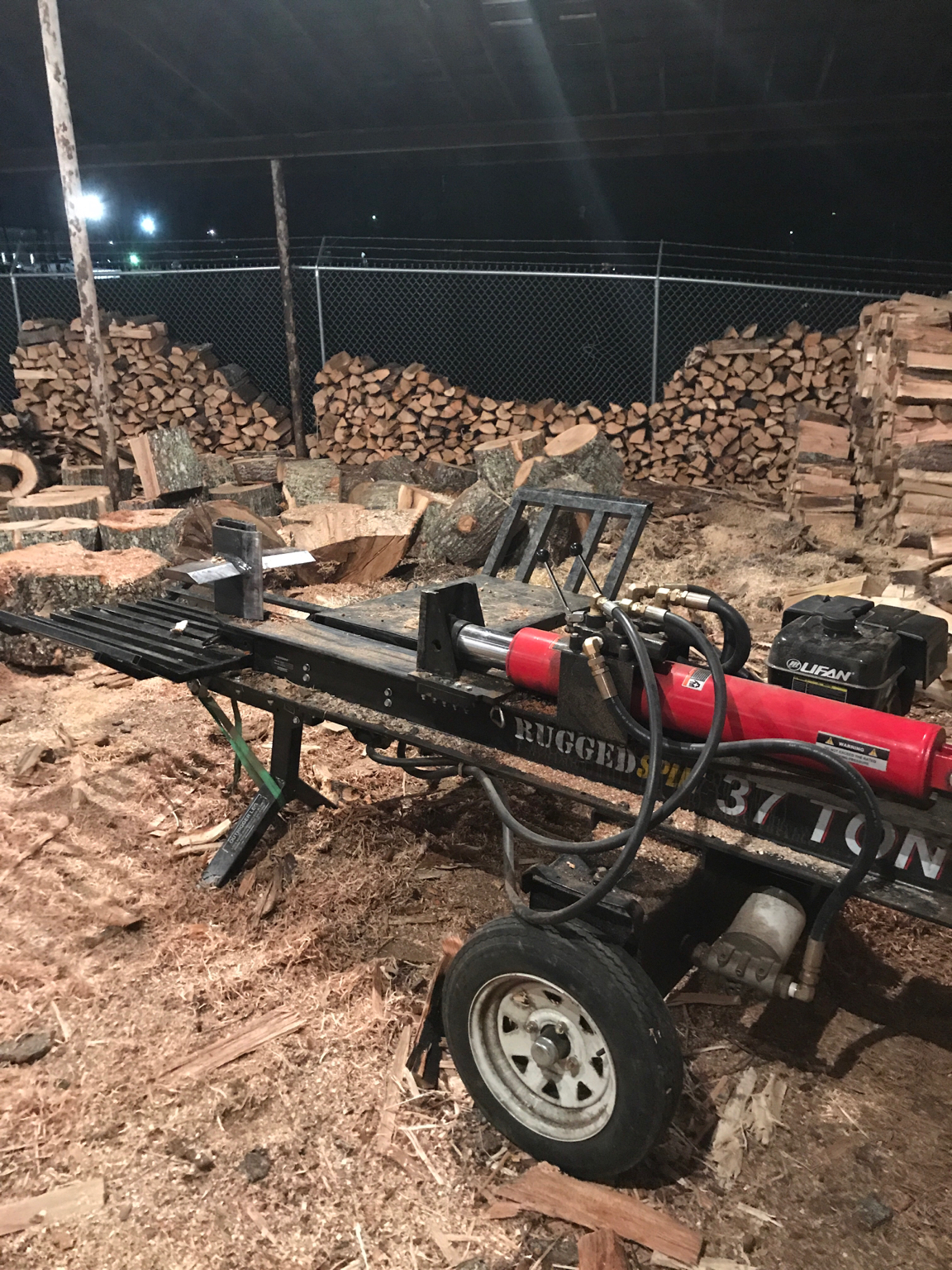

Unless I was bad wrong in the tractor GPM why is it so slow? Massive cylinder, tiny hoses, super long stroke? I’ve got a rugged made splitter. I’ll admit it has its short comings, but it’s half what another comparable unit cost. My splitter makes the 30” stroke in about 12 seconds. I usually keep the stop in it limiting the stroke to about 25” which makes it faster. IMG_0725.JPG

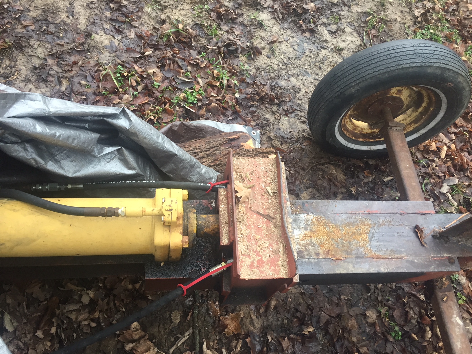

Hoses are 1/2", Stroke is roughly 24", I do not know the diameter of the cylinder. I do have a partial picture if that helps, its massive from what I have seen on other splitters.
