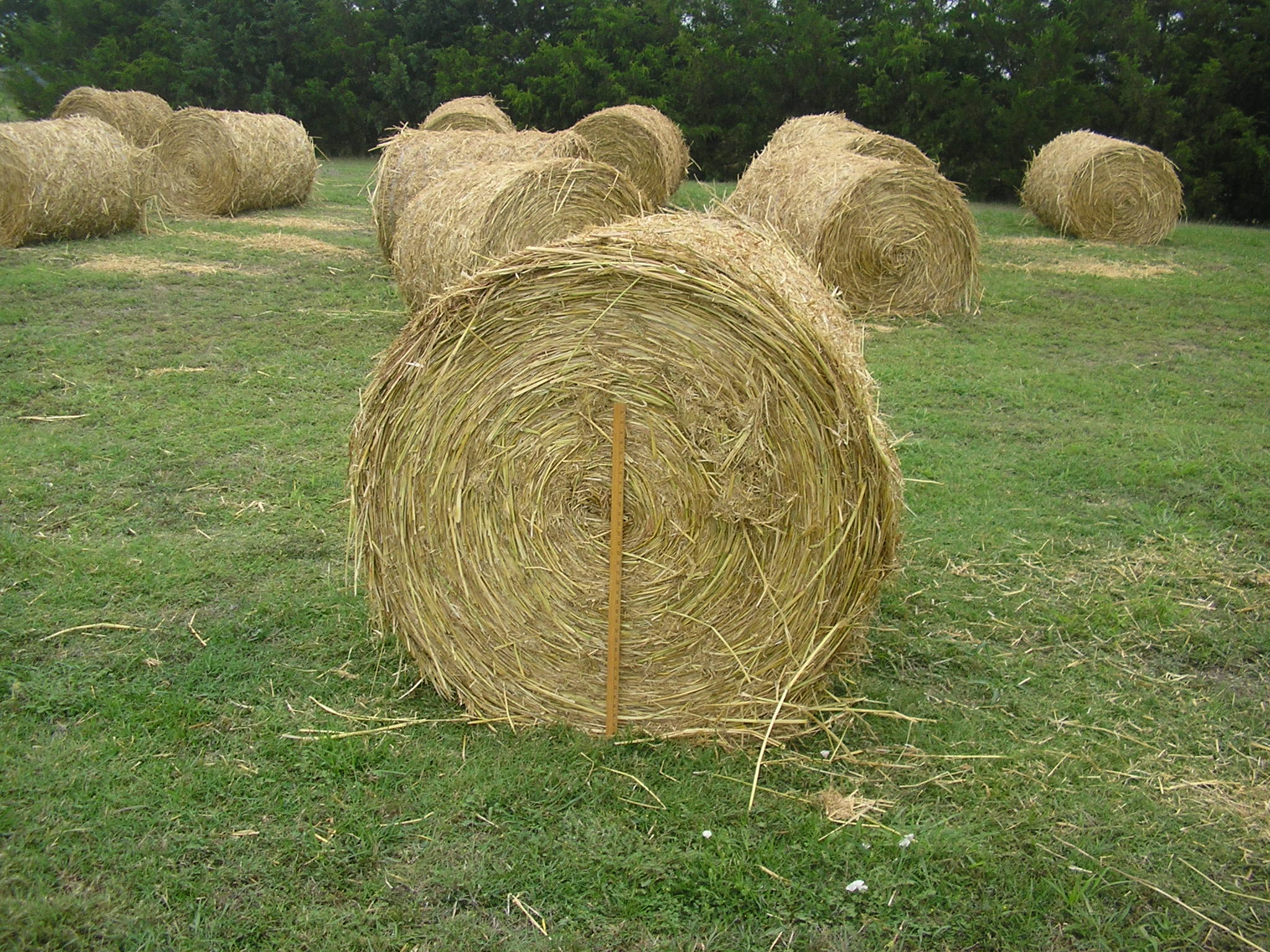

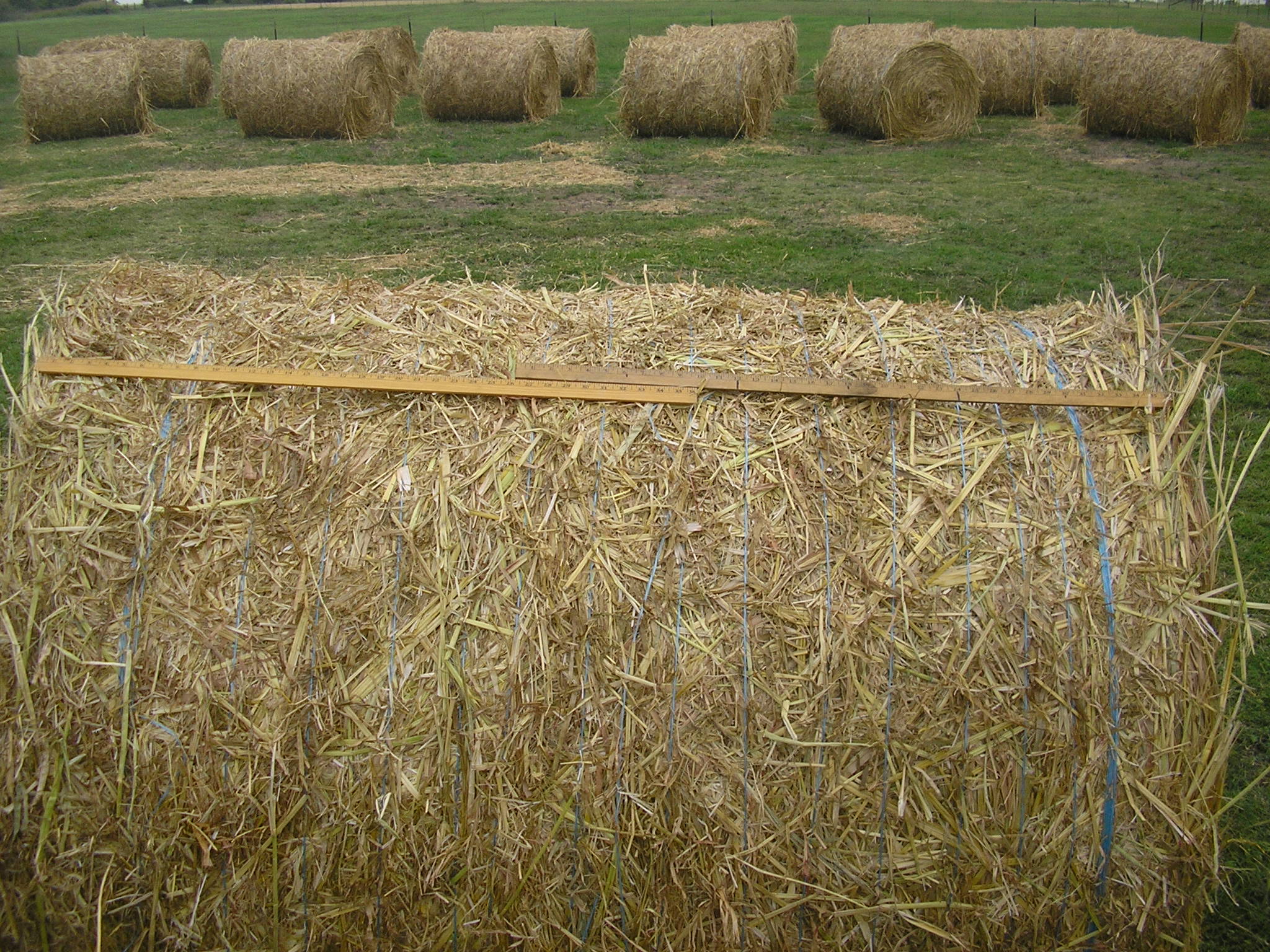

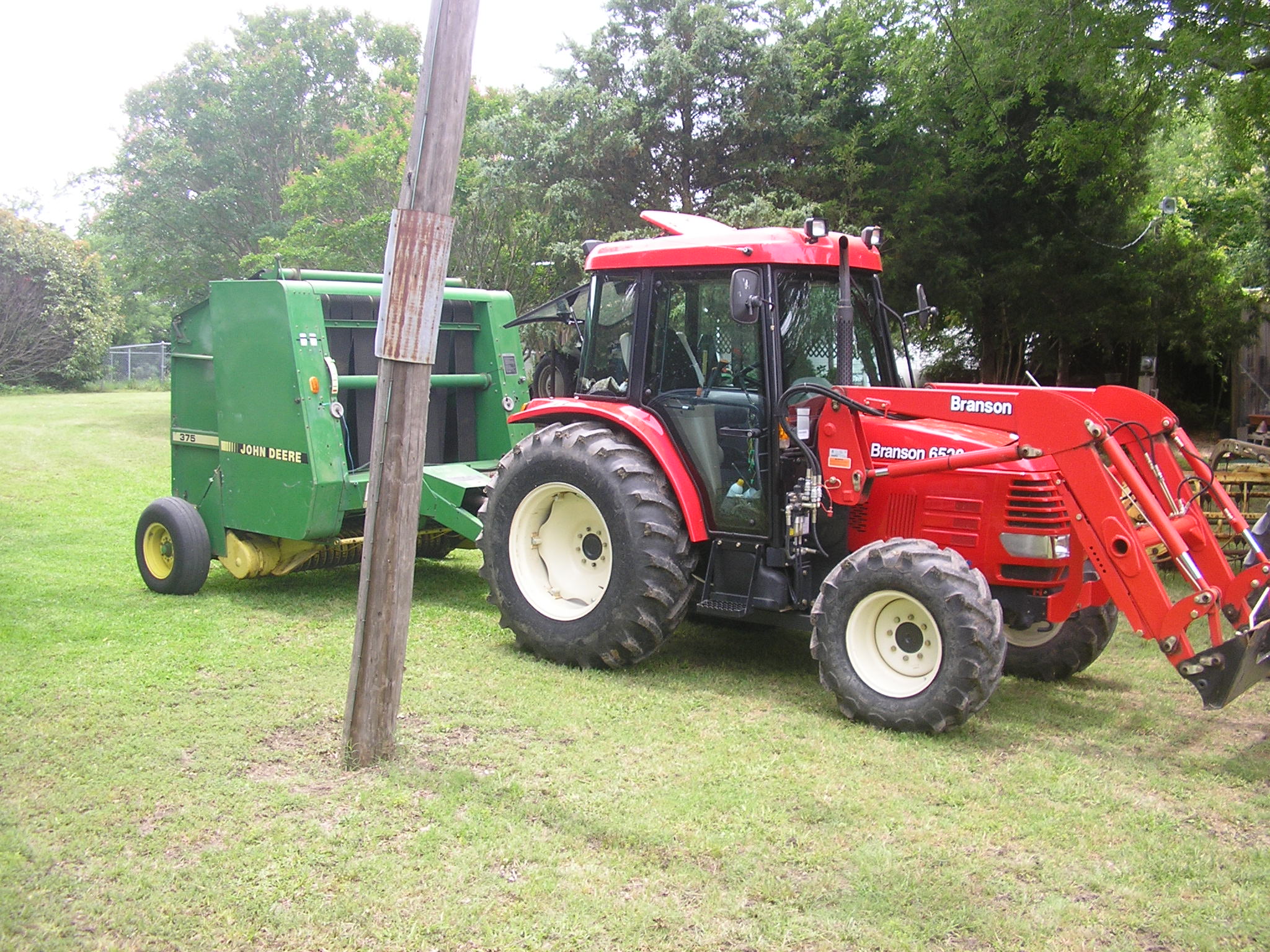

I have a '91 JD 375 that rolls a 5x4 bale that weighs in at around 650 up depending on moisture content. The baler is based on JDs 5x6 chamber but is smaller, stops at 4' diameter, and no electrical connections to the tractor.
I don't have any problems with my tractor even baling this (see inserts) and don't hear it grunting unless I get up over the full mark and start crowding things...like up at 4 and a half ft. diameter, with meter in the red. All monitoring is self contained on the front of the baler and you can see it from the rear view mirrow. No interconnecting cabling. My little 2000 can 3 pt the bales with no front end weights.
For FEL hauling, the narrow width makes it easier to see around than a 5.5 or 6' bale design, like a JD 465 type bailing a 4x 5.5-6'. Bought the baler at auction around 2009 for 5K. Had to replace nothing at time of purchase. Only parts required so far are roller bearings which were readily available and I replaced myself, working alone. I did add a 0-5000 psi. oil filled gauge inline with the gate cylinders to monitor bale pressure after discussing bale rolling pressure with TX. Jim.
