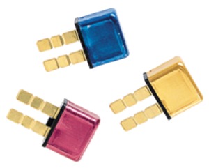

Question 1: is on the controller wire, "use a 30amp resetable circuit breaker" I can't find anything locally for this, Lowes, Walmart, Autozone. Where can I order one online?
I don't mind using fuses, but this would be an extra nice thing to add if not expensive. Saves from having spare fuses all the time.

<font color=blue>Question 1: is on the controller wire, "use a 30amp resetable circuit breaker" I can't find anything locally for this, Lowes, Walmart, Autozone. Where can I order one online?</font color=blue>
When you buy the controller I've found most vendors insist you buy the circuit breaker or you have no warranty on the controller.
You might try U Haul. They install hitches and controllers so they have to have the circuit breakers.

Advance Auto Parts Breaker (see attached)

Inspector507, I found the resetable circuit breakers at Advanced auto Parts! Sweeet! Thanks for letting me know. got one 20amp for the light converter, a 30amp for the brake controller, and 30 amp for the RV charger wire. They were $2.84 each. Jim, thanks for the links to the picture, I never knew they looked like that! Wroughtn_harv I did check out an RV place $4.95 a shot /w3tcompact/icons/shocked.gif yikes... Will do the silicone thing thanks!
