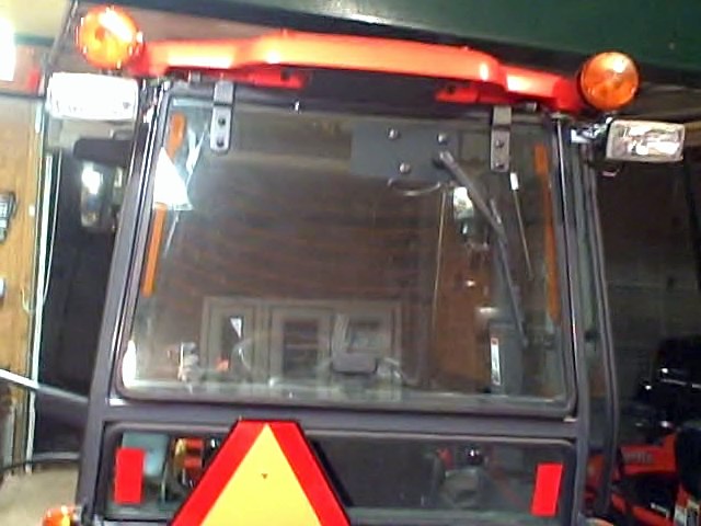

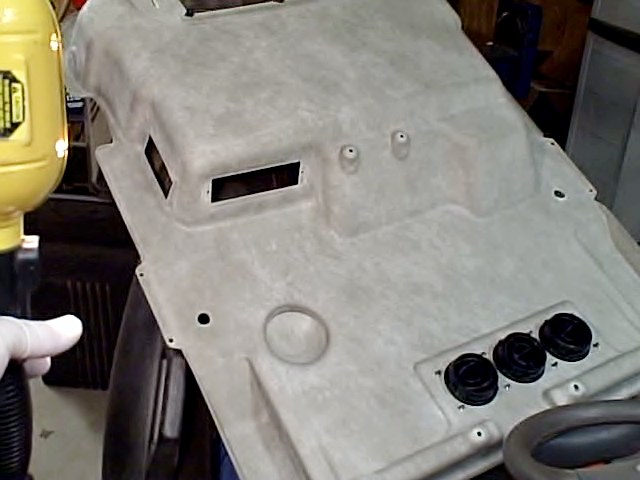

I installed the factory rear work lights for my B3030 and I'm no big time wrench. I had to remove all the ceiling retainer buttons, by pushing in the center to free them. Then I had to remove the face around the fan/heat/ac control and a couple of vents. Once I had the ceiling free, I passed it out the rear window. Go slow, and you should have no problem. Ductape did a similar project on his B3030 and give some good infor and pictures. It helped me. You might want to do a search for it. Here's a few of the pics I took of the process.
Good luck.

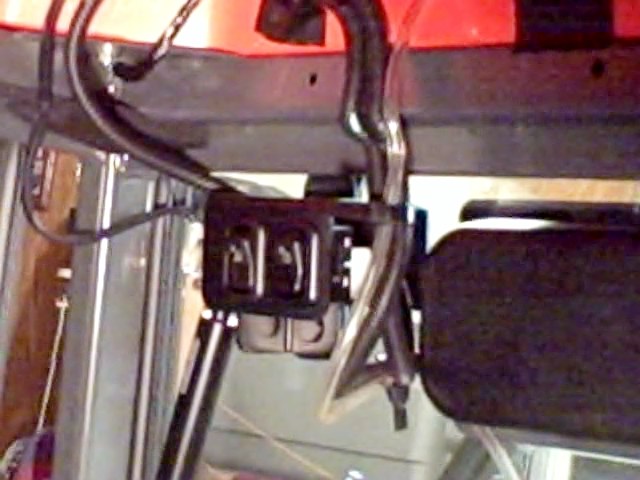

Here's a pic of the rear light switch before the headliner went back up. Forgot to include it earlier.
