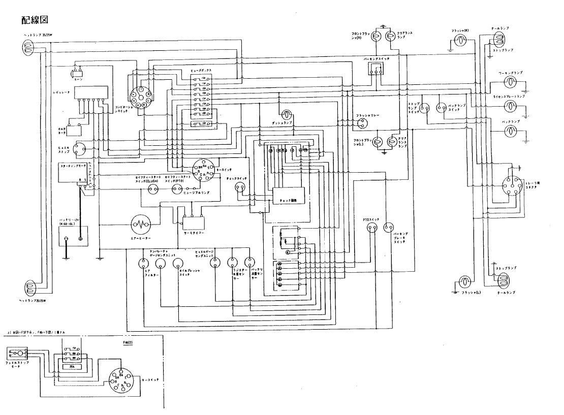

Does anyone have a wiring diagram of an F series grey import, specifically an f37D or close, that has an 8 terminal fuse block rather than the standard 4 fuse block ?
The diagram would be a big help rather than pulling all apart to trace wires everywhere.
thanks in advance

I believe these are the tractors that everything that is known is in Japanese. I know this is true for the FX models and am not 100% sure it holds true for F models. So while you can follow the diagram if the end point is written in Japanese that will do you no good.

Thanks so much for the reply. Luckily I do have a contact in Japan who I am sure may be able to translate. If I can get the translation done then I could post up for future reference for others.

Well then it may be possible. I know most people can not read Japanese or know anyone that can, once they learn everything is in Japanese they end the search usually. Hold tight, someone may be able to post something useful. There was a site somewhere in like Russia that had a ton of manuals listed for free download. It was not a bugged site as many of us used it and played around with it. I didn't save the site but I know California and maybe Winston may have the link to it. That would be a good source to start with. Hoye may even have a parts manual or manual if he would be willing to track down if available the page you need. I have seen him post certain pages for others with a specific request before. (Disclaimer they may not have it or the time to post it, just saying it may be a possibility)
   / wiring diagram wanted for a F37D Big Forte (has 8 fuses in fuse block) #5
Here is the F37 wiring diagram. Hope it helps.
