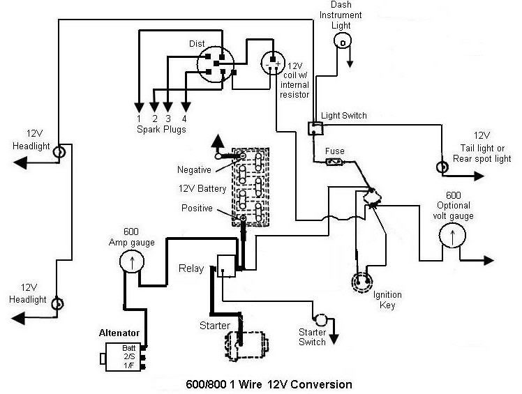

Tractor used to start fine. the other day it wouldn't start and I noticed a wire was loose. Not sure but think it came from the small terminal block that holds wires from ignition key, relay, battery, light sw, fuel gage. I would like to rewire as several wires are old, cracked and need to be replaced. Tractor is a one wire 12 V conversion. Is that just a terminal block or some kind of electrical component?

Soundguy. Thanks. Yes, it does have a fuel gage. I was saying an 800 series tractor as that is what I had seen on the metal plate on the front of the tractor. I didn't know if it was an 801, 802, 860 or whatever. Not up on the different types of tractors. I will try to read the serial numbers a little later and do some more learning. I have to be away for a few days and will post later in the week. I was able to get it rewired to some degree. It starts, runs and I can get it off the trailer. This is what I needed for today. I was able to clean the terminal block and reuse it even though it was so dirty and rusty I didn't have much hope for it. I also replaced the light switch, a pull on push off switch. Like I said the wiring is in such bad shape I just want to replace all the wires. I notice there are different colors and some with tracers on them, such as black with white tracer and I would like to replace with original color code wire if possible.
Do you have a link of where I can find wiring diagrams. Perhaps I need to post the serial number and then maybe you can help me find the correct wiring diagram.

   / wiring diagean 800 series ford 1956 needed #4
HTH
Dollar Bill Thanks. I believe that is exactly what mine looked like except it had a ceramic doohickey just before the coil.
   / wiring diagean 800 series ford 1956 needed #6
The ceramic doohickey is a ballast resistor. It allows full voltage to the coil when you first crank it up and as it heats up, it will reduce current flow to prevent overheating the coil - As you'll note in the wiring diagram, it calls out a "No External Resistor Required". Whomever did the 6V-12V conversion, probably left the original coil intact and added the dropping resistor. I recommend you replace it with a true 12 volt, "No External Resistor Required" coil and delete the ballast resistor. The NAPA part number you're looking for is IC14SB.

ditto that on the coil / resistor. much better setup.
