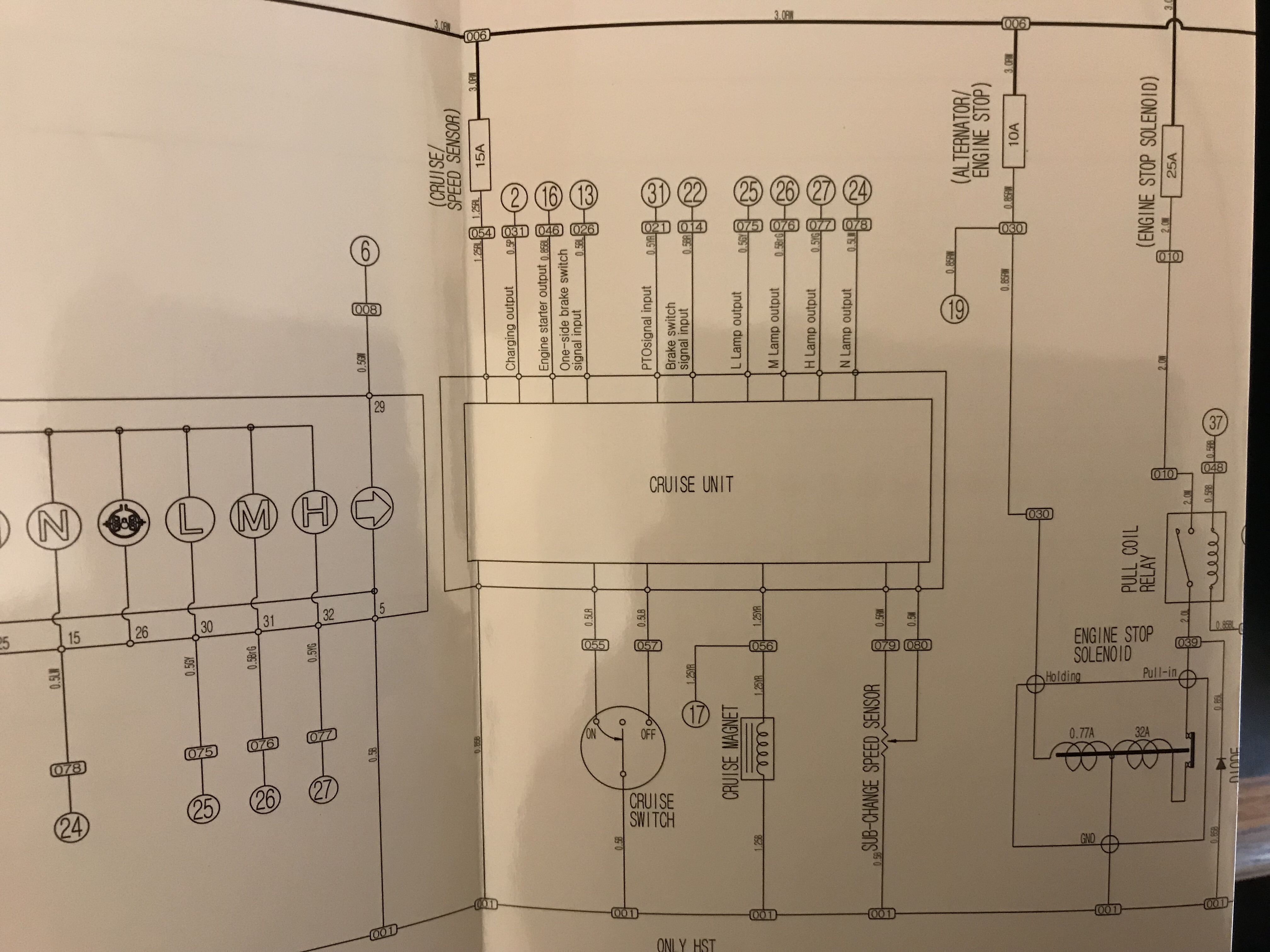

i think theres more at play than just that. theres actually a cruise unit module . it has a bunch of input and output circuits. it looks quite complicated . but who knows.... maybe you only need a magnet and a position switch. you wouldnt want both magnets to be energized. IMG_2974.JPG
not sure what a sub change speed sensor is and whether it would work in reverse

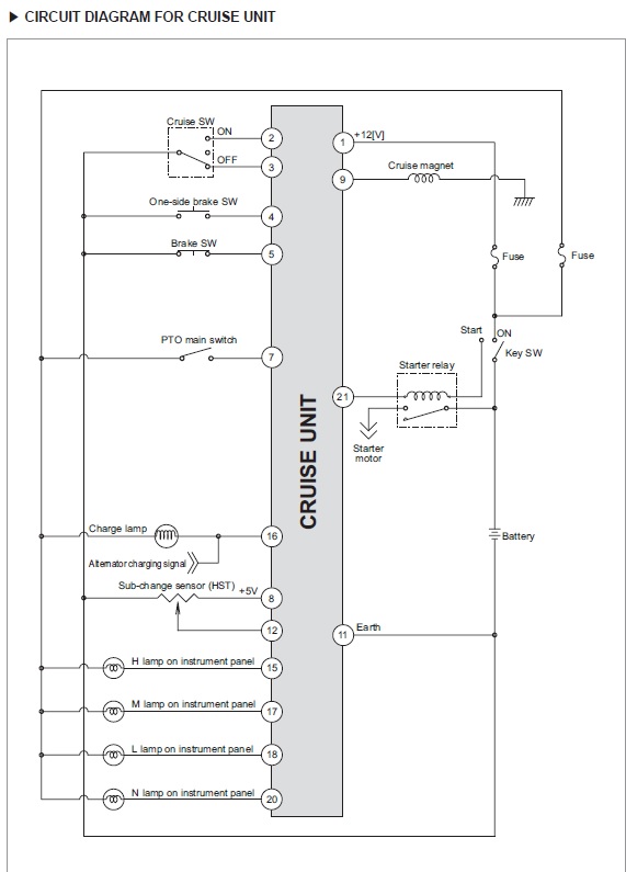

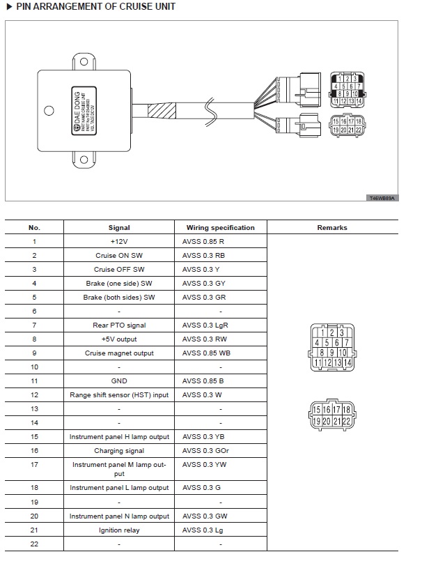

The Sub-change speed sensor is the range shift sensor for the HST tractors, pin 12 and 8 of the cruise unit.
But I'm not talking about changing any of the pin arrangements or splicing any of the interlock wires, none of which should mind if you are going in reverse, so long as the interlocks are met.
Interlocks, going around the diagram in laymen terms;
Pin 1 *12V power supply
Pin 9 *cruise magnet plugged in
Pin 21 *Engine started
Pin 11 *No Earth Faults
Pin 20 *Lamps Working
Pin 12, 8 *Range lever staying in position
Pin 16 *Alternator charging as usual
Pin 7 *PTO indication staying Engaged or Disengaged
Pin 5, 4 * Brakes disengaged and coupled together
Pin 2, 3 * Cruise control switch in the "on" position
I'm simply talking about moving the magnet physically, or installing another, where only one magnet will be activated at a time by a switch. I certainly don't mean to force this on anyone, just an idea. And I agree that a bit of caution is always a good thing.
