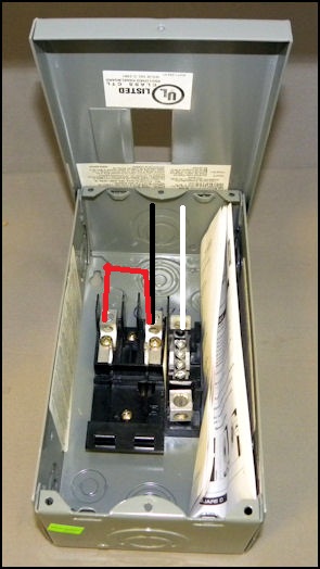

Hi,
I'd like to add a sub panel in my basement to run a couple of curcuits to my garage and one or two extra circuits to my basement. Problem is, the main box is in a finished part of the basement and there is no easy way to run a new line from there to the unfinished part.
However... I have replaced the electric dryer and electric stove with gas units, so I have to 30 amp lines already run very close to where I would need them. Problem is, they are both 3 wire lines (need 4 for the sub (2 hot, ground, neutral).
Question: Can I use two wires from one line for the hots and two wires from the other line for the neutral and ground? Seems to me that it would be safe. Any issues?

Do you need 220V at this subpanel?
What if you used 2 separate sub panels and just ran 110V to each one, or ran one as a 110V subpanel and one as a 220V welder outlet??
You have 3 wires which are all you need for a 110V sub panel and you can get 30 amp single pole breakers... Easier for the next person to understand it that way.

How many breakers do you need on each panel? I would get something like: http://www.amazon.com/dp/B000H5WMSQ with 2 tandem single pole breakers (such as http://www.amazon.com/dp/B0002YSOMA/ or http://www.amazon.com/dp/B00002NB37/ ), then I would wire a jumper (with the same size wire as your feed wire) from one leg to the other inside the breaker panel. and mark the panel as 110V ONLY. That will give you 4 circuits out of that box.
Here is more or less what I am talking about:
You will need to add a ground block as that panel doesn't have one, but that isn't a big deal.
Thinking a little more...
So get rid of the 2 pole (30amp 220) breakers and get single pole 30 amp 110 breakers. Then use each 3 wire line for a small sub panel... I like it, one for the basement and one for the garage :)
Exactly.

In general this is a very bad idea. There are provisions in the NEC for taking this approach -- especially with respect to paralleling conductors for high ampacity applications -- but having the hots separated from the neutral and ground in a residential application? I have to read some more of the NEC.

Thanks for all of the feedback.
No, I don't need 220v at the sub panel.
The garage is attached.
I don't have the new sub panel yet, I will buy the correct one once I have a plan.
I was looking at my wiring over the weekend and found the curcuit for the range is a 40amp running over #6 wire.
Here's the subpanel I'm looking at:
Description says it has a neutral bar and a ground bar (I will make sure they can be separated).
70 amps, 2 slots, 4 circuits, single phase.
I'm thinking:
One in the garage with a 30A feed to run one 15A for a fridge and one 20A for tools.
One for the basement with a 40A feed to run two 15A for lights and small tools and one 20A for the table saw and drill press (not at the same time).
70 Amp 2-Space 4-Circuit BR Main Lug Loadcenter Includes Ground Bar-BR24L70SGP at The Home Depot
Not quite ready to pull the trigger, but getting more comfortable with the idea.
