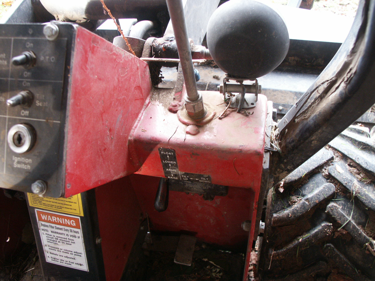

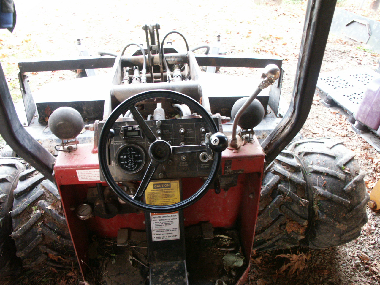

In another section here, Moss and I were discussing how to protect wires for lights. My method that has worked so far is using caulk to cover the wires. I use black caulk, and high grade stuff. After 2 years it has still held up OK.
Here are some pix
Oh, methodolgy. I did like 18" sections. I taped one end down, then the other, making the wire tight. Then I applied a LOT of caulk. Let it skin up a bit, then covered it with paper tape and let it sit overnight. Peeled the tape off and bobs your uncle. I think in high UV situations this will fail. Oh, I did it with the ROPS dry and warm.

Looks like that would work well.
I was going to drill a 1/8" or so hole at to and bottom of the ROPS, but then it occurred to me that if there were something that could damage the wires on the outside of the ROPS it could also damage me.
So this indicates that you're a safe operator as two years haven't hurt the wires!

Thanks. I now see that your ROPS tubes are not round tubing like mine. I think your method would still work. I will have to consider it. :(

When I did the wiring for my electric sprayer (see avatar) I used stick-on wire/cable guides. When used with Marine Goop (UV stabilized RTV adhesive/sealant), they don't come loose, and also allow me to remove the wires when needed.
For permanent installs, I think that the method above will work fine, although it might look a little messy in my opinion.
-Rob :)

Looks terribly messy. But for me the machine is a tractor and I am not too caught up on asthetics at this point.

I zip tied a wire for my overhead lights to the side of the ROPS tube facing into the driver's station, thinking that would protect it.... it didn't. It was ripped off shortly. I go through a lot of thick brush... :(

Then perhaps a piece of rigid tubing hose clamped to the upright, used as conduit. The vinyl tubing is brutal to pull through. 3/8" pex might work well and is extremely inexpensive.

I was thinking more along the lines of bending a 1/2" I.D. pipe to match the curve of the ROPS tub and tacking it to the ROPS with a MIG welder. I really need the armored route for the wires.
