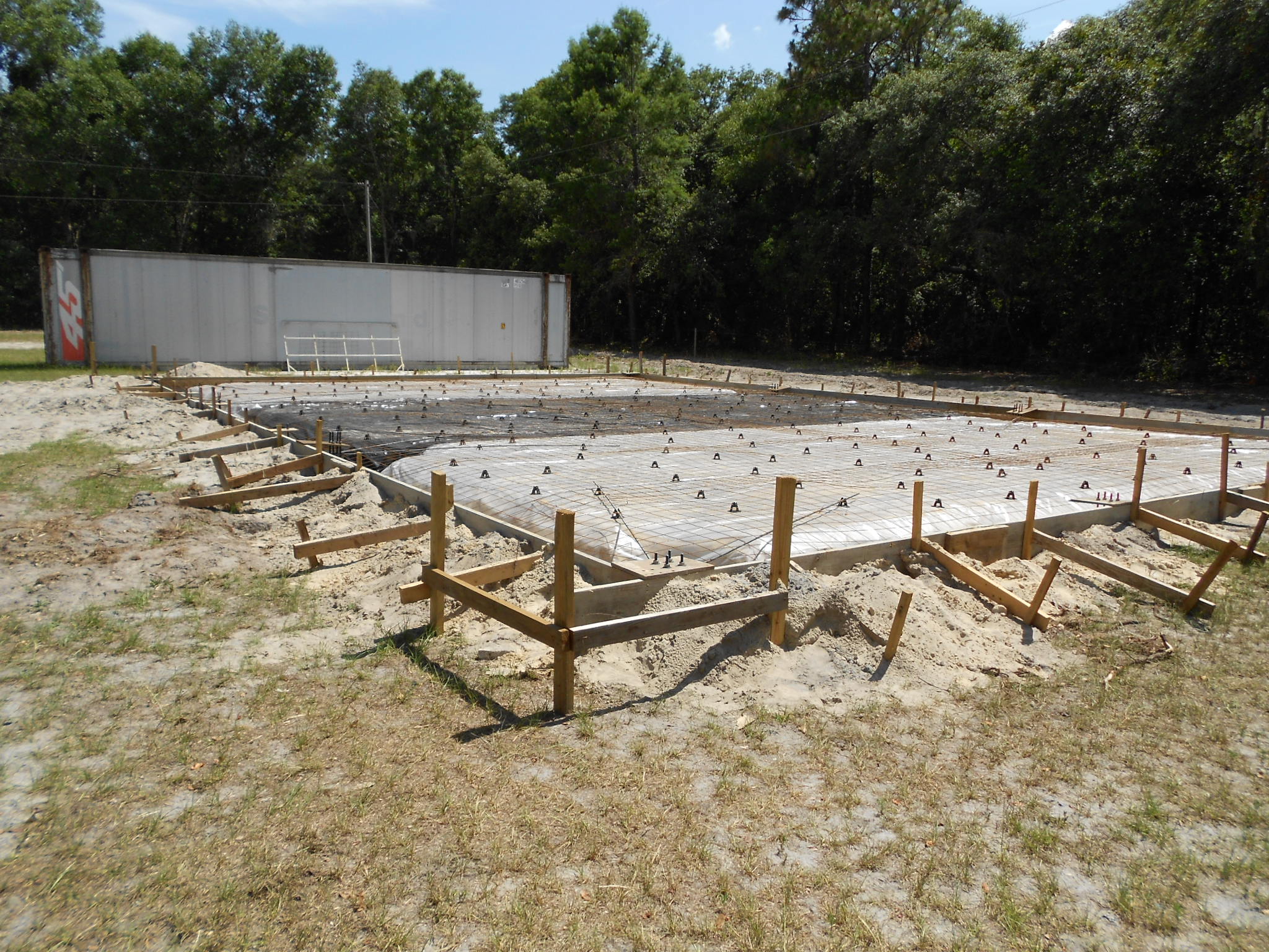

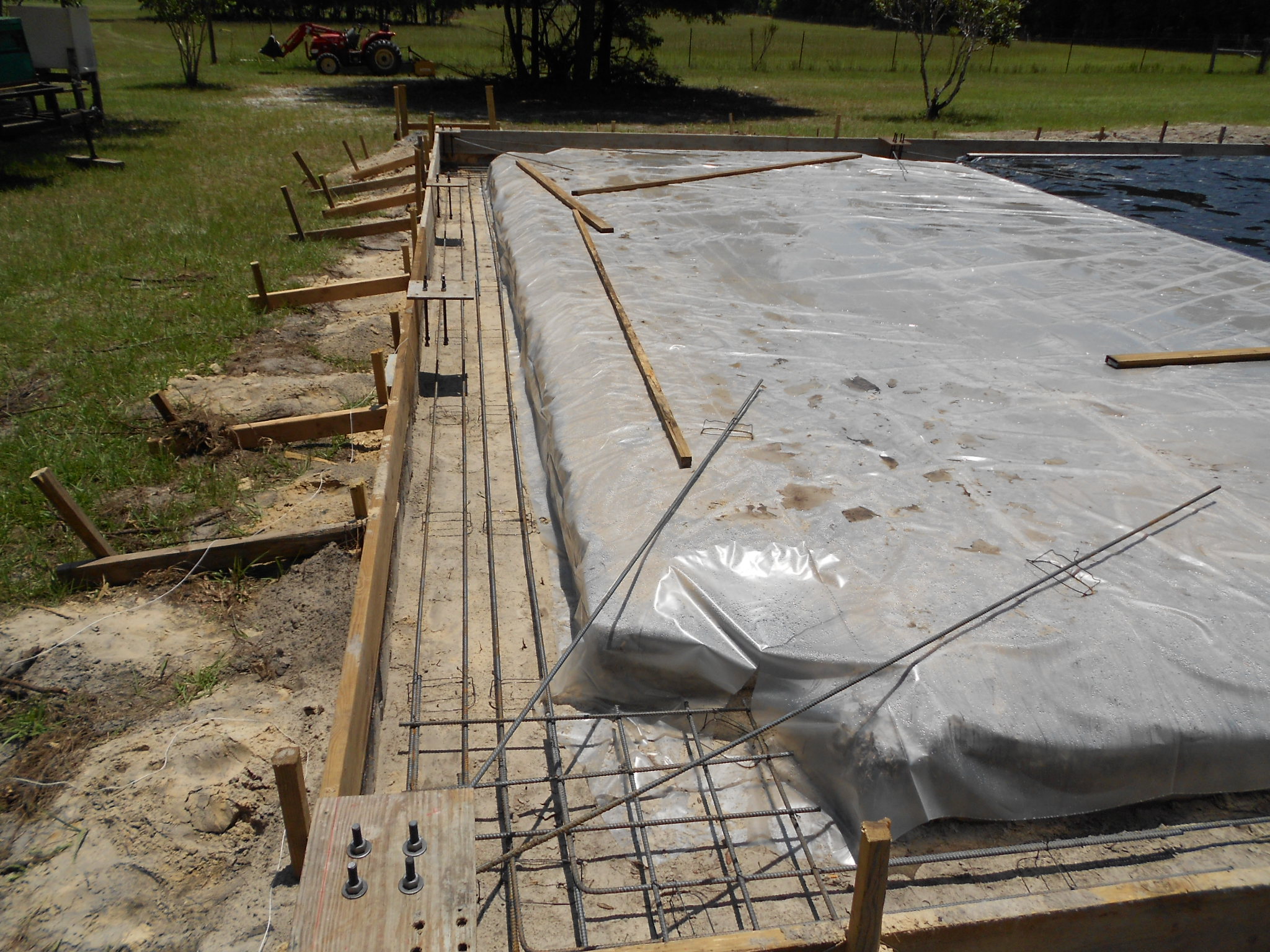

Here was the rebar/wire in my 40 X 60 building.
