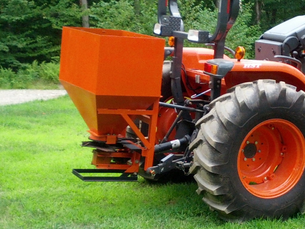

I bought this used. It is lined on the inside with 3/8" plastic of some sort. I use it to put down sand salt mixture maybe once or twice a year when the drive gets a coat of ice and turns into a toboggan run. I run it on the back of a 3710. Sometimes have to back up the drive which is a steep clime of 1/2 mile.
Real PIA when I have to rig it, fill it and use it, but nothing else fits the bill unless I call out the sander truck. For as infrequent as I use it, it is the best all around solution. I keep about 100 gallons of mixture in the barn in 5 and 30 gallon pails. that way it is always dry and NOT frozen, when I need it.
I nearly sold it a few years ago to a member here who lives on the other side of town. I have used it several times since, and own it cheap enough i am very happy to still have it. Re the spinner comments: at the end of the season, I empty it, store it upside down in a barn and douse the spreading mechanics with used motor oil..... no problems.

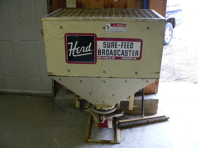

I've got a herd 750s spreader. Found it used for a real good price because someone left fertilizer in it and it was rusted. I replaced a number of pieces, the steel "box", both input and output shafts on the gearbox, the aluminum spreader and bottom flow control panel, and one u-joint. Even with all that work I'm still in it for less than $600 and it's painted orange with Kubota paint. It has a agitator inside it that bangs around to help knock loose anything that's frozen. Even with it straight sand sometimes still freezes. When possible I try to mix in a little salt. One thing I can say is it's almost too small for my 4240. If I was to buy one I would go a size bigger.
