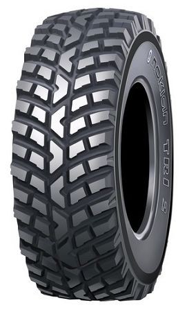

I'm thinking of trying these for the factory replacement (fronts) when it comes time. They are not cheap but if there service life is a little longer without a terrible loss in traction in the dirt and better in the snow?.

I wonder if this is the tire coming with the tractors the op is talking about? These tires are made for snow and sandy terrain. I think Rusty that if you did not want to run front chains and relying on these tires as a compromise, nothing is going to give you better traction than the chains you currently have for snow work. Ironically, it's the snow that sticks between the lugs that provides the traction but chains are like talons. Snow meeting snow is kind of grippy and is why turfs do well in snow. There is a tire company called "Alliance" that produces a very similar tread as the Nokians. Do not know if they would be cheaper however.
