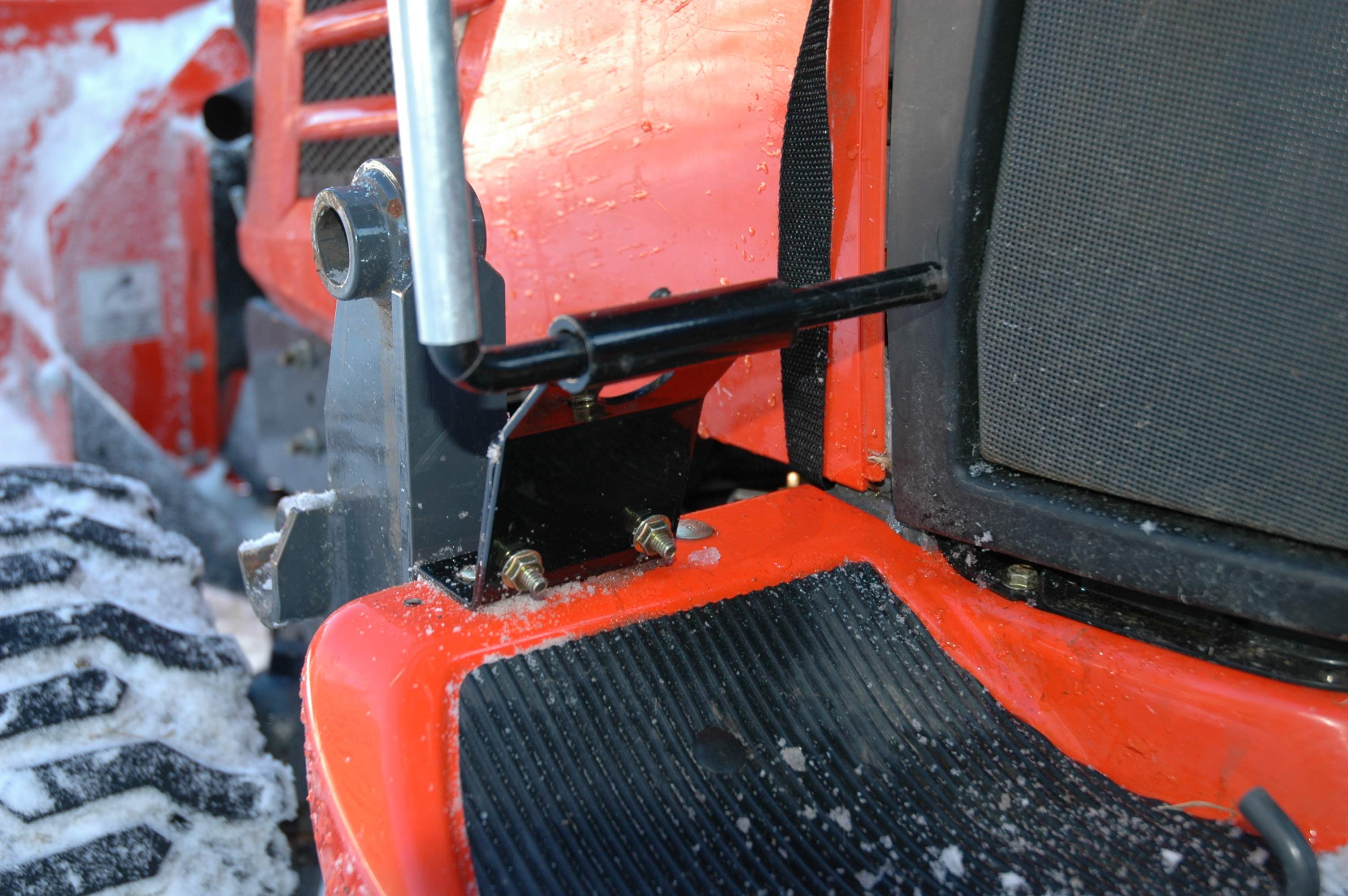

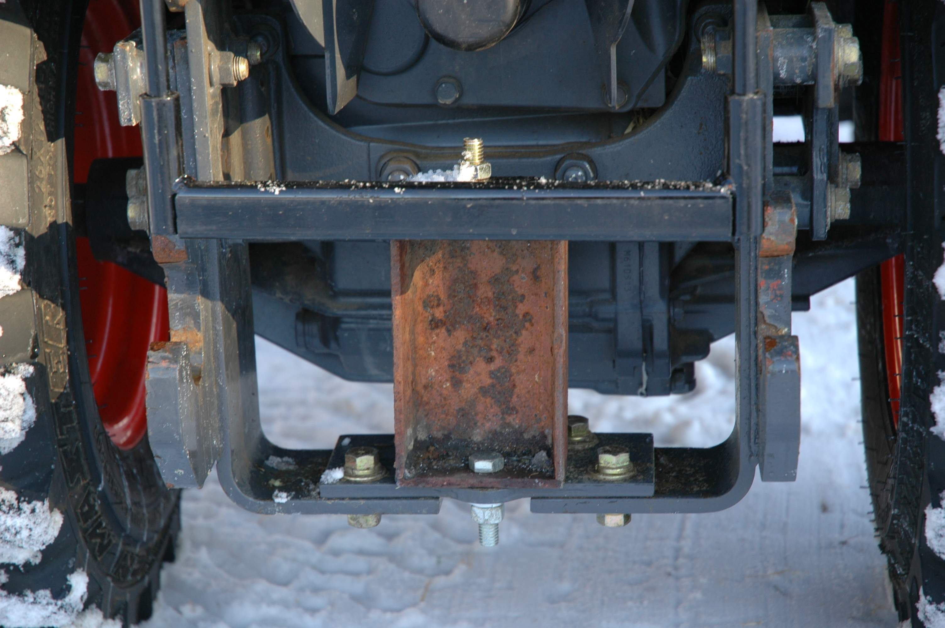

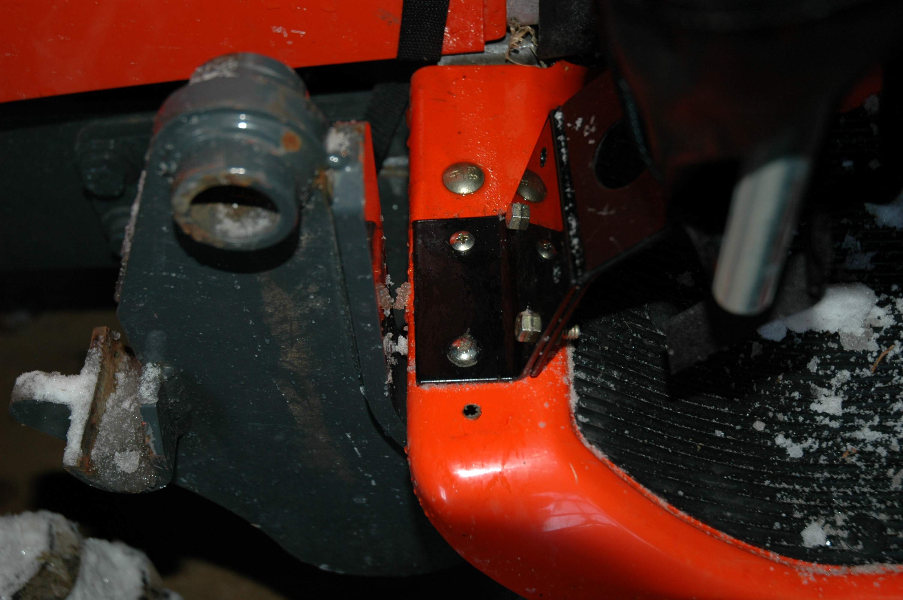

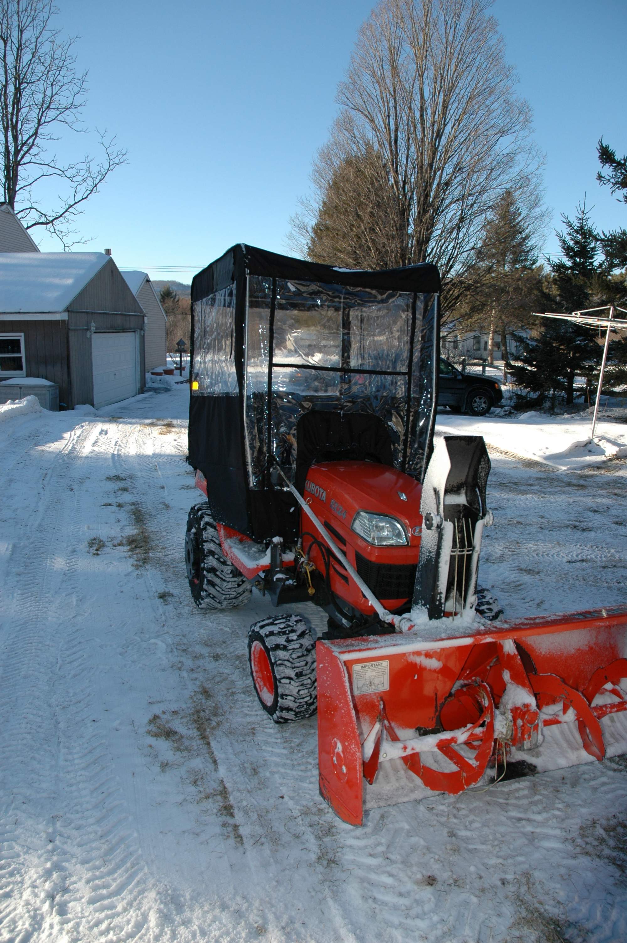

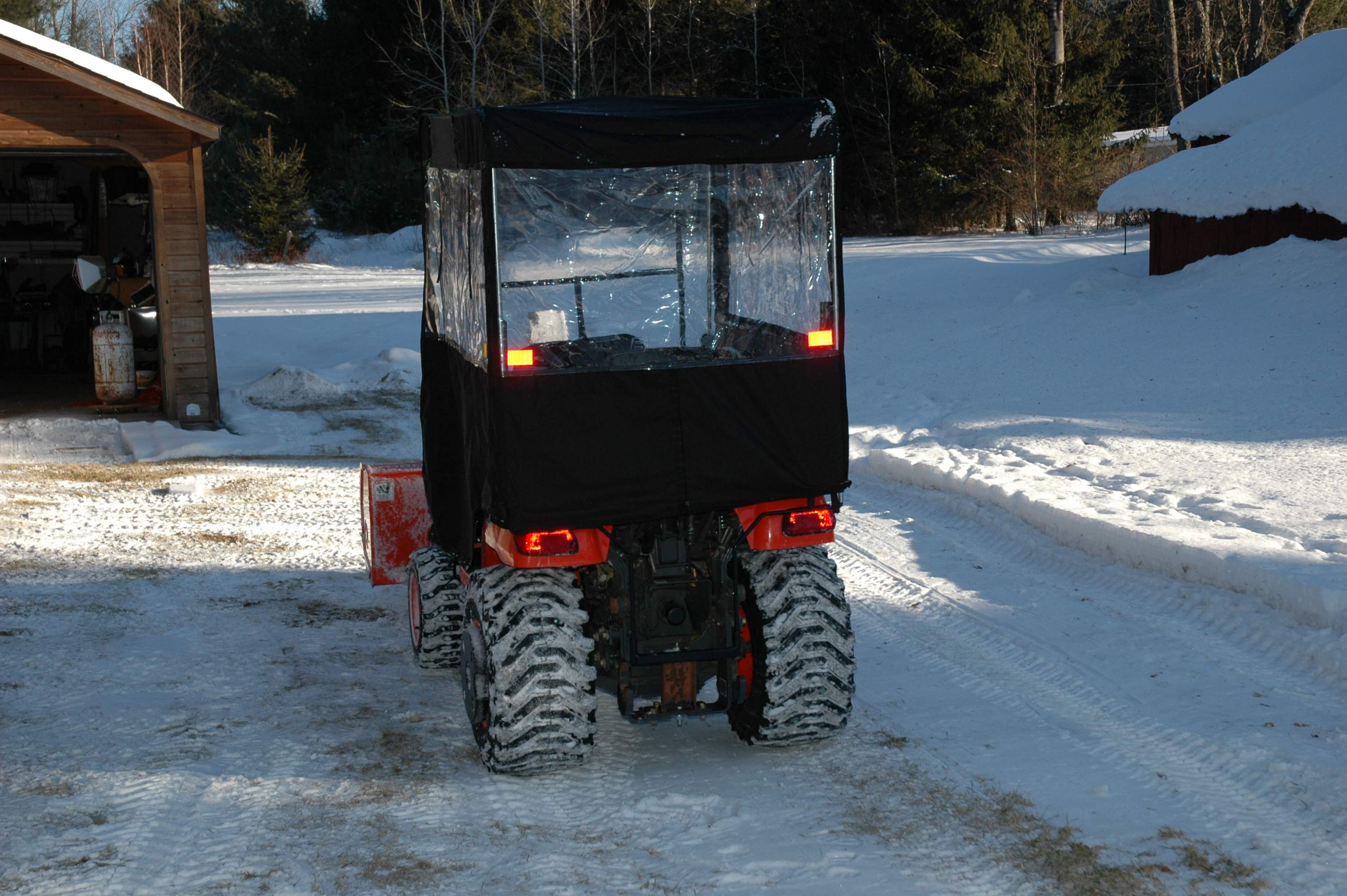

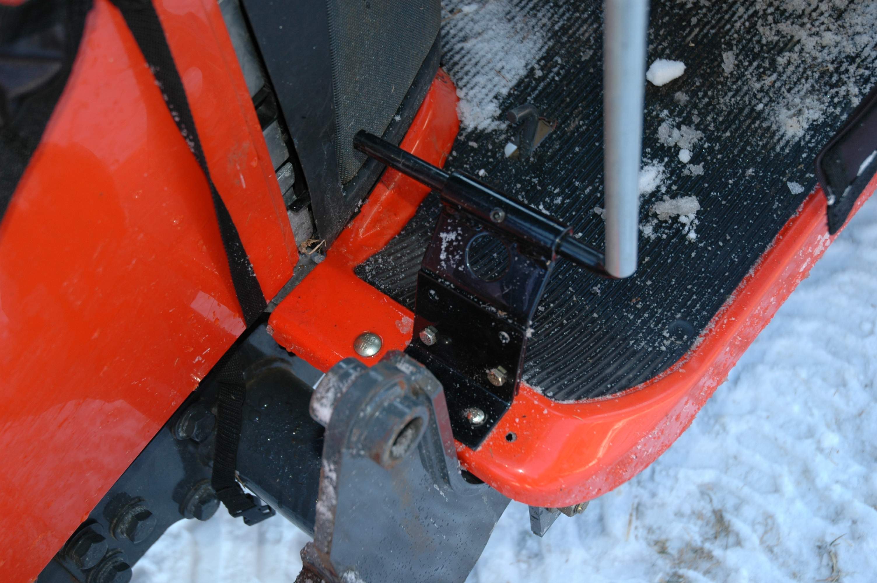

Bercomac makes a simple and low cost winter cab that will fit the Kubota BX24 with some minor mods. I got the 40" from my local dealer and within about an hour of mods and it was on and I was warm (relative) dry and happy.
The cab is simple and well made.
I raised the back so the lights could be seen and modified the front attachments so it would work on the Kubota and not get messed up in the frame and lift kit.
I will cut down the front tubes to get the doors to fit better, but it is great for now.
I would suggest that they create a pocket for a SMV emblem on the back.
Also I used Gaffers tape to close the screen at the top of the cover as I wasn't getting fumes but a fine dusting of snow blew back. It is not air tight so I am not worried.
