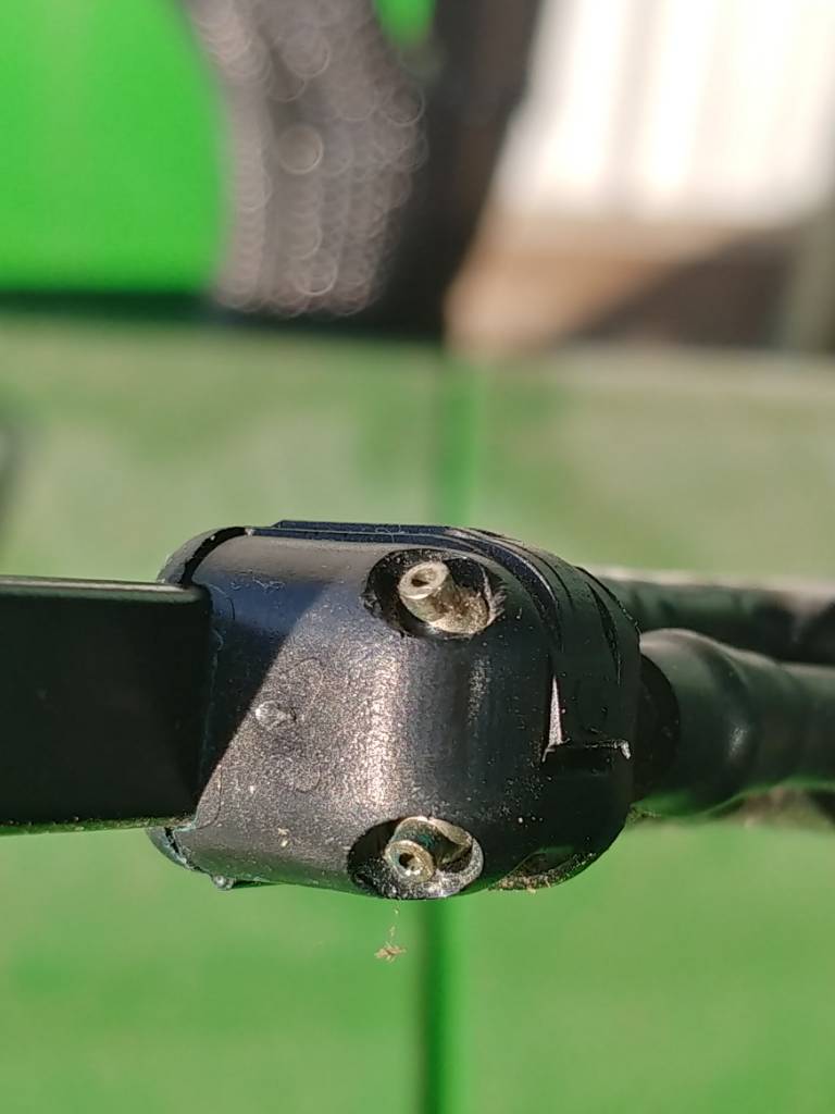

This may have already been posted before but I'll post it again just in case it hasn't and for those that might not know this.
I've seen posts and I think comments in youtube videos about the inadequate spray of the windshield washers - that is poor direction that does not cover the windshield wiper sweep. The solution is the little spray nozzles are spherical and their spray direction is adjustable. Takes a little trial and error to get the spray just right but works like a charm.
Trick is to asjust one nozzle for the bottom half of the wiper blade and the other for the upper half.*

Thanks for that bit of info. Mine seem to be doing OK - but it's always good to know they can be adjusted.
