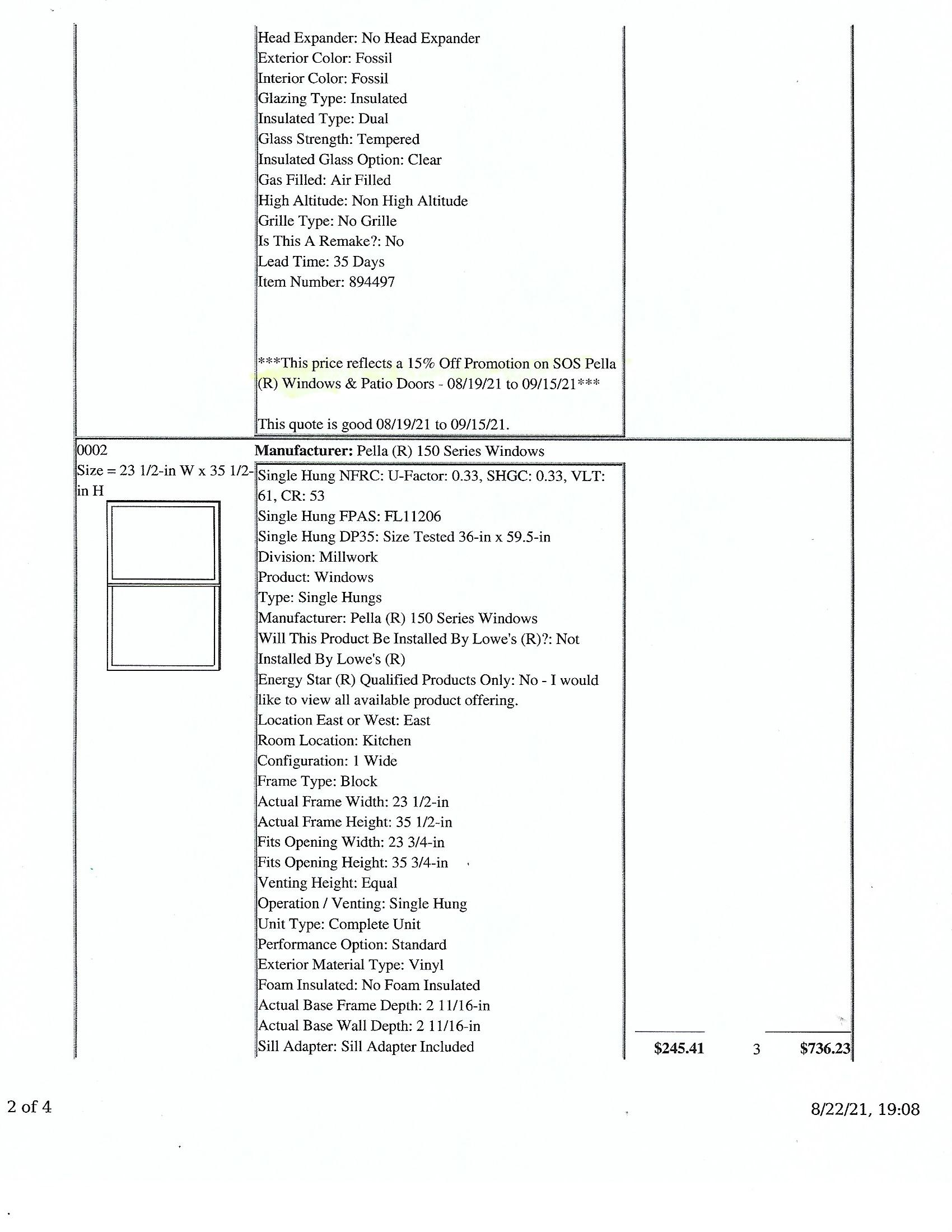

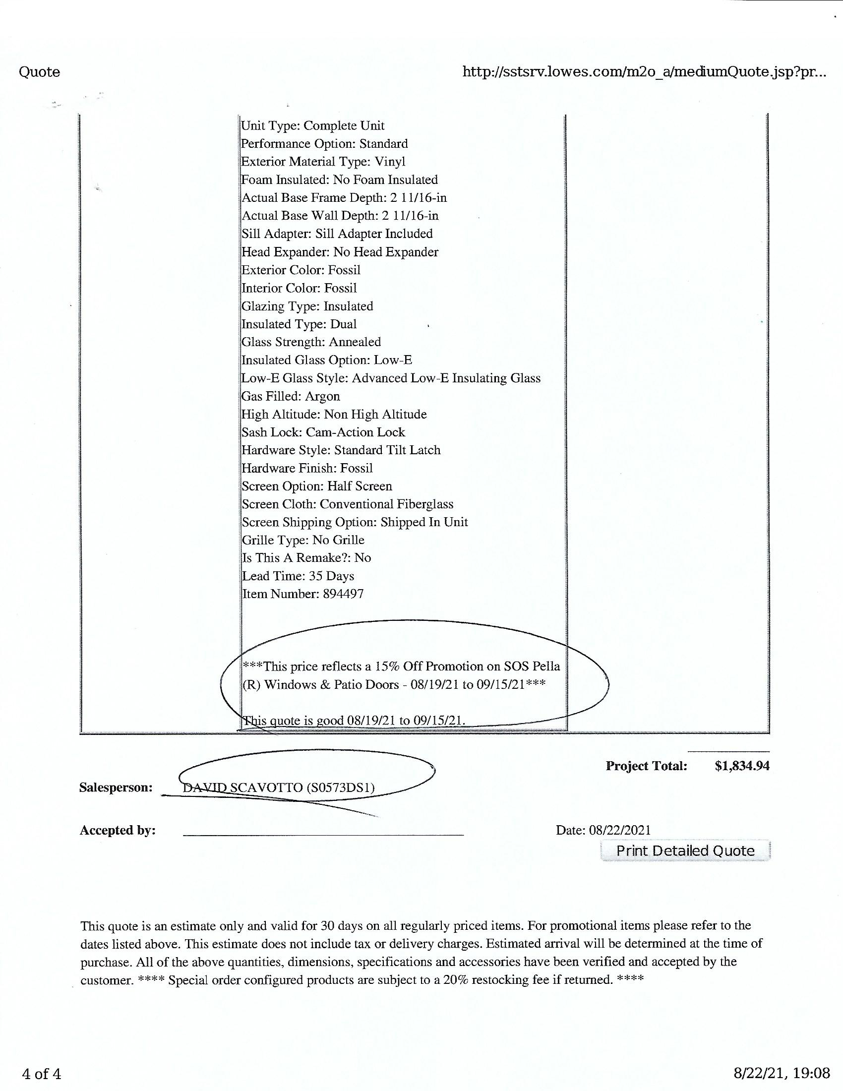

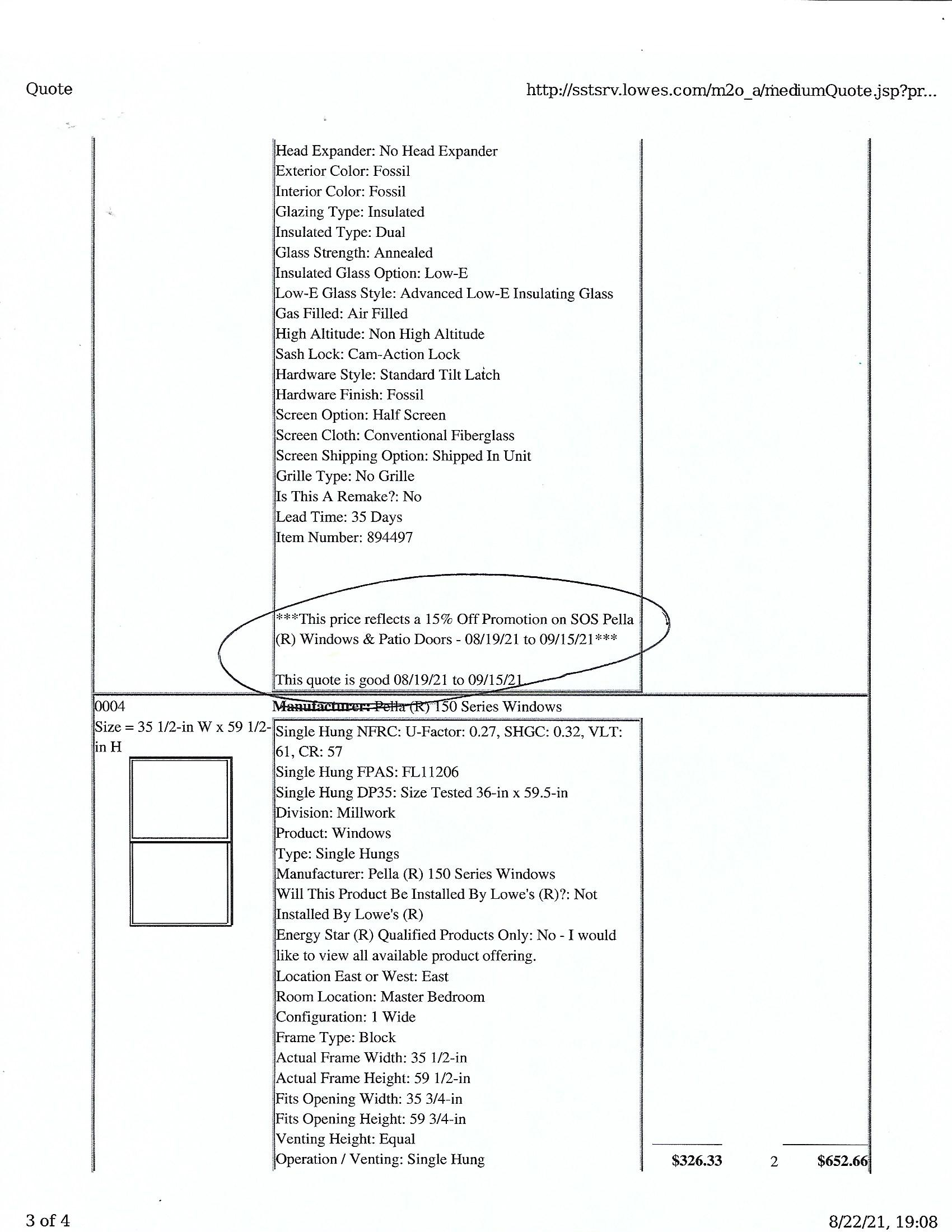

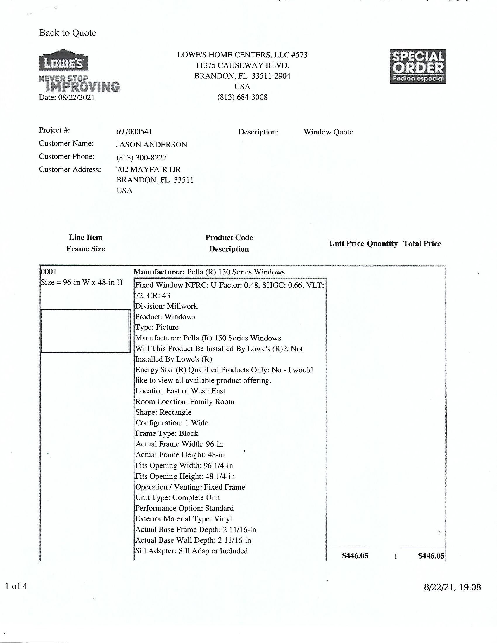

Thanks for the tips, advice, experience. I would prefer to deal with a local limber outlet but the price difference is VERY substantial. My biggest fear is purchasing windows that will not pass code, as far as I know you typically cannot buy a window without a Florida approval code but I have heard stories where a window or door was purchased and the approval code had expired and was basically useless.
My smaller windows will prob never be an issue but I have one very large picture window that concerns me.

It's been a little while (years) since I worked with code compliance so keep that in mind- Each room will need an egress window that has at least a clear opening of 22" for fire code. Depending on the width of the window frame around the movable glass you'll need a window wider than that and the bottom can not be more than 36" off the floor. You also have wind codes that you'll have to comply with. With you being in the Marion county, you're either in the 100 or 110 mph wind zone. Once you pick the windows you want, get the NOA (notice of acceptance) number off the window sticker (mfgr should have this on the window sticker and should be able to provide this ahead of time) and then look up the number and that should tell you what the expiration date of the NOA is. ( This is from my wife who worked at an architectural firm on the Space Coast in Florida).

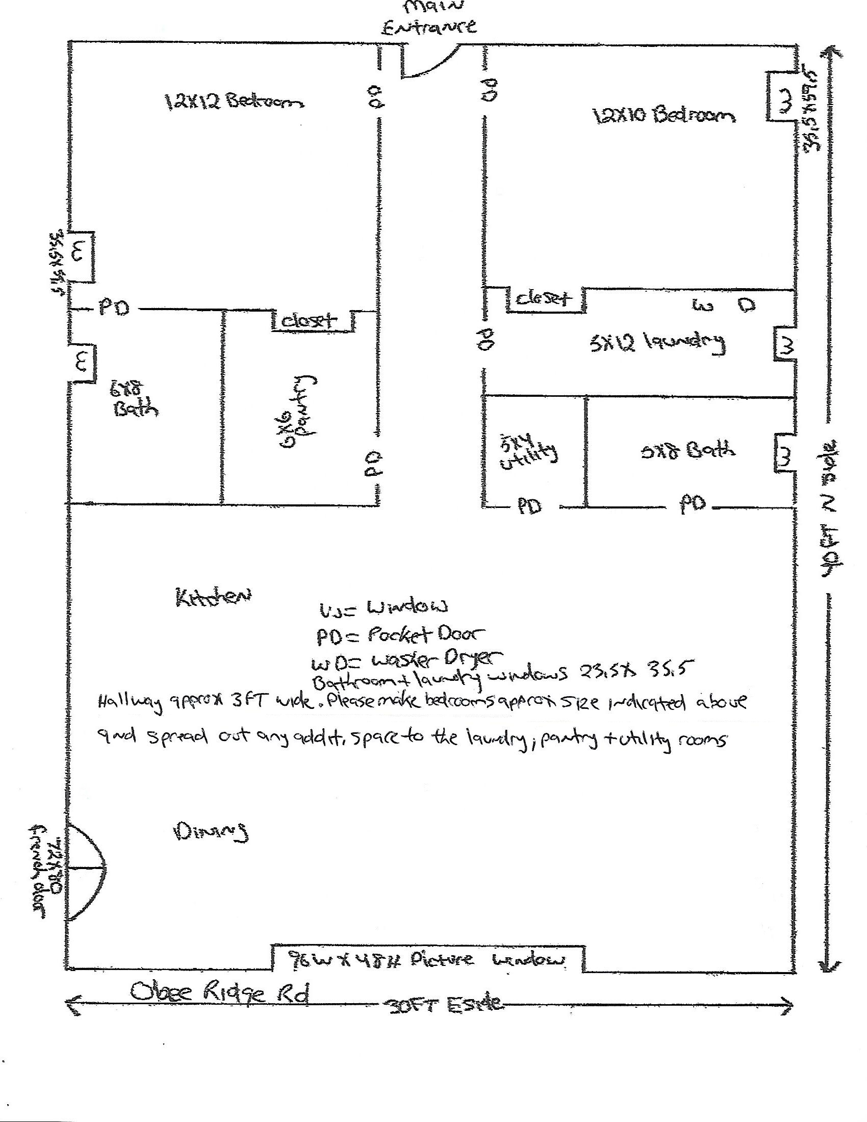

Can you tell me if you see any issues with the information below. I have a meeting with architect on the first of next month, Ive been waiting weeks just to get this appointment. I dont know how many more weeks after the appointment Ill have to wait just to get some drawings and submit for permitting.
Im trying to streamline things. Thanks

Is there anything else that maybe I could submit to help make his job easier and cost me less money that he may charge? Thanks
