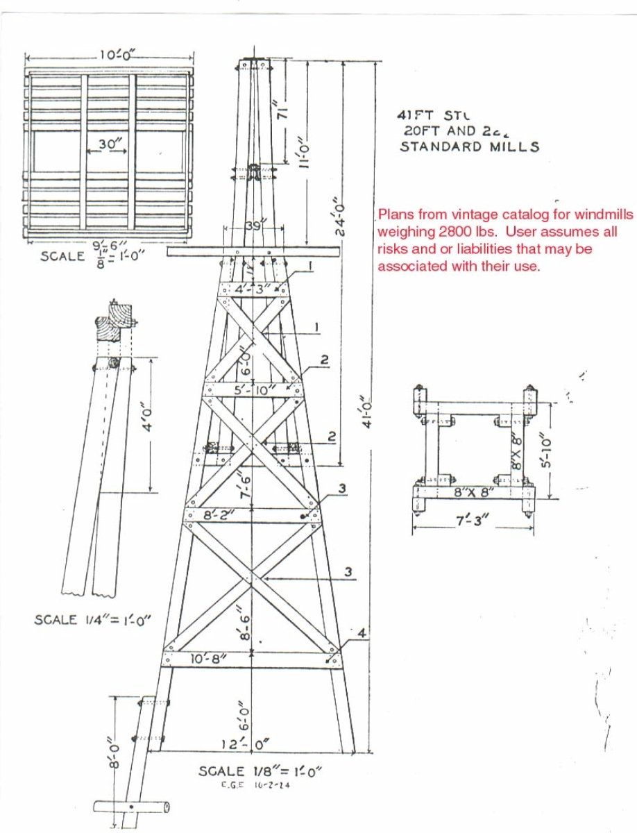

I have a 8' fan and pump from a windmill that was taken down years back. I straightened the fan blades and filled the oil galley with automatic transmission fluid. I have it on a 9' stand temporarily just to see if it would require additional work / repairs. It has been turning for two years without a problem or oil leak.
I want to construct a tower approximately 12' high adjacent to my house. As the unit itself weighs approximately 350# ( yes large cast housing + fan ) I am wondering about under ground reinforcement, tower size ( would like to use a single steel beam ) with a ground plate system to level it. Single beam system would work best for grass cutting and space. No ladder for climbing also a plus to keep adventurous people looking instead of participating.

Don't have any engineering help for you, just a thought - weight support is going to be MINOR compared to side loading from wind... Steve

Aermotor, Baker or other? There's plenty of old towers still around (as well as new avail) that you could cut down to shorter heigth. No matter the make, it should have a high wind override that will kick it out of the wind in heavy winds. Also, obviously take it out of gear when heavy winds are anticipated.
We've set-up, taken down, restored numerous windmills for pumping water over the years. It's amazing how many are still around that are simply overlooked.

That is what got me to thinking was the side load pressure. Although it would not be high off the ground and in a secluded area that amount of weight shifting around may cause problems. I guess it is 20' angle iron time with some reinforcements / braces.

I would think a 4" pipe would do you well set it about 5 foot deep in concrete,
if wanted one could weld nuts on the pipe so one could put 6" bolts in the nuts and make a ladder that could be removed, to keep little monkeys at bay.

Its a Duplex windmill head. About twice as heavy as a aermotor as I have both with an eight foot fan. For the price of some angle iron I will go the tower route.

I paid $125.00 for the pump, 2 fans, and some angle iron structure remains of the tower. I am confident I can build a twenty footer for less than $250. I have no idea where these people get their prices or if they sell any.

Only posted to show the design.

a few manuals for towers

one more
