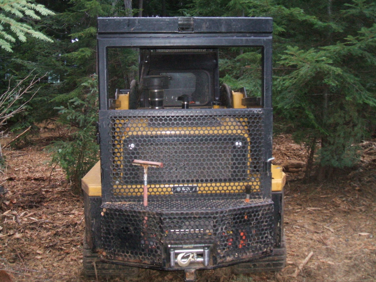

Here is a pic of my rear mounted winch. The door and base plate was made for winch installation. It's just an inexpensive 12000 lb. Milemarker electric winch. It works O.K. for what it is but I plan to change it to the hydraulic version and put the electric one on my Suzuki Samurai.
Is that a squegee?
My friend has a warn 9000 or 9500 and has always gotten out. Just winch it before you bury it! Hydraulic is great as long as the machine is running. I think a warn 16.5 should pull it out. I used a 8000 lb. warn to pull out a Cat 287c that a Bobcat T300 would not pull out. Use a snatch block if you have to.
/ winch for tracked skid steer #11
Yes, thats a squegee. I always keep a bottle of plastic window cleaner aboard and when I get out to cruise a section I am about to mulch, I liberally spray the door and squegee it off. There is also a cheep parts cleaning brush stuck in the perforated metal that comes in handy, mostly for cleaning around the fuel fill opening.

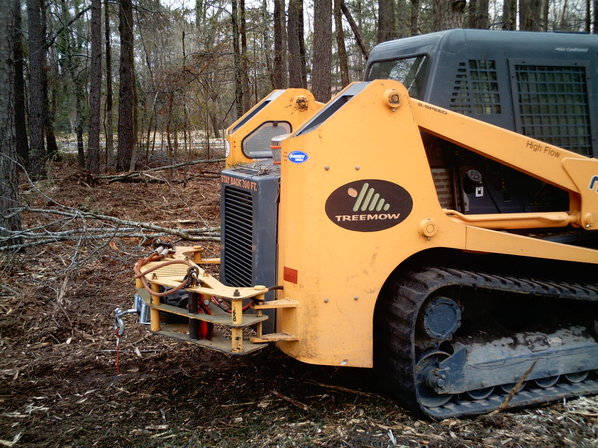

This is an electric winch setup I built.Works great with a snatchblock.
