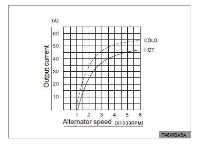

I have a Kioti DK40SE Cab and want to drag downed trees (2 foot maximum diameter) to the logging road. I don't want to spend the money on a farmi and really don't want a 3 pt hitch attachment solution as I will have a Wallenstein chipper installed on the 3 pt and plan on chipping on site.
I was hoping to bolt an electric winch to the front grill bolts and skid the trees. I've read other posts warning of the battery drain and stress on smaller alternators. I can't find specs on the DK40SE alternator.
I was hoping to get the Mile Marker SEC 12000. If the weight of the pull is in the 3-4k range, the amp draw is less than 200 amps.
I'm hoping with a workflow that had a 15-30 minute break after each pull (cutting up the tree and chipping the limbs) would allow the tractor's alternator / battery to keep up - and without destroying it. Am I barking up the wrong tree?

Well the good news; here is the alternator output curve diagram. Note that the more RPM of course more output, but also notice the two curves; cold vs hot alternator. Whether it will keep up or not, I don't for sure know.

I wouldn't tie a winch into the tractors electrical system, you're only asking for trouble.
