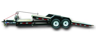

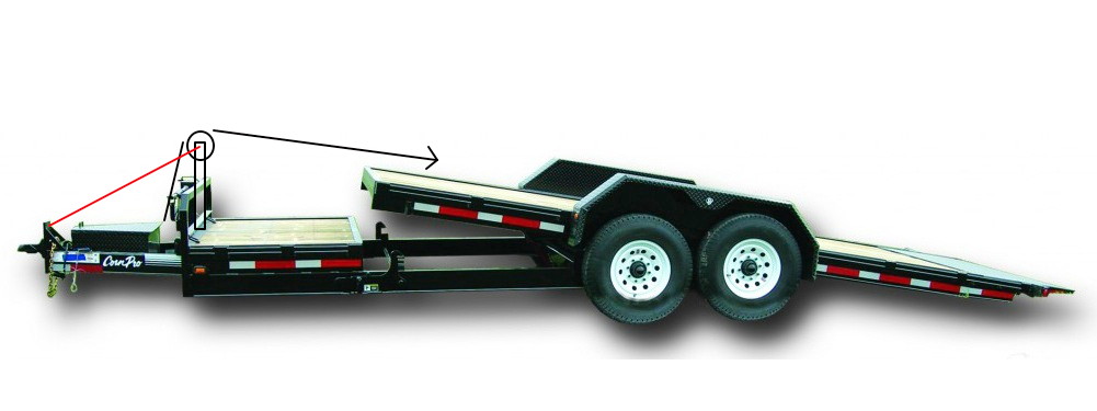

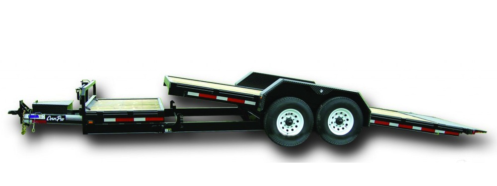

I found a good picture for us to draw on at Davis Trailer World and Country Mall - York, New York.
Here is what I would do. Add a vertical post with a pulley on top to get the winch cable up (black lines.) And for heavy pulls, a cable or chain brace from the post top to the hitch (red line.)
Or you could put the winch on the post, like a boat trailer does.
RV Repair Shop | Milwaukee Area RV Service | Greater Chicago RV Repair | Trailer Repair | Hitch Installation | LP Gas Refill | Hanna Trailer Supply Oak Creek, Wisconsin
The advantage of the low winch and the post is better protection of the winch, and an easy way to have a high pull and a low pull.
Bruce
   / Winch for 22' (16' tilt - 6' stationary) trailer

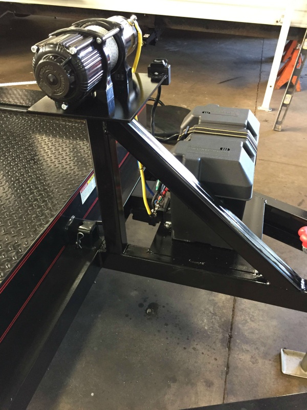

I like the second picture on the pedistal. That is the only way I can figure doing it...but my spare tire is in the way. I may see about offsetting it to the side where it is best for pulling anyway. Or I still may look at mounting it on the tilt bed.
