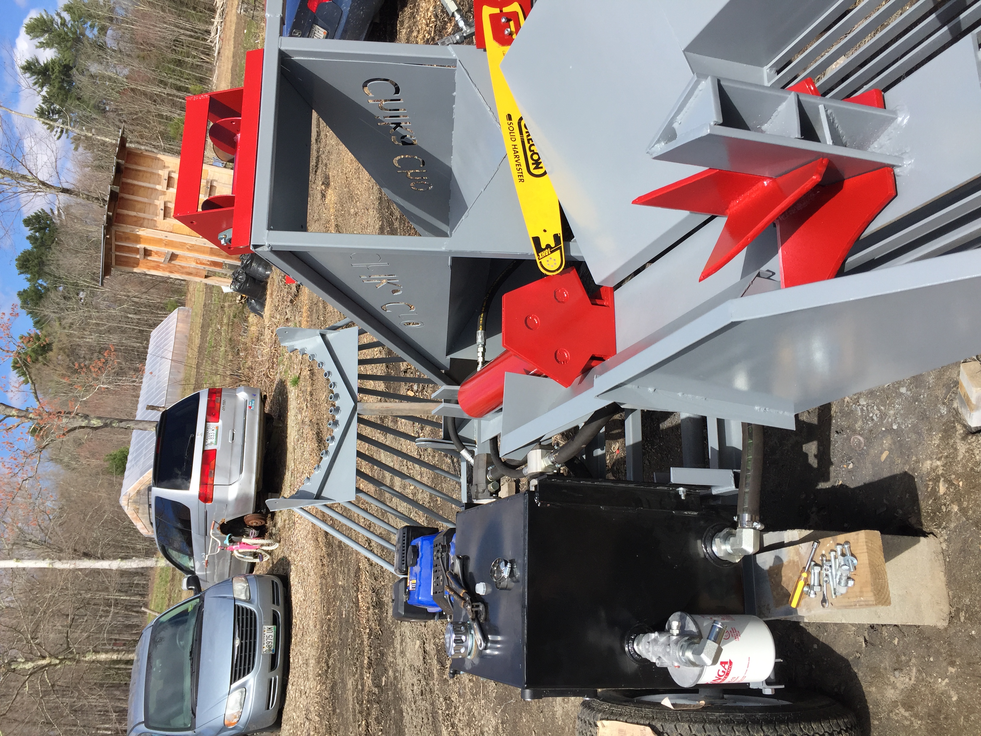

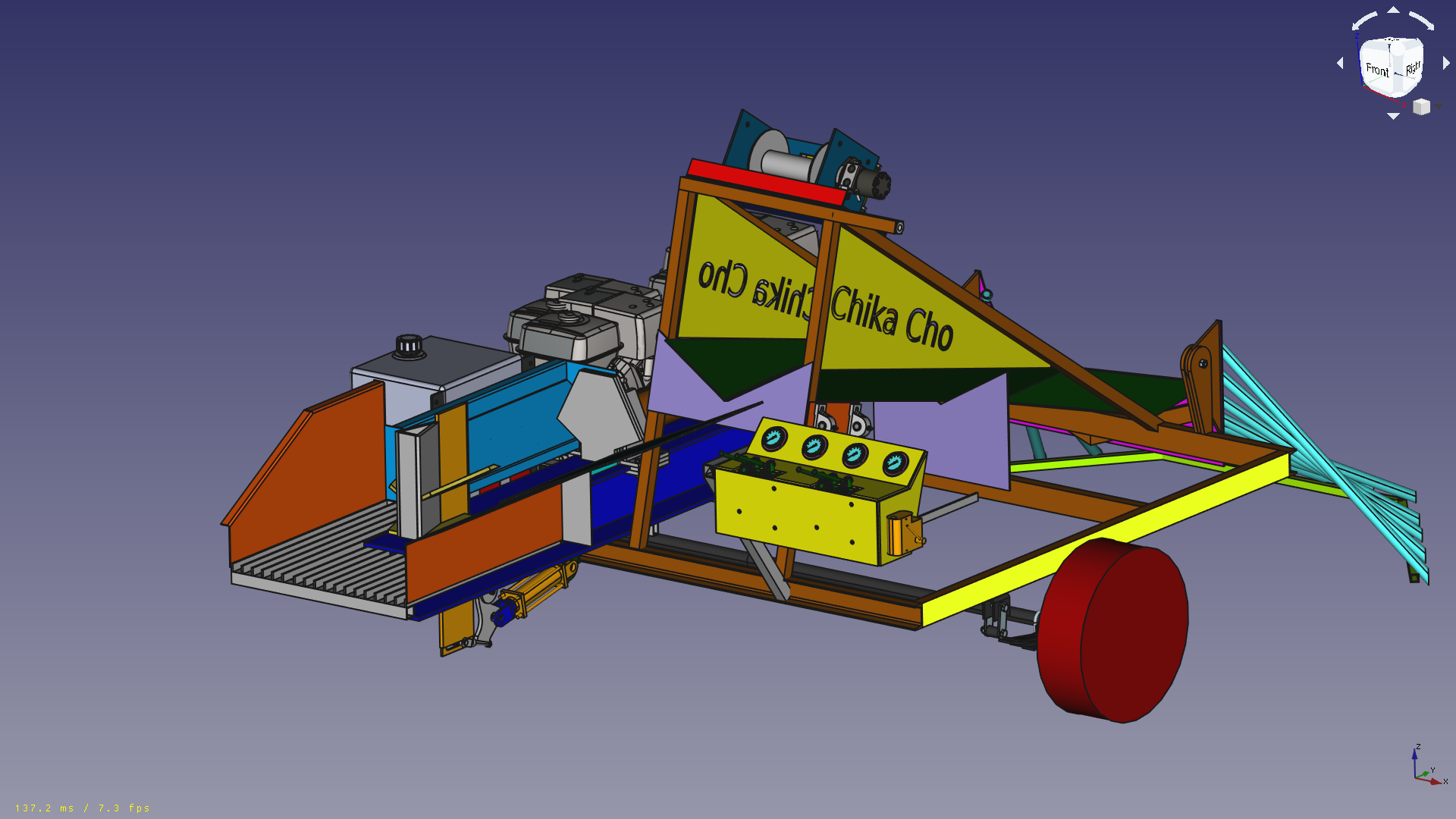

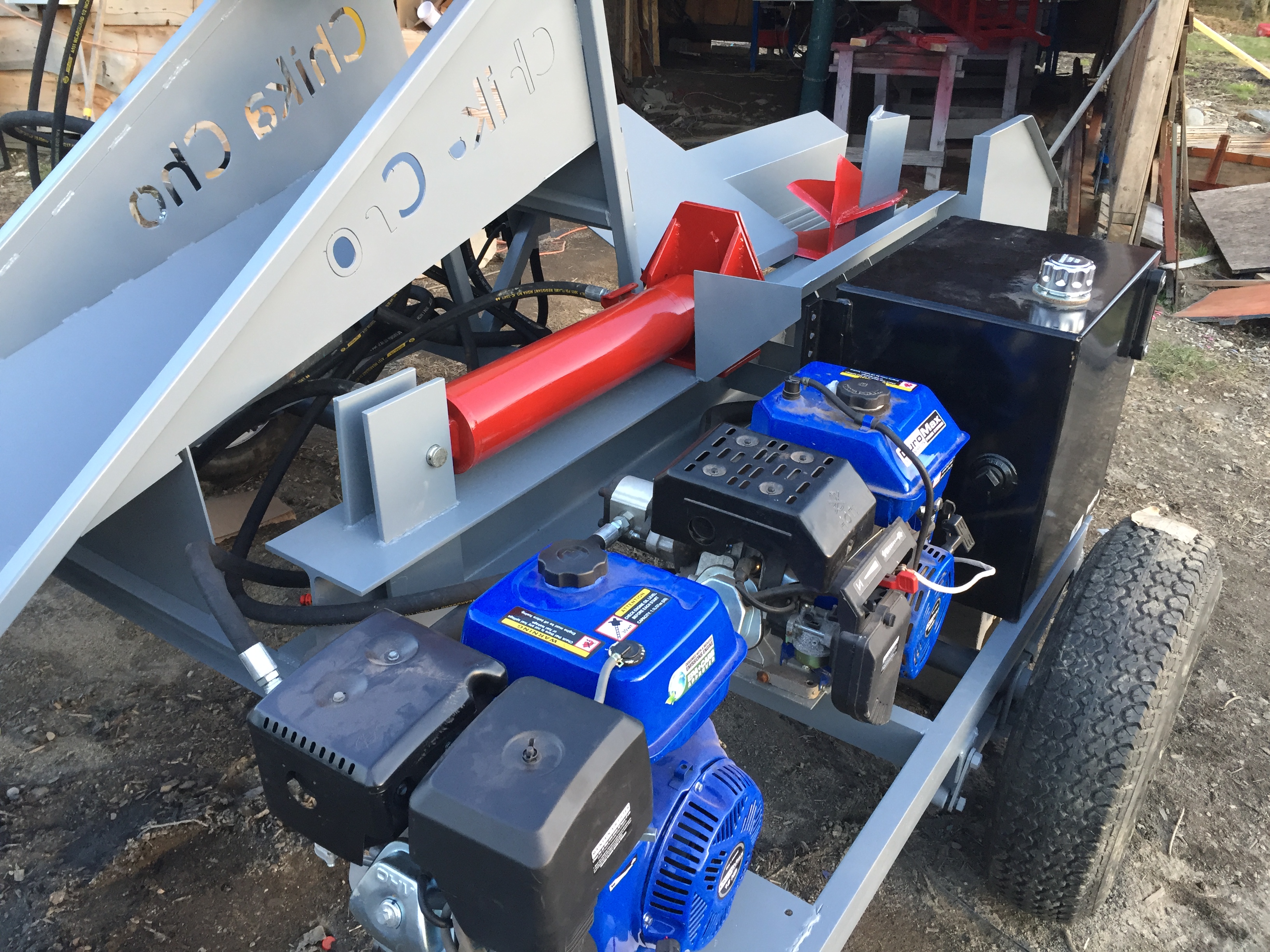

Finally I have some progress and some real photos for you guys! This is the 2nd processor I design. My 1st one with the live deck is on hold.
One engine for the saw motor / 6-way height adjustment / winch. 2 valves for the later, while the saw runs operates with a solenoid valve that gets oil from the PB port
One engine for the splitter, with auto retract valve, and a 2-stage pump
The splitter cyl is 5" diameter, and the beam is W-Beam 8-35.
No oil-cooling yet, I will keep a close eye on the oil temp, and I will add it only if needs it. Hopefully the big tank will dissipate heat fast enough.
I wish I could do the same with one engine for with the same cost, but I can't. A 30hp+ engine goes above $3000.
Any questions or suggestions are welcomed! :)
The design (with some errors and a lot of missing items)

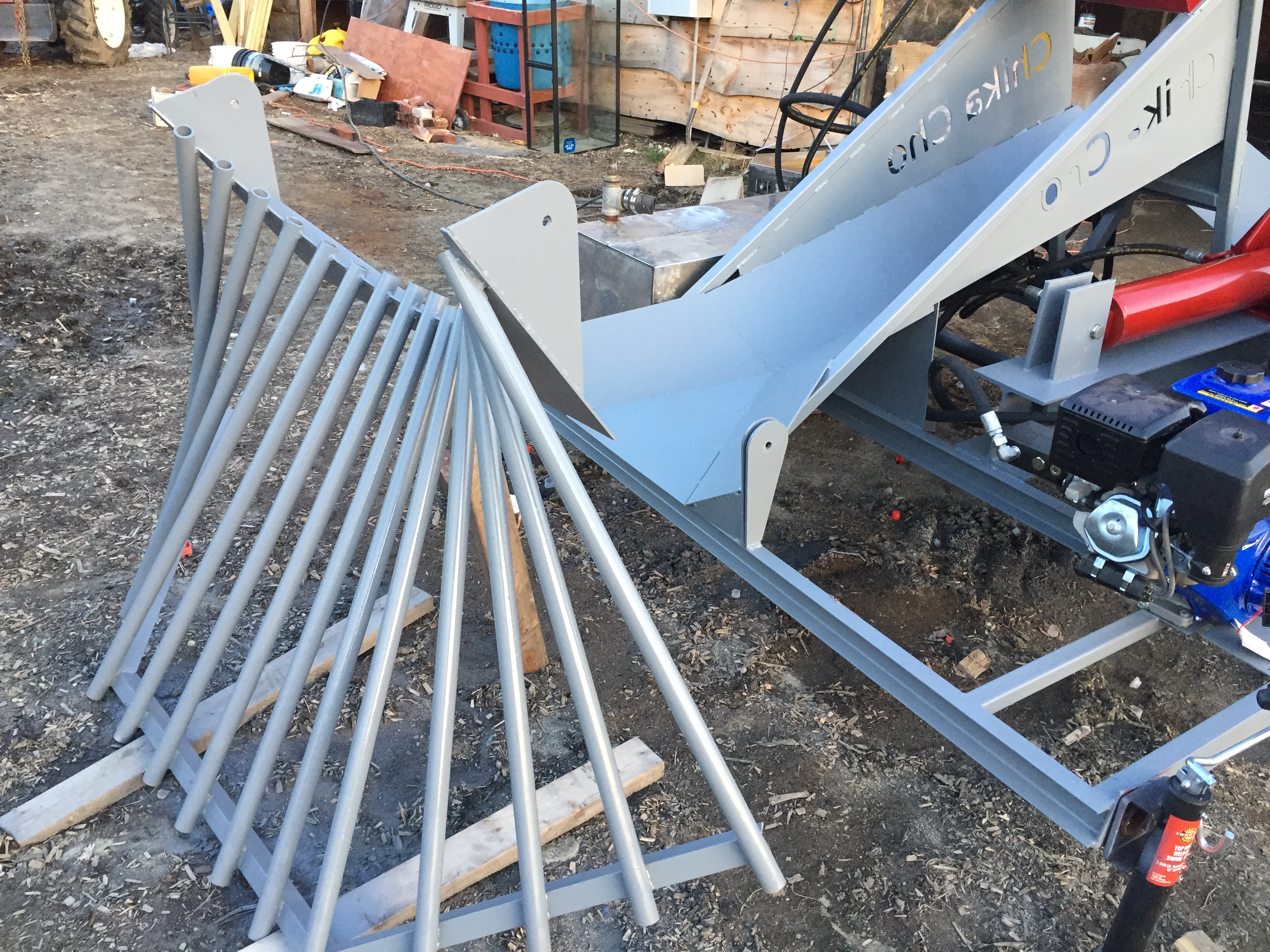

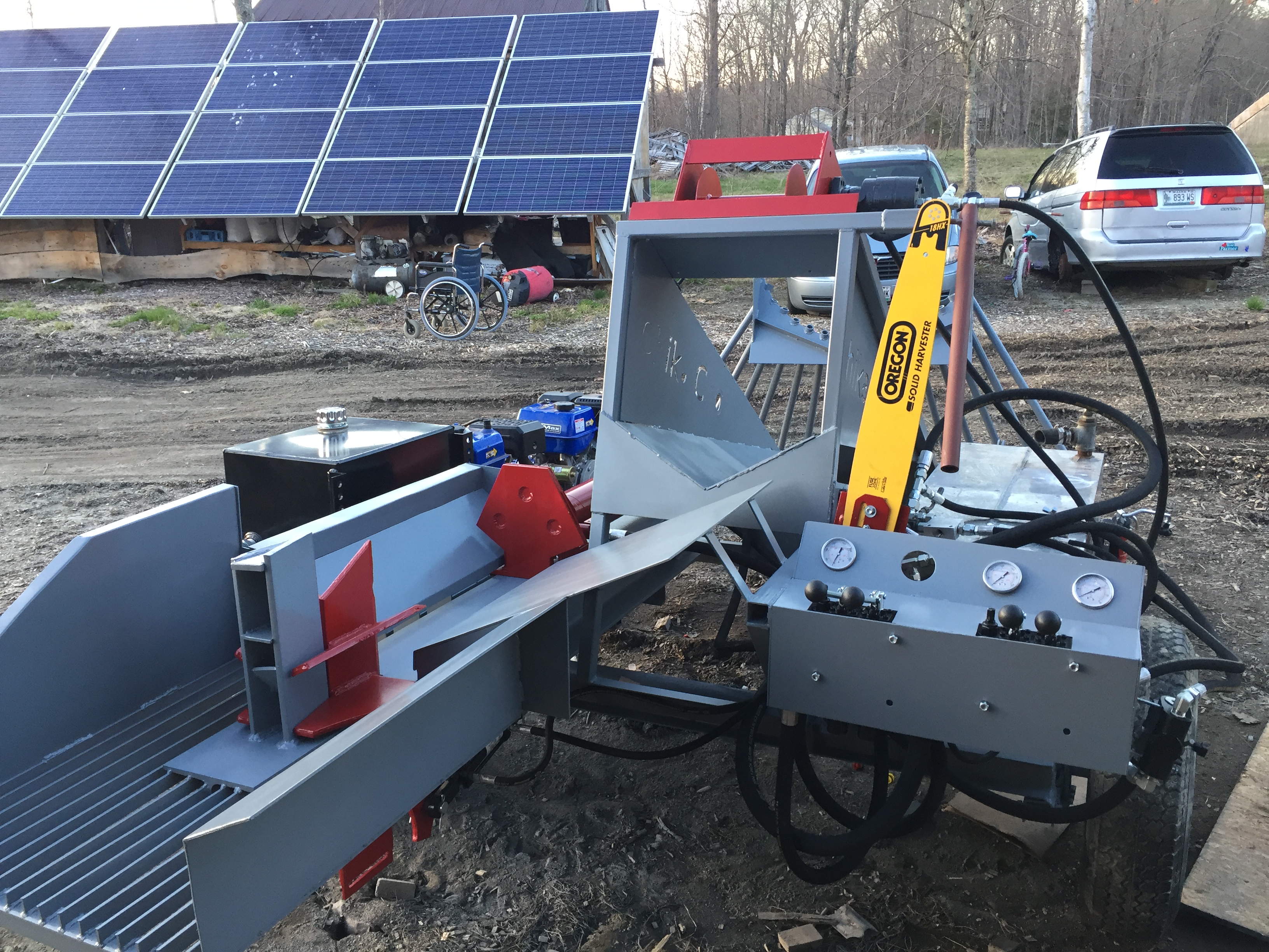

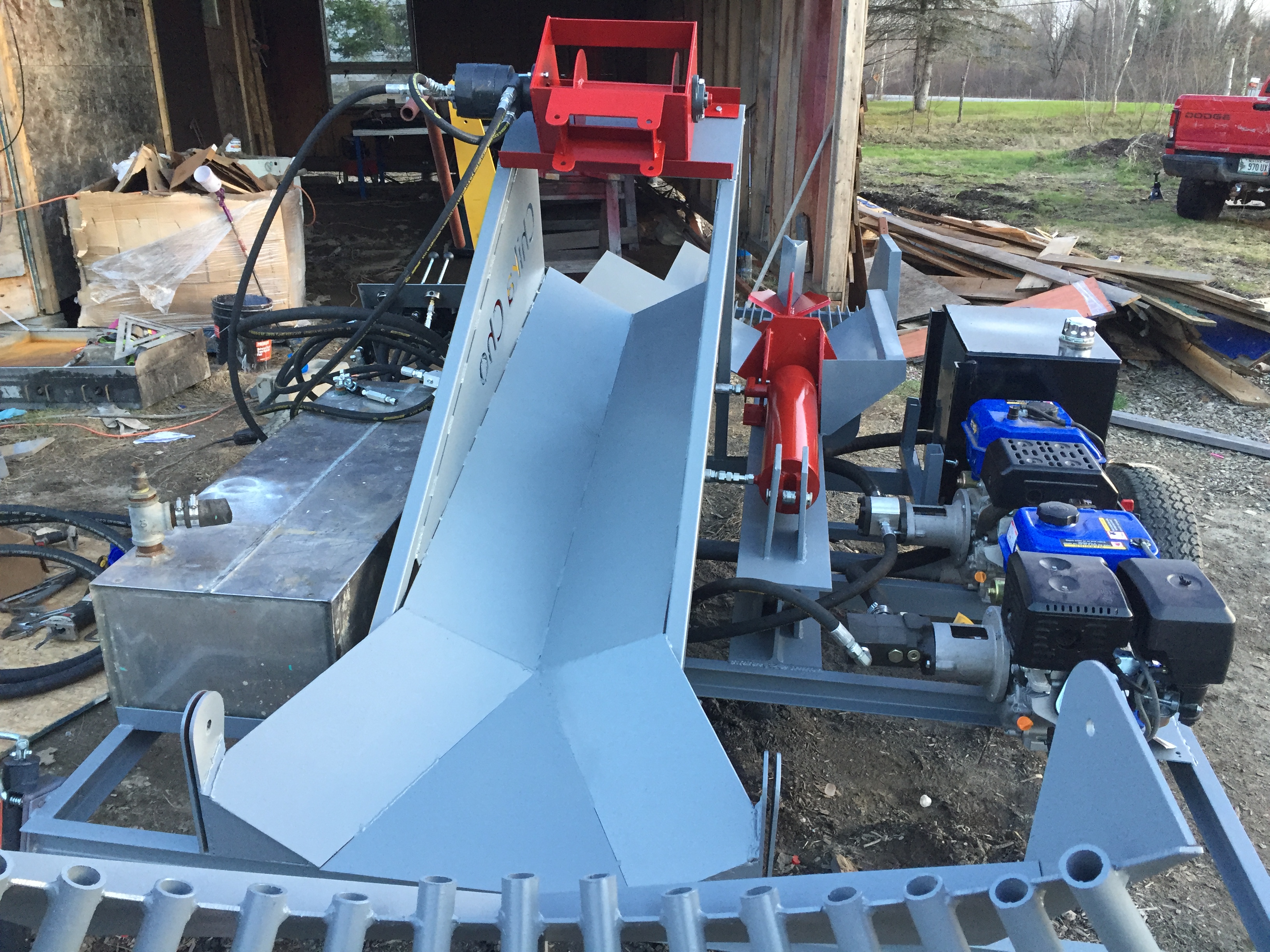

And the progress as of yesterday
Hopefully i will have some videos soon.

That looks really nice, I like the solar panels, should make for some quiet splitting and cutting ;)
What motor are you using for the saw? I would love to do something similar except I would like a log deck as I have a tractor to load it.
   / Winch Firewood Processor
I have another post with my live deck processor but the fabrication is on hold since this winch type processor is a paid design! ;) ;)
For the motor I used the classic 0.58ci gear motor from surpluscenter. I haven稚 found any better option for that cheap , even though it does not take advantage of the full 18hp of the gas engine.
Paired with a 14t sprocket and a 0.404 harvester bar

Exactly. The customer has a skider and wants to process the whole logs. And also avoid having to haul another equipment to lift the sticks on a live deck. Electric is not an option because the gas motors will not be able to recharge the battery. The load is simply too much. The hydraulic motor free spools yes, it has an extra declutch port. In theory at least! I will know in a few days if it really works as expected :)

It痴 on the same shaft. I put a coupler on the motor shaft, and connected the drum axle. So on one end is the motor, at the other end is bearing. Now that I give it a second thought maybe I should had put a second bearing right after the motor so the load does not go to the motor bearings.
   / Winch Firewood Processor #8
Itç—´ on the same shaft. I put a coupler on the motor shaft, and connected the drum axle. So on one end is the motor, at the other end is bearing. Now that I give it a second thought maybe I should had put a second bearing right after the motor so the load does not go to the motor bearings.
That's a good idea. Some hydraulic motors are not designed for side load.
