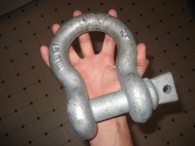

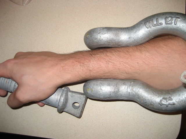

I have a 20,000 lb winch I'm installing on a small loader. I wanted some rigging gear so I bought a couple of clevis's off Ebay. They were rated 12 tons. Looking at the clevis's, I now realize they were rated for lifting, not pulling. They way too large for my application. Anybody know how much a clevis would be derated for pulling?

The clevis is rated for the load that is either stamped or embossed on the side of the thing. It doesn't matter whether the load exerted on the clevis is from pulling or lifting. The load exerted is the same no matter what.
What you have to be careful of in any instance is the impact loading of the clevis if the load is "jerked". That in itself will increase the fatigue factor of the clevis quickly leading to failure.

I am curious how you can tell the clevis was rated for overhead lifting? Regardless, the working load limit (WLL) is the working load limit. It doesn't need to be derated. The clevises you use should have a WLL equal to or higher than the WLL of the cable on the winch. The actual breaking strength will be substantially higher.
Only buy from sources who state their rating in terms of working load limit. That is what the rating stamped into the clevis should be, but with world sourcing of this kind of stuff, the only way to be safe is to buy from reputable suppliers.

Not true. A rolling 20,000lb load has significantly less resitance than a lifting 20,000lb load. This is illustrated by the ultimate strength of this equipment. If you take the ultimate strength and divide it by 5 you will get the working load for a lifting application. That means the ultimate strength of the 12 ton clevis's that I bought is 120,000lbs! When you hold the 5/8" winch cable next to a clevis with a 1-1/4" pin that's the size of your hand you'll realize how much redundancy is built into lifting equipment. I am not and will not be using this equipment for lifting so the 5:1 saftey factor is unnessary. A 3 ton shackle rated for lifting will still have a safety factor of 1.5 and a 4 ton shackle will have a safety factor of 2:1. That's more than adequate for a winching application. T
his whole theory was reinforced when I was trying to research my question above. I was on a of the winch mfrs. website where they were talking about using a winch for over head lifting. The winch was capable of lifting overhead, provided two things were provided: one was a brake to hold the load, the second is a safety factor of 3:1. The winch mfr. already had a safty factor of 2:1 design into their winch, but that wasn't good enough for over head lifting. With a clevis rated for overhead lifting, we are simply applying the same theory, but in reverse.
