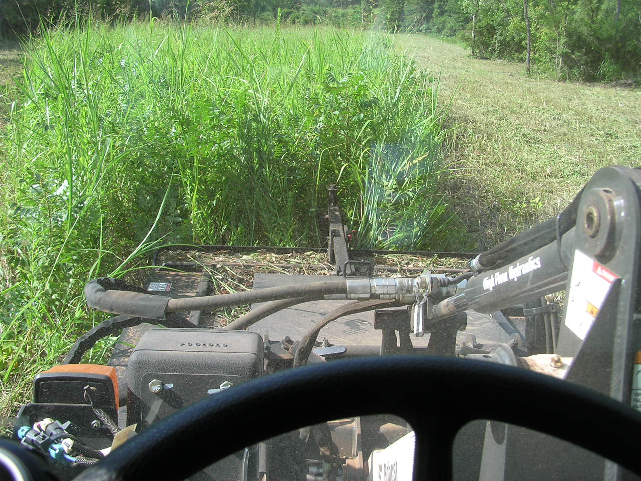

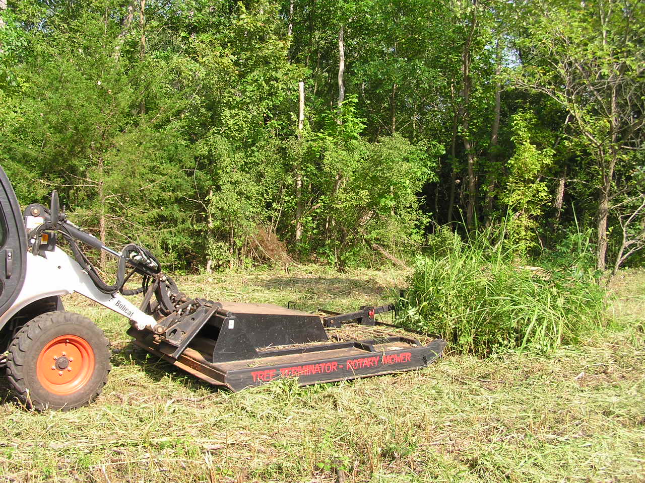

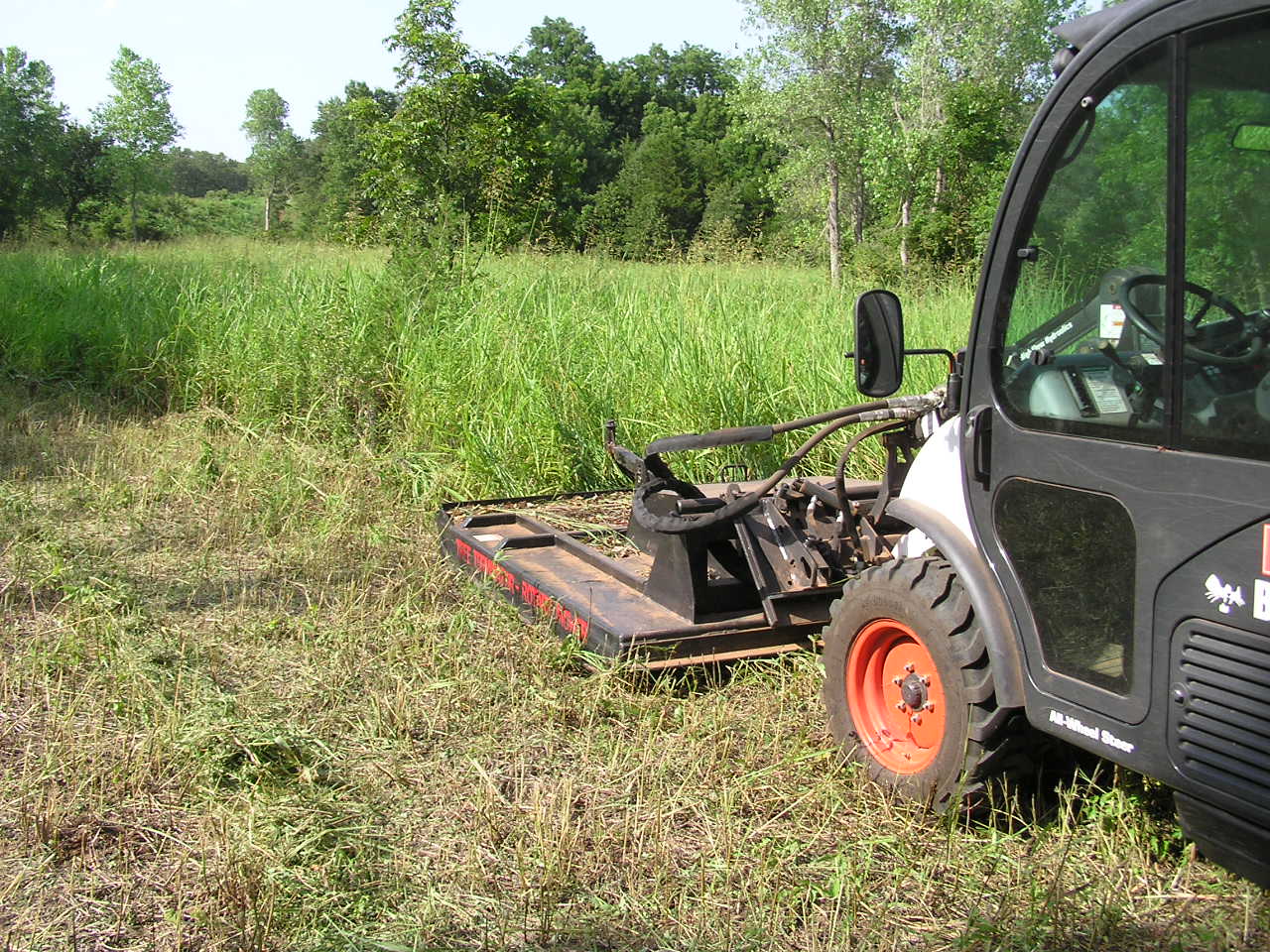

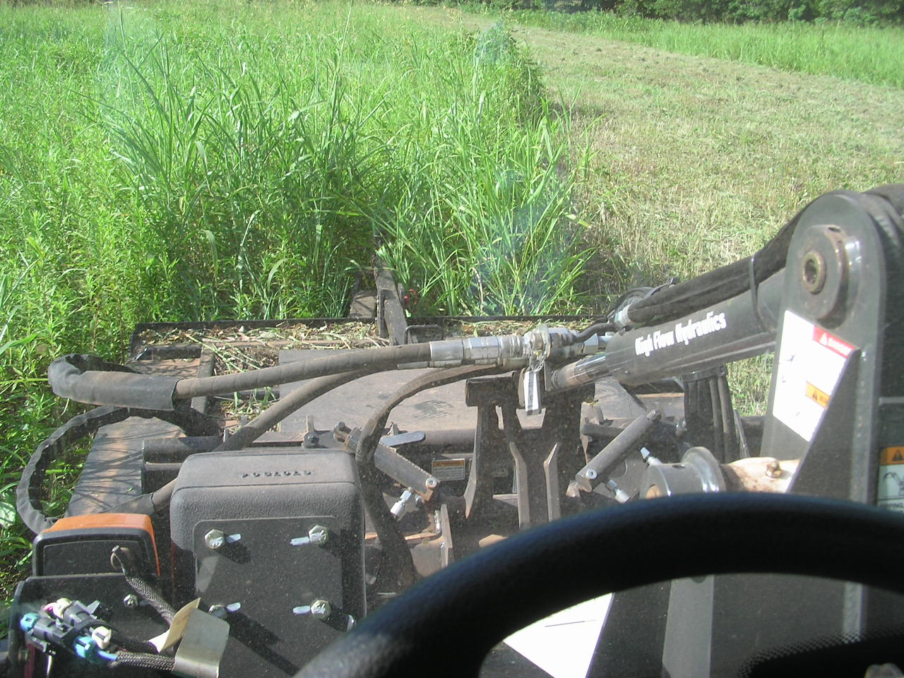

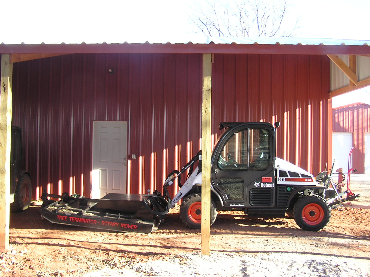

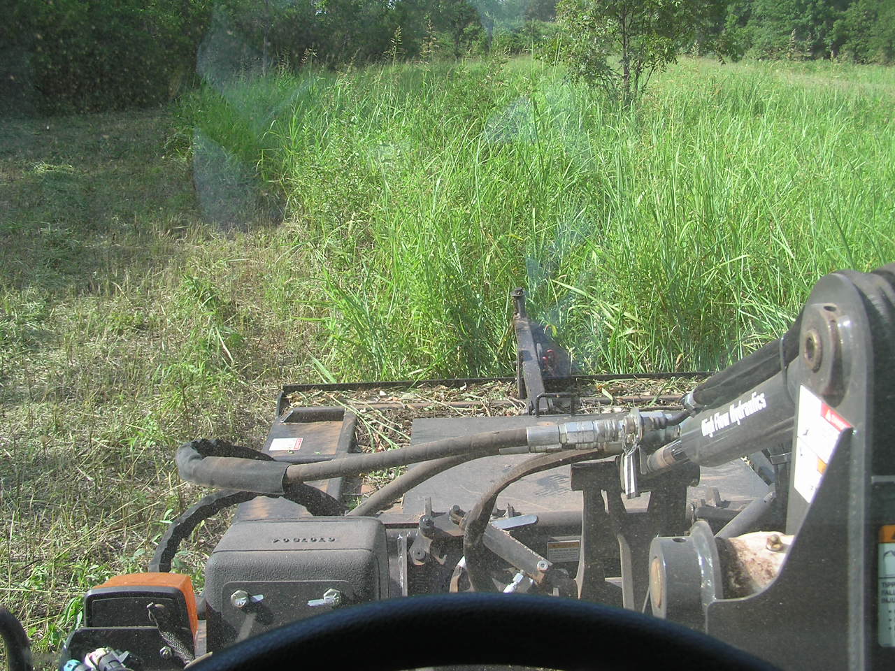

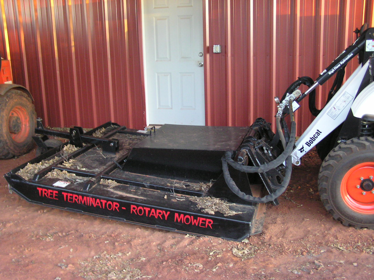

Looks like the OP is not with us now, but I will update this thread for future info seekers like I was when I joined TBN.
I got the 5610 series F because the main use would be the brush hog. So far, so good! No overheating. Was out a couple of hours in the 95 degree heat, cutting tall grass and brush.
P8070003.JPG P8070004.JPG P8070005.JPG P8070007.JPG P8070008.JPG P8070018.JPG
