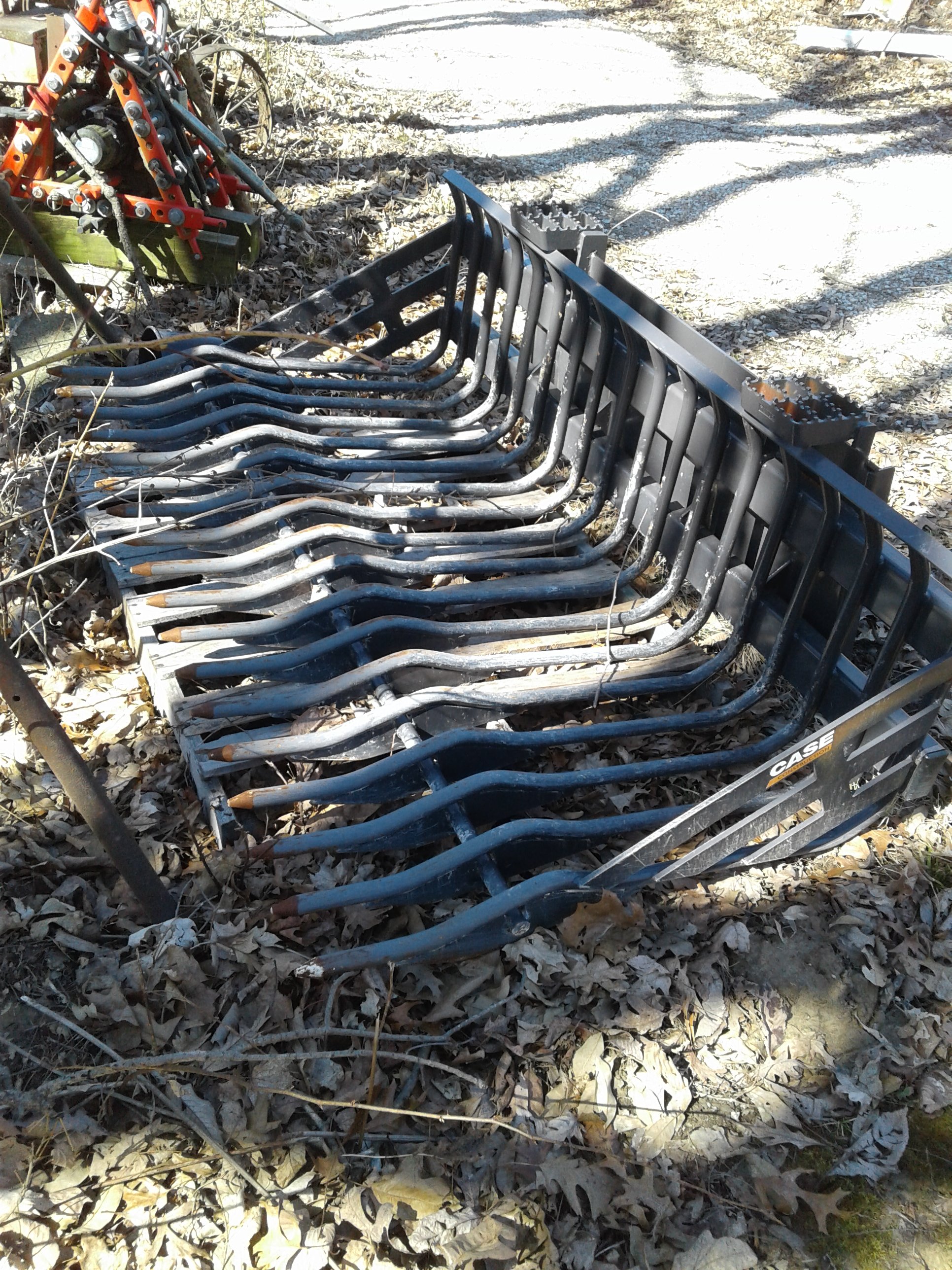

Hey all. I've been reading this thread from 2015 and I can see I need to get something to help pull out the rocks from my soil before I pass my new tiller over it.
Is this the right tool for the job?

It should do the job. Problem still remains - how will you collect and remove the rock. This will bring the rock to the surface. Be sure to have the ripper set so it can "skip over" any really massive rocks. I would have the rippers set in a trailing configuration rather than a leading configuration.
   / Will this work for removing rocks from soil prior to tilling? #3
I do not have anything like that so I can't say for sure, but here are some observations from what I've done. First I have rocky soil and those tines are not going to remove them, they may raise some stones and push others to the side. 2nd there are actual rock pickers that will dig up and put the rock in a wagon with one pass. I've only seen pictures and videos of this. 3rd, I gave up trying to remove all the rocks before tilling and just make sure my slip clutch is adjusted properly. I've been expecting to damage the tines at least, but it hasn't happened yet.

Good start, rock bucket can pick up 3"+ rocks (optional tool)
Landscape rake will drag rocks into pile, use loader bucket to remove rock pile
Don't have one, maybe best tool for job

That cultivator won't help picking rocks(I have one) the landscape rack will do a better job.
I have lots and lots of rocks;my tiller just bounce's over them.Leave the discharge flap wide open and make sure your slip clutch is working.

I have the same issue with tilling the unworked ground and rocks. My soil contains basketball-sized and smaller. I have tried something similar to the rippers you show by using box blade rippers. Pulling fixed rippers will pull some rocks to the surface but was slow and provided no safety. I ended up going with a 9-shank Fred Cain field cultivator. It allows me to travel faster and allows the shanks to trip back and automatically reset. The offset of the shanks also pulled up more rocks per pass since they are set closer together. My tiller is reverse rotation so it tries to ingest all of the rocks. It is fine unless they are the exact right size to instantly stop the tiller in its tracks.
Getting them to the top is then easy, but you still have to rid of them. A rock picker would be amazing, but I don't have one. I use the landscape rake to make piles/windrows and the W.R. Long grapple to pick them up and screen the material to try and separate the rock and dirt. After 2-3 seasons, I can now do all my plowing with just the field cultivator and only use the tiller to smooth things out if time permits. It would be amazing to live somewhere with no rocks.

Rocks are tough. I think I'd go with a middle buster to dislodge them first. Yes it'll take a lot of passes but you won't bust up equipment as pictured nearly as bad.
