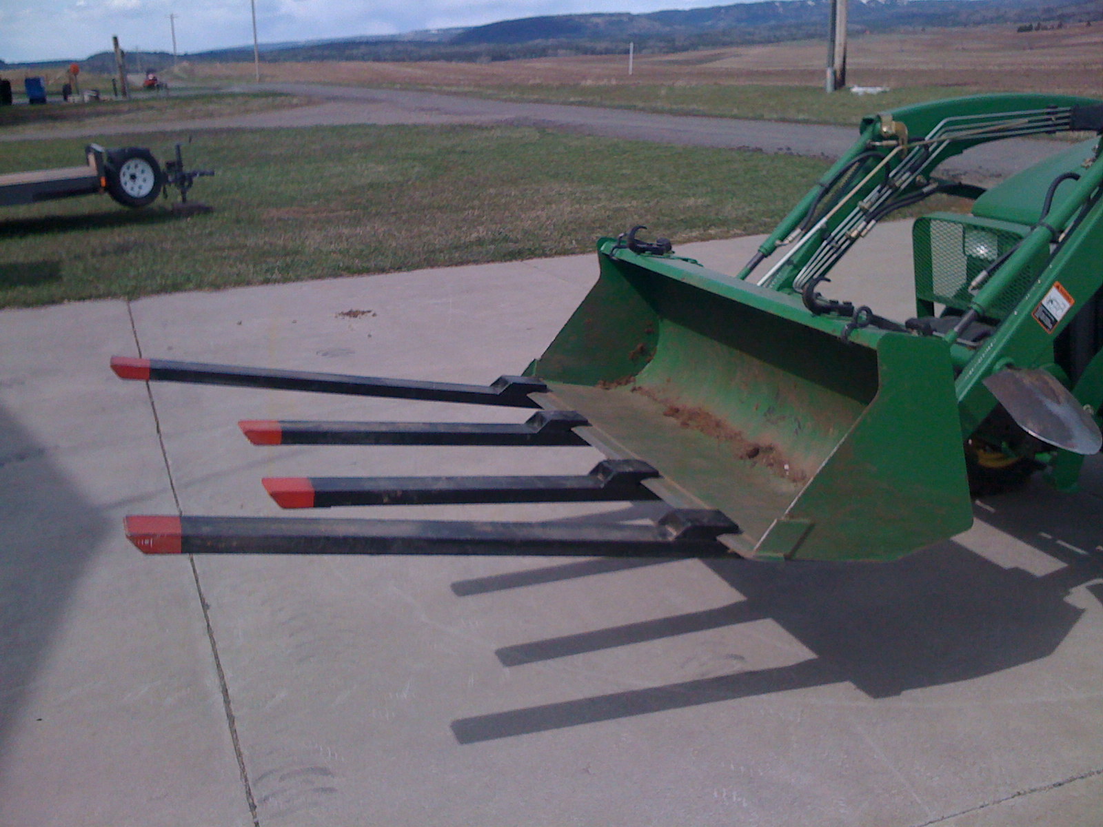

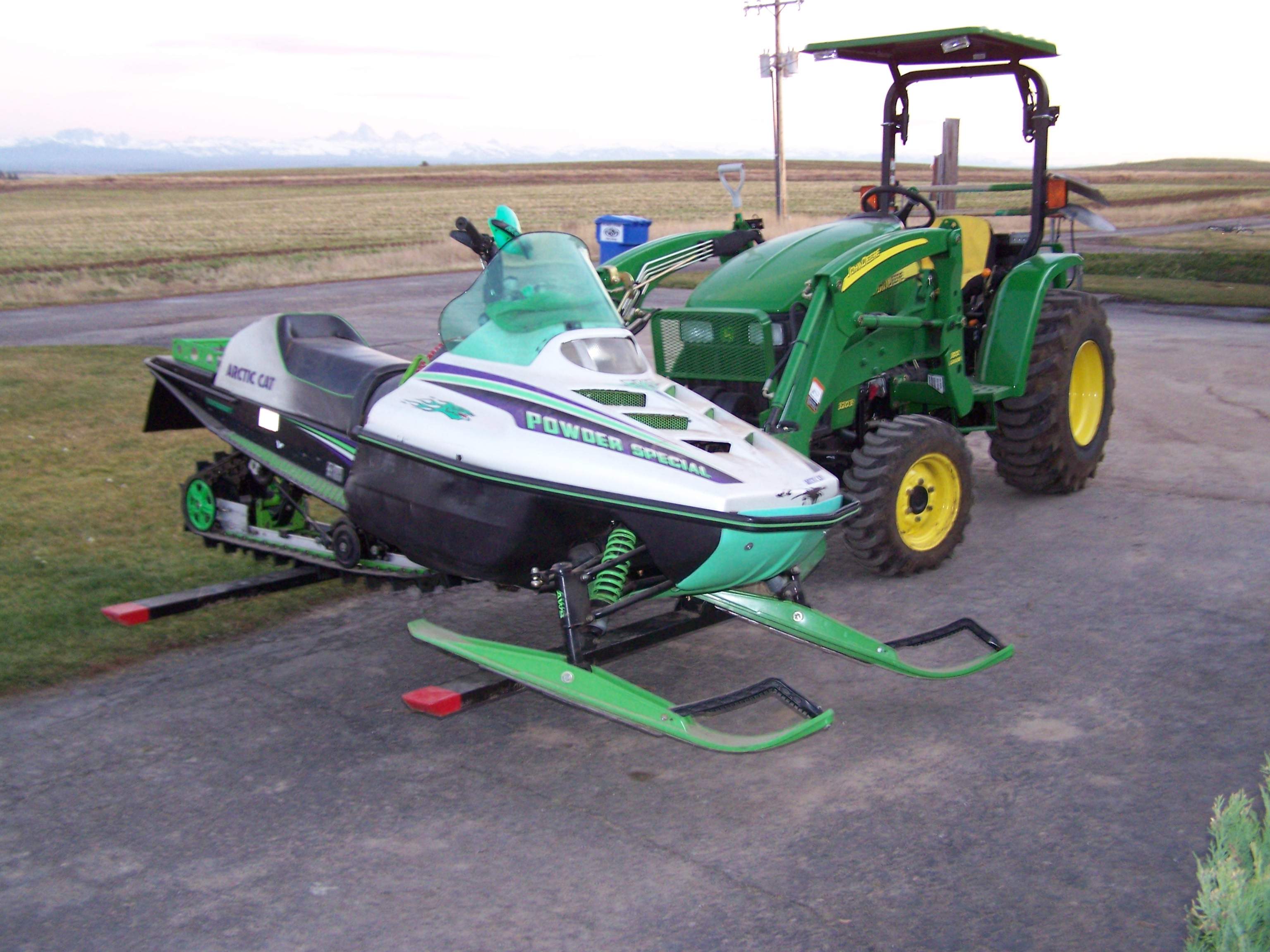

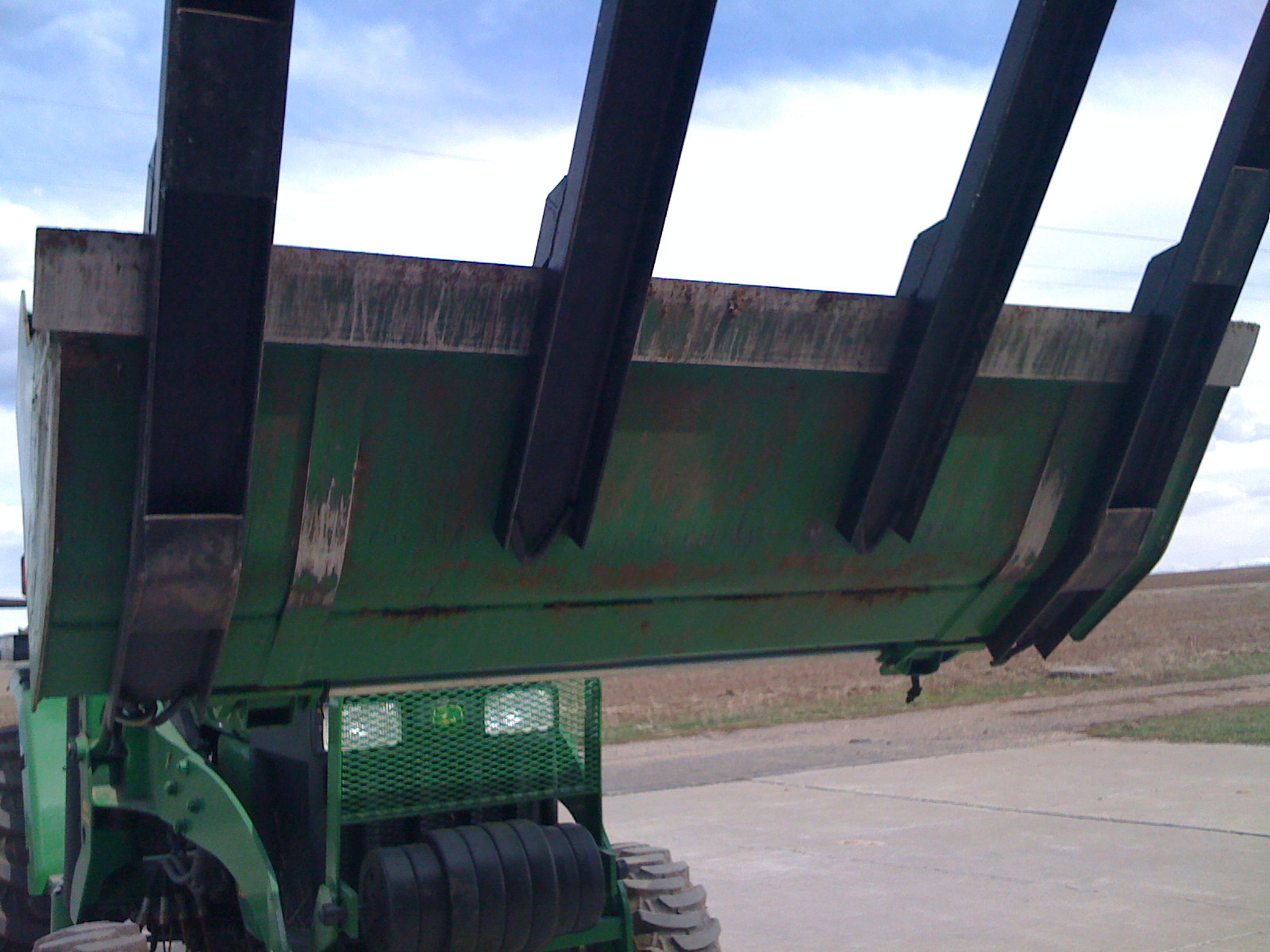

My forks are 2x3x 3/16" channel iron with reinforcements welded in and they still flex when I load too much on them. Granted I don't use them much and they have served me well over 2 yrs, but...... I still wish I had sprung the $$ for the heavier steel;);)

#9
Thanks, guys. It looks like I should try to find some "real" forks and build my frame from there, or buy some 4x2 1/4" tubing!! :D
