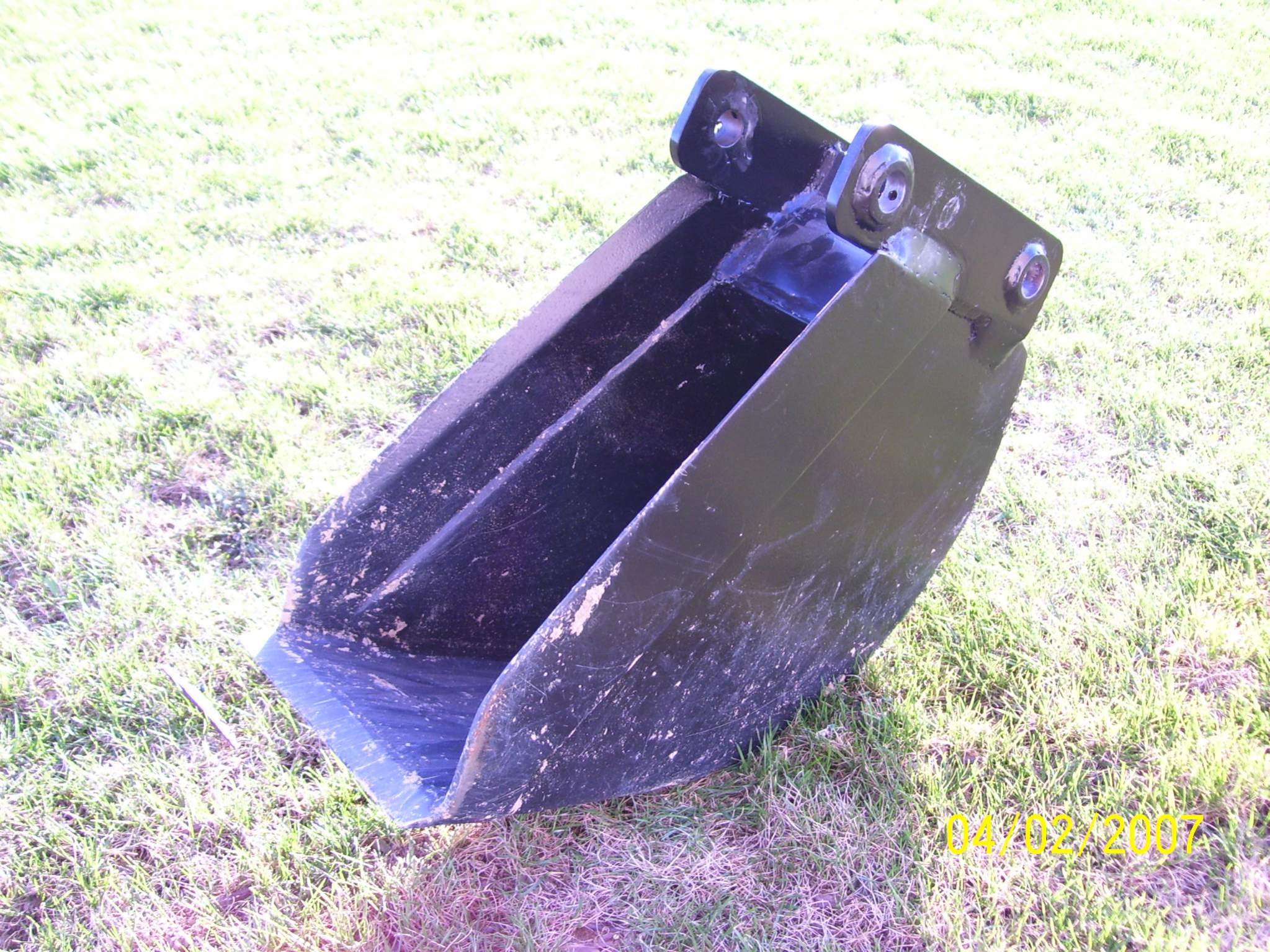

The Titan bucket is about ½ the price of a MF 16 bucket. I will not use it a lot but sue would like one.
Does anyone know if it fits?

Did you read the specifications under the "Details" in ad, do they come anywhere near close?

No, that configuration is different. They pretty much all are.
The MF bucket has the same spacing on both attachment points.
The photo of the bucket you provided does not have the same spacing at both points.
That being said, I made a bucket for mine, and it was not that difficult to make all that. So, you could modify one to fit yours, if you want to.
The titan bucket does not look like a very well made one.

@Dale I printed them out but I had to work this weekend so I have not had a chance to measure.
@ray66v I like that idea I have a welder so it sounds like a fun project.

Unfortunately there are no standards for buckets. The manufacturers know this so they make them all proprietary. Everyone’s QA or standard pin configuration seems to be just a bit different :).
These guys do make buckets for a number of different backhoes and excavators...might check them out.
