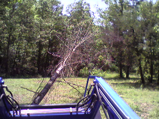

A 12 inch cedar might be a bit for the 33. But, I have pushed down some that I would have thought it would be impossible. They are a powerful little tractor. And when you get it cleared you will need something to keep it maintained. A good excuse to get it. :) The tree I pushed down here is larger than you would think. I would guess it was 40 ft long. And, maybe 6 or more inches thick, no problem. Of course, the type of dirt and rock, make a lot of difference as well.

TrippleT said:
A 12 inch cedar might be a bit for the 33. .
From what I read, he was talking about 10 - 12 foot tall cedars. I would guess they are about inches at the butt. A TC33 could probably push a few over. I think they should be cut for posts being cedar.

Sorry, I misunderstood. If they are only 10 to 12 feet tall then it shouldn't be any trouble. Cedar here push down fairly easy. I guess senility is running rampant. LOL
