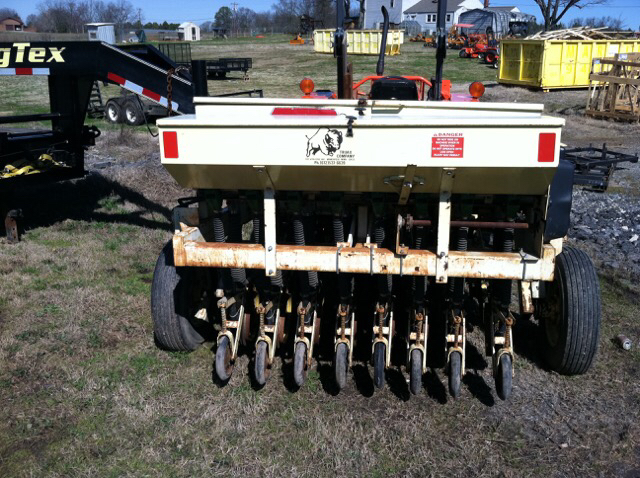

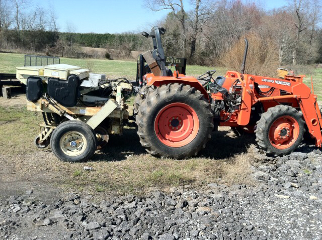

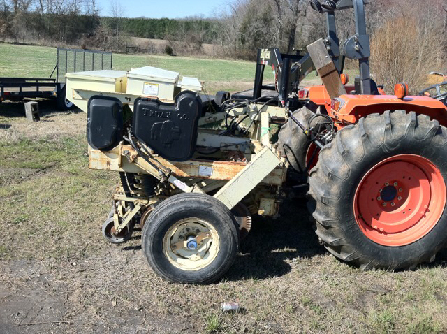

I pull a Truax no til drill with my 68 horse Kubota M 6800. It can be used on the three point hitch or towed, depending on whether the tow bar is attached. It weighs over 3000 lbs, probably closer to 4000.
it's too heavy for my three point hitch, but towing it is absolutely no problem. It's very easy and causes no concern. And my land is hilly, and I have many food plots. Mine is only 8' wide, but still a very heavy drill. I think you would gave no problem. This picture shows it without the towing bar assembly, and I don't like using it in this mode. It's too heavy to lift. I use it pulling it off the drawbar, not attached to the three point.
