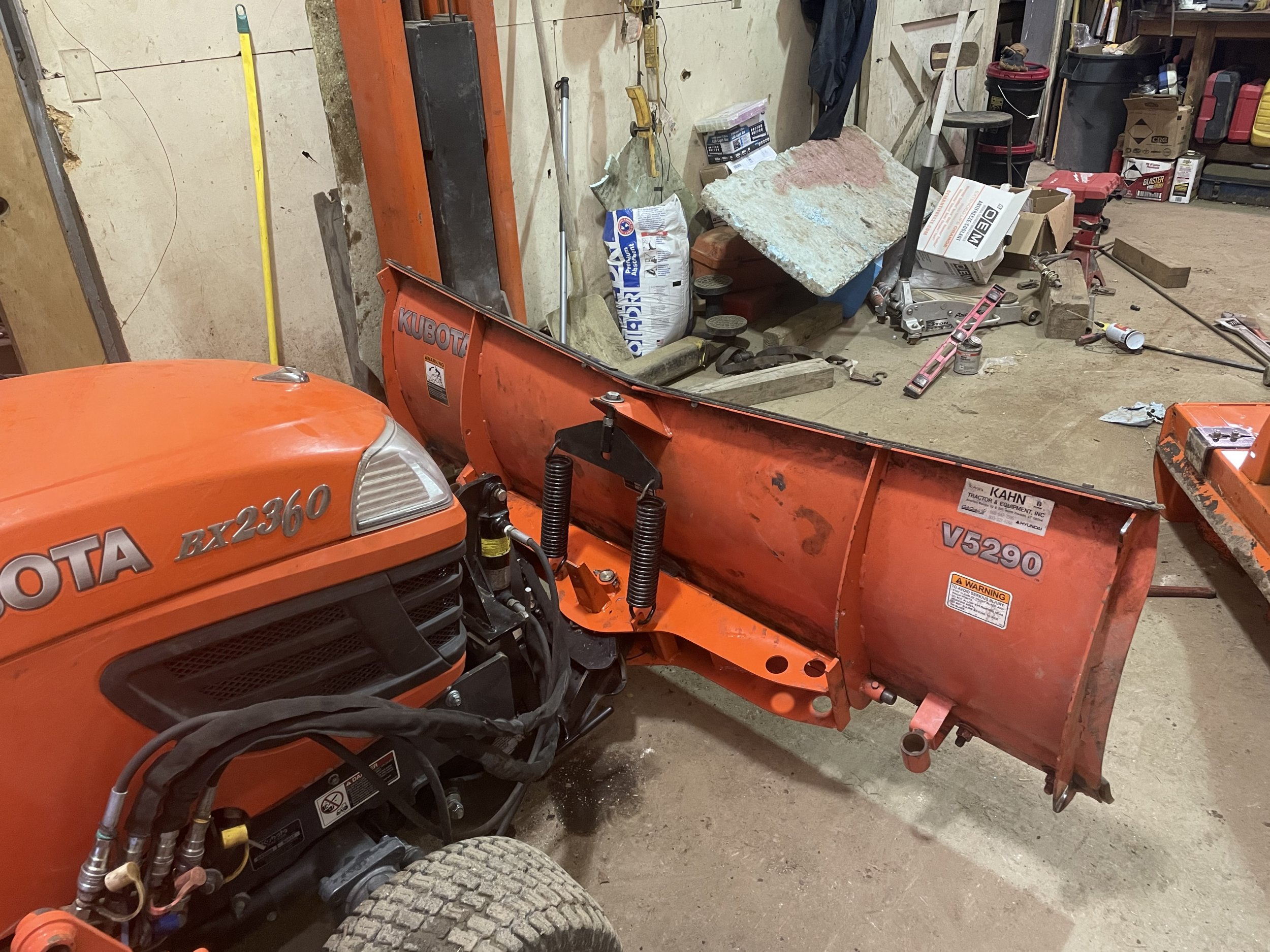

Looking for a snowplow for my BX and found a used V5290 off of an RTV, does anyone know if that will fit the quick hitch on the BX or would it need to be heavily modified?
   / Will a V5290 plow fit a BX tractor quick hitch? #2
I have had both, thinking fair amount of mods needed. Not that it couldn't be done.

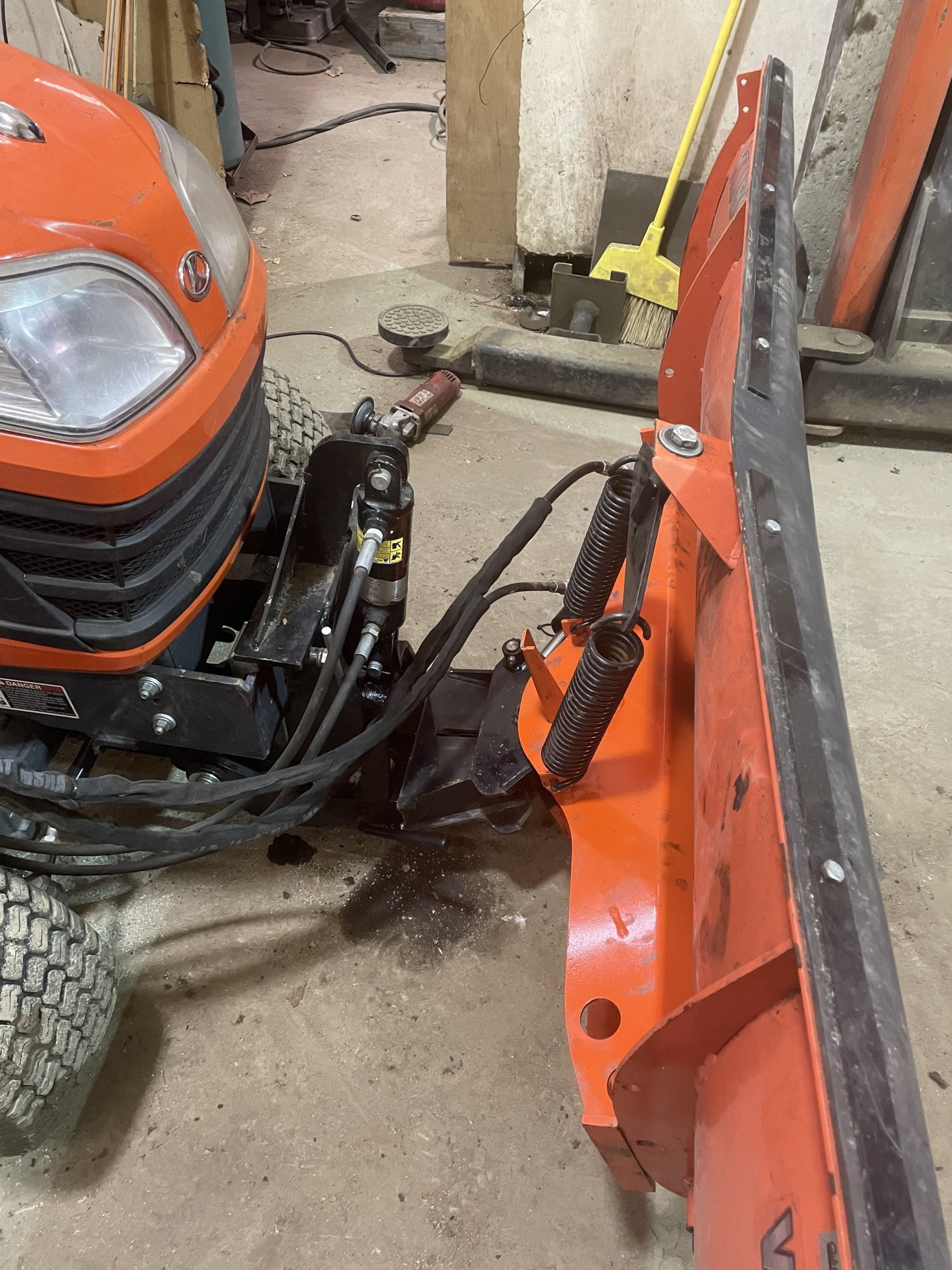

I actually bought the plow without knowing if it fit, and it does…..kind of. The slot just needs to be longer OR I just need to cut an inch or so off of the female hitch side on the plow for the BX quick hitch to latch it on.
On a side note, any chance anyone has a parts breakdown for the V5290 plow, can’t find it online but can find a breakdown of the V4290 plow, thinking they’re the same though?

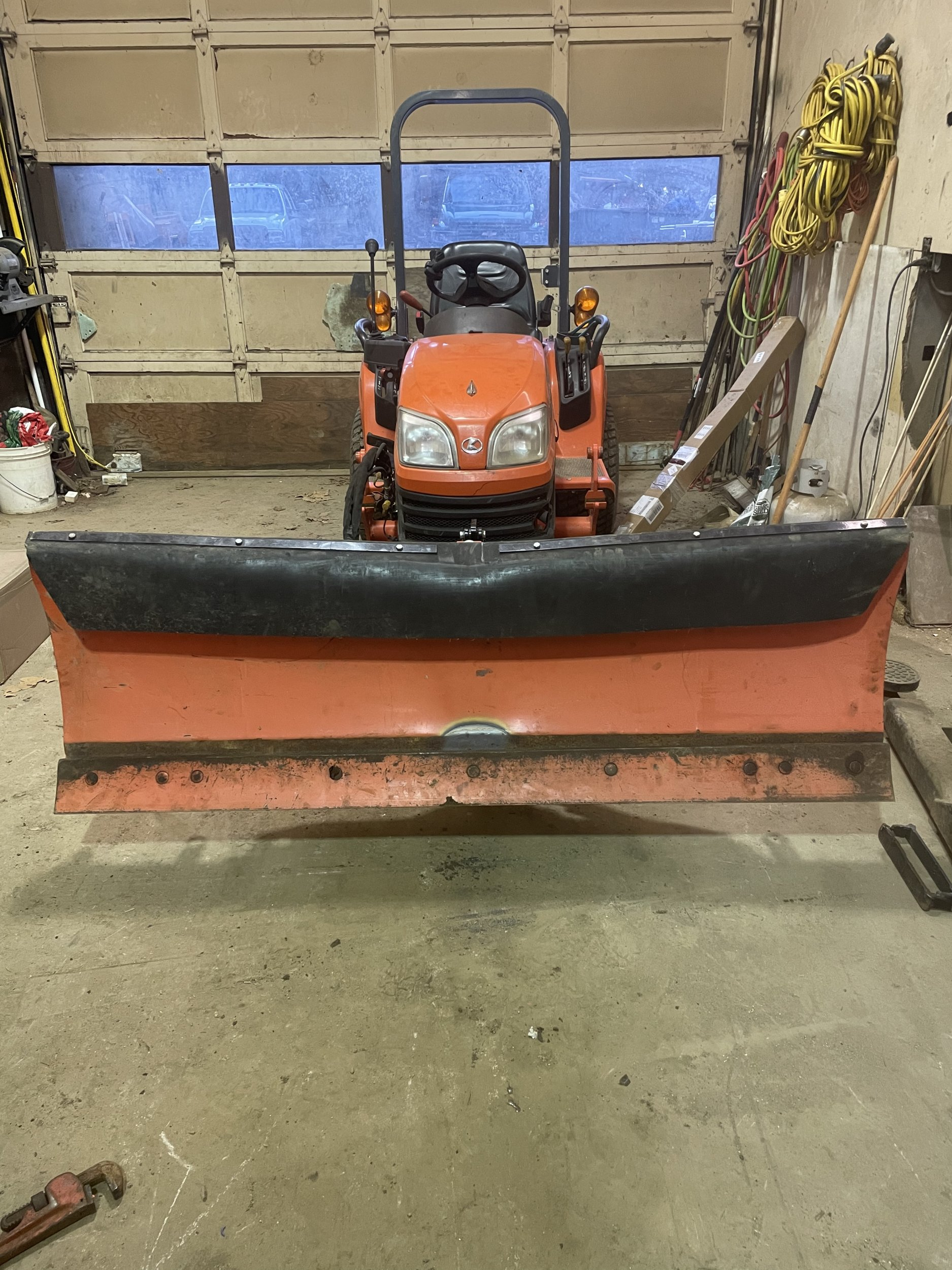

Just to follow up, it does fit, nicely too! Just had to trim about an 1 5/8” off the back of the female quick hitch on the plow, fits perfectly and just need some snow to give it a try.
