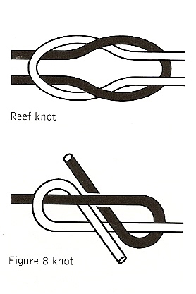

I pulled three 1250 foot strands of high tensile wire for a fence today and came up 35 feet short on the last strand. I guess 4000 foot spools of wire are kind of arbitrary in how much wire you actually get.
Each wire goes from an end post 240 feet to a braced corner makes a 90 deg turn and then 1000 feet to the other end post.
From what I have read you can use 2-3 crimps to splice the wire together and it should be about 80% as strong as unbroken wire. Is that actually strong enough for use when tensioned?
If the splice is a bad idea how about seperate wire going from each end post to the corner? I really do not want to pull 1215 feet of wire out of the fence and repull it.

I've seen the triple crimps used most of the time. I've also seen a tension spring or strainer used rather than a splice.
It's done all the time, so I wouldn't worry about a spliced wire.

whenever I need a splice I just bend both ends back around so I have a fairly tight u shape with one side about 3 or 4 inches long. Then hook and roll until you have them heading back so that you end up with an interlocking hitch similar to what you'd have if it was rope. Sorry I can't think of the right name for the knot right now. You never have to carry special splices or anything other than pliers which you would already be carrying. This will stand up to whatever tension is placed on the fence and it's cheap.

A knot that I use all the time, with great success, is the figure 8 knot.
I have never had a knot beak on me.
   / Will a splice on high tensile wire hold up? #9
Texasjohn that reef knot is the one I was talking about but I think I'll give that figure eight one a try this year and see if it's easier to do with the hard to bend wire.
